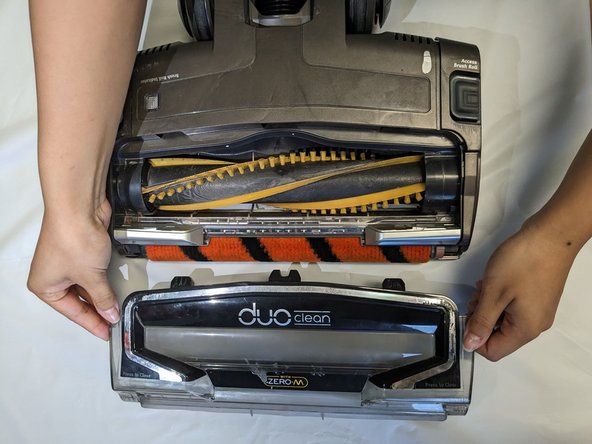

    • Push the wand release and lift wand away.
    • Flip over the floor nozzle (the remaining piece).
    • Clear out any tangled hair, debris, or trash.
    • If necessary scissors may be used to cut it out.

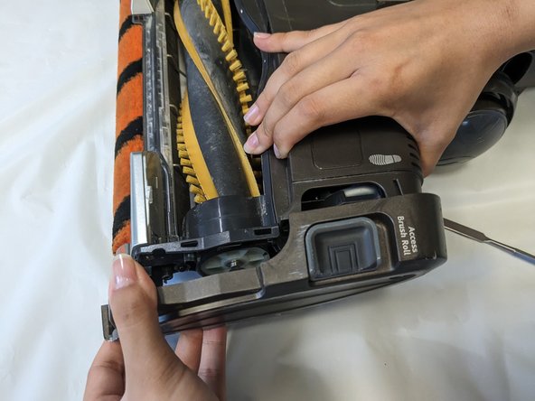

  3. Shark Apex DuoClean Powered Lift-Away AZ1002 Brush Roll Replacement: crwdns2935265:03crwdnd2935265:01crwdnd2935265:02crwdne2935265:0 Shark Apex DuoClean Powered Lift-Away AZ1002 Brush Roll Replacement: crwdns2935265:03crwdnd2935265:02crwdnd2935265:02crwdne2935265:0
    • Pull the release buttons on each side of the floor nozzle to pop off the garage door.

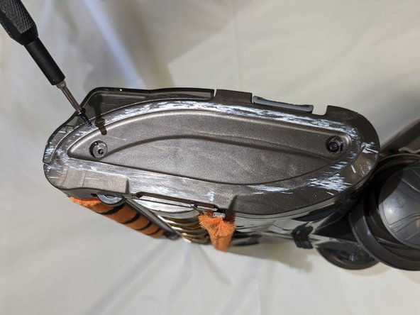

  4. Shark Apex DuoClean Powered Lift-Away AZ1002 Brush Roll Replacement: crwdns2935265:04crwdnd2935265:01crwdnd2935265:02crwdne2935265:0 Shark Apex DuoClean Powered Lift-Away AZ1002 Brush Roll Replacement: crwdns2935265:04crwdnd2935265:02crwdnd2935265:02crwdne2935265:0

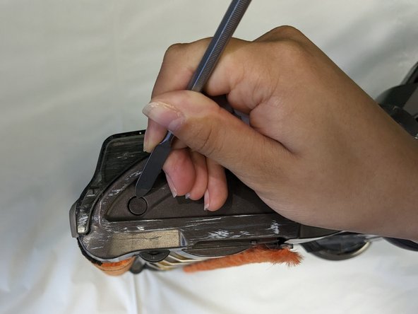

    • Turn the floor nozzle on its side where the large wheels are on your right.
    • Use a spudger to remove the two plastic covers to reveal the screws beneath.
  5. Shark Apex DuoClean Powered Lift-Away AZ1002 Brush Roll Replacement: crwdns2935265:05crwdnd2935265:01crwdnd2935265:02crwdne2935265:0 Shark Apex DuoClean Powered Lift-Away AZ1002 Brush Roll Replacement: crwdns2935265:05crwdnd2935265:02crwdnd2935265:02crwdne2935265:0
    • Remove the two Torx screws.
  6. Shark Apex DuoClean Powered Lift-Away AZ1002 Brush Roll Replacement: crwdns2935265:06crwdnd2935265:01crwdnd2935265:02crwdne2935265:0 Shark Apex DuoClean Powered Lift-Away AZ1002 Brush Roll Replacement: crwdns2935265:06crwdnd2935265:02crwdnd2935265:02crwdne2935265:0
    • Use a spudger to pop off the side cover.
    • You may have to use force and pull.

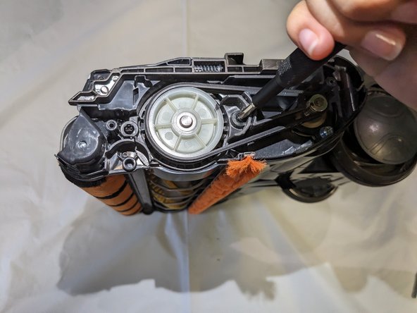

  7. Shark Apex DuoClean Powered Lift-Away AZ1002 Brush Roll Replacement: crwdns2935265:07crwdnd2935265:01crwdnd2935265:02crwdne2935265:0 Shark Apex DuoClean Powered Lift-Away AZ1002 Brush Roll Replacement: crwdns2935265:07crwdnd2935265:02crwdnd2935265:02crwdne2935265:0
    • Remove the two Phillips screws on either side of the brush roll.

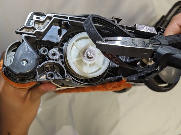

  8. Shark Apex DuoClean Powered Lift-Away AZ1002 Brush Roll Replacement: crwdns2935265:08crwdnd2935265:01crwdnd2935265:03crwdne2935265:0 Shark Apex DuoClean Powered Lift-Away AZ1002 Brush Roll Replacement: crwdns2935265:08crwdnd2935265:02crwdnd2935265:03crwdne2935265:0 Shark Apex DuoClean Powered Lift-Away AZ1002 Brush Roll Replacement: crwdns2935265:08crwdnd2935265:03crwdnd2935265:03crwdne2935265:0

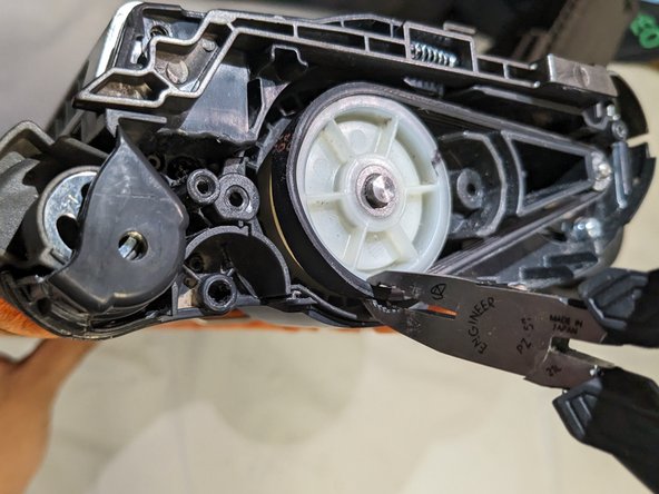

    • Use pliers to grab the belt just below the wheel.
    • Pull in a circular motion around the wheel until the belt comes loose and you are able to remove it.

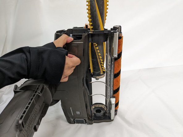

    • Push the brush roll up so it pops out of its slot.
    • Grab the end of the brush roll and pull it completely out.

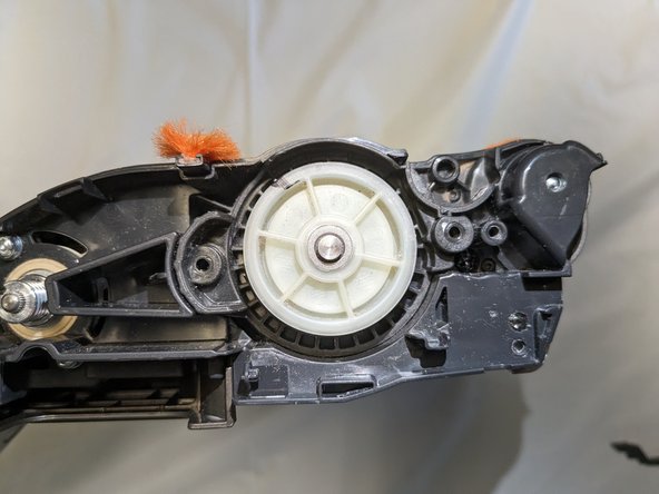

  10. Shark Apex DuoClean Powered Lift-Away AZ1002 Brush Roll Replacement: crwdns2935265:010crwdnd2935265:01crwdnd2935265:02crwdne2935265:0 Shark Apex DuoClean Powered Lift-Away AZ1002 Brush Roll Replacement: crwdns2935265:010crwdnd2935265:02crwdnd2935265:02crwdne2935265:0
    • Insert new brush roll until it clicks in place.
    • Be sure to align the brush roll end before pushing it fully in, so that it looks like the second photo. This will allow it to click into place.
