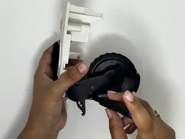

    • Put the device with the wheel side up.
    • Remove the five 11 mm screws surrounding the drive wheel using a Torx TR15 screwdriver.
    • Gently pull the wheel assembly out.
    • Make sure to pull lightly on the wheel assembly to ensure wires do not rip apart.

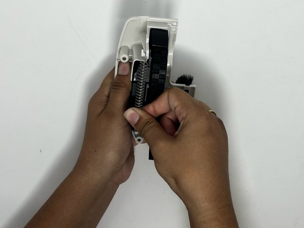

    • Remove the spring from the wheel assembly.

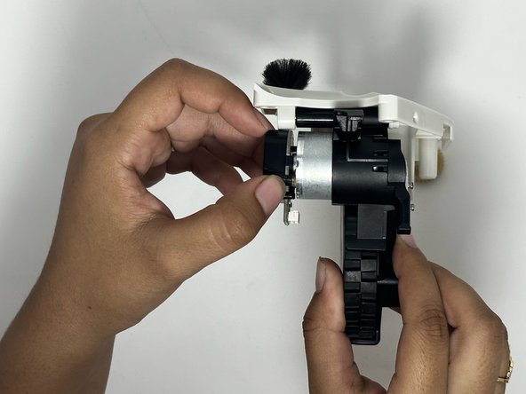

    • Remove the four 7 mm screws around the gearbox using a Torx TR8 screwdriver.
    • Remove the gearbox cover.
    • Be careful about handling the wheel assembly with the gearbox exposed. Debris can enter in and the gears may fall out.

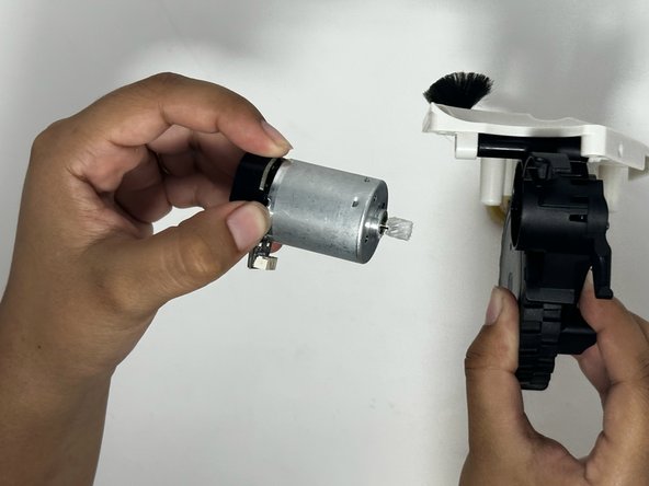

    • If holding the motor vertical, it may fall out once the screws are removed.
    • Using the Phillips #0 screwdriver, remove the two 4mm screws holding the motor to the gearbox.
    • Remove the motor.
