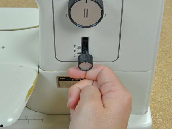

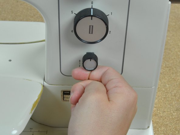

      • Align the edge of the fabric with the edge of the presser foot, then depress the presser foot.
      • Engage the sewing machine's backstitch function.
      • Backstitch functions vary widely between machines and can come in the form of buttons, levers, and knobs. See your sewing machine manual for instructions on your backstitch function.
      • Depress the pedal slowly. Sew two or three stitches backwards. Release the pedal and disengage the backstitch function.

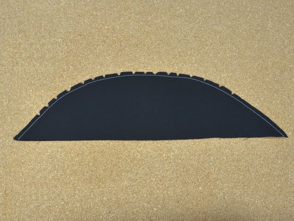

      • Lay out the newly sewn fabric on your work surface.

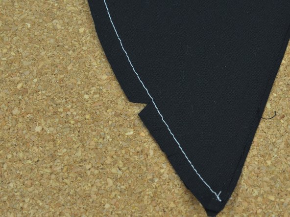

      • With a pair of fabric scissors, make a series of cuts about 1 cm apart into the raw edge of the seam until the fabric begins to curve. This will ensure that the seam lays flat.
      • Do not cut the seam itself, or you will have to resew the section.
    7. Sewing a Curved Seam: crwdns2935265:07crwdnd2935265:01crwdnd2935265:03crwdne2935265:0 Sewing a Curved Seam: crwdns2935265:07crwdnd2935265:02crwdnd2935265:03crwdne2935265:0 Sewing a Curved Seam: crwdns2935265:07crwdnd2935265:03crwdnd2935265:03crwdne2935265:0
      • Once the edge of the fabric begins to curve, begin cutting small triangles about every inch along the edge with the point facing towards the seam.
      • The more triangles you cut, the smoother your seam will lay.
      • Continue cutting small triangles along the length of the fabric.
      • As with the beginning, you may simply cut slits into the straight sections, while curved edges require triangles.
    8. Sewing a Curved Seam: crwdns2935265:08crwdnd2935265:01crwdnd2935265:02crwdne2935265:0 Sewing a Curved Seam: crwdns2935265:08crwdnd2935265:02crwdnd2935265:02crwdne2935265:0
      • Once you have cut triangles all along the seam, turn the fabric inside out so that the seam is now on the inside.
      • As you turn the fabric inside out, adjust the fabric at the raw edge of the seam to get the smoothest seam possible.
      • Once your fabric is inside-out and your seam is flat, stand back and admire your beautiful handiwork.
