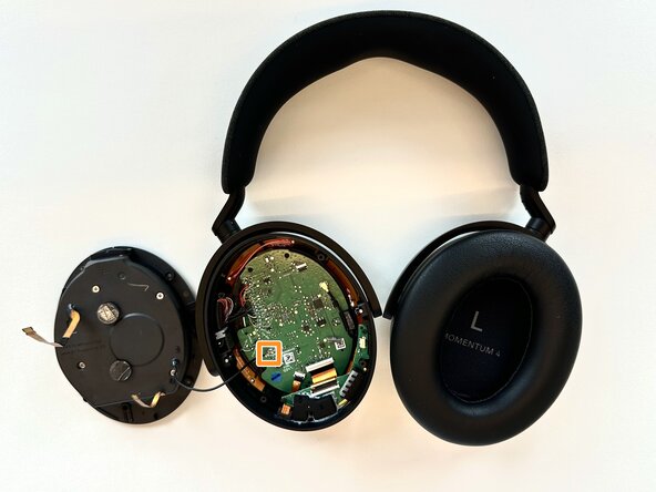

    • On the right ear piece, insert an opening tool into the gap between the ear pad and the driver housing.
    • Gently pry the ear pad away from the driver housing until the ear pad fully releases.
    • Remove the right ear pad.
  2. Sennheiser Momentum 4 Right Driver Assembly Replacement: crwdns2935265:02crwdnd2935265:01crwdnd2935265:01crwdne2935265:0
    • Use a Phillips #00 screwdriver to remove four 6.5mm screws that secure the right driver housing.
  3. Sennheiser Momentum 4 Right Driver Assembly Replacement: crwdns2935265:03crwdnd2935265:01crwdnd2935265:01crwdne2935265:0
    • Insert a spudger into the seam between the driver housing and chassis.
    • Gently pry the driver housing up and out of the chassis, with care not to strain the connected cables.
  4. Sennheiser Momentum 4 Right Driver Assembly Replacement: crwdns2935265:04crwdnd2935265:01crwdnd2935265:02crwdne2935265:0 Sennheiser Momentum 4 Right Driver Assembly Replacement: crwdns2935265:04crwdnd2935265:02crwdnd2935265:02crwdne2935265:0
    • Flip up the two black ZIF locking flaps that secure the two bronze ribbon cables attached to the driver assembly.
    • Disconnect the two ribbon cables and set the driver assembly to the side of the chassis.
    • Desolder the two speaker cable motherboard connections.
    • Remove the driver assembly.
