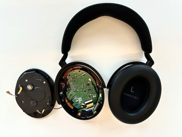

    • On the right ear piece, insert an opening tool into the gap between the ear pad and the driver housing.
    • Gently pry the ear pad away from the driver housing until the ear pad fully releases.
    • Remove the right ear pad.
  2. Sennheiser Momentum 4 I/O Board Replacement: crwdns2935265:02crwdnd2935265:01crwdnd2935265:01crwdne2935265:0
    • Use a Phillips #00 screwdriver to remove four 6.5mm screws that secure the right driver housing.
  3. Sennheiser Momentum 4 I/O Board Replacement: crwdns2935265:03crwdnd2935265:01crwdnd2935265:01crwdne2935265:0
    • Insert a spudger into the seam between the driver housing and chassis.
    • Gently pry the driver housing up and out of the chassis, with care not to strain the connected cables.
  4. Sennheiser Momentum 4 I/O Board Replacement: crwdns2935265:04crwdnd2935265:01crwdnd2935265:02crwdne2935265:0 Sennheiser Momentum 4 I/O Board Replacement: crwdns2935265:04crwdnd2935265:02crwdnd2935265:02crwdne2935265:0
    • Flip up the three black ZIF locking flaps that secure the three bronze ribbon cables.
    • Disconnect all three ribbon cables.

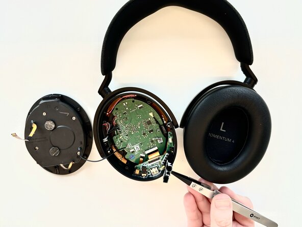

  5. Sennheiser Momentum 4 I/O Board Replacement: crwdns2935265:05crwdnd2935265:01crwdnd2935265:02crwdne2935265:0 Sennheiser Momentum 4 I/O Board Replacement: crwdns2935265:05crwdnd2935265:02crwdnd2935265:02crwdne2935265:0
    • Use tweezers to remove the plastic covering surrounding the audio jack and charging port.
  6. Sennheiser Momentum 4 I/O Board Replacement: crwdns2935265:06crwdnd2935265:01crwdnd2935265:01crwdne2935265:0
    • Break the adhesive securing the rubber audio jack/power housing.
  7. Sennheiser Momentum 4 I/O Board Replacement: crwdns2935265:07crwdnd2935265:01crwdnd2935265:02crwdne2935265:0 Sennheiser Momentum 4 I/O Board Replacement: crwdns2935265:07crwdnd2935265:02crwdnd2935265:02crwdne2935265:0

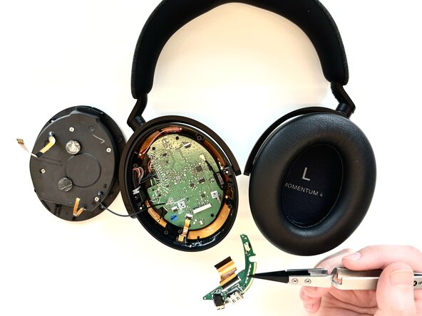

    • Use a Phillips #00 screwdriver to remove the two black 1.4 mm screws that secure the I/O board.
    • Lift the I/O board up and out.
