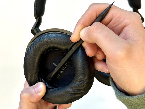

    • Insert a spudger into the seam between the left ear pad and driver assembly.
    • Gently pry around the perimeter of the ear pad until it fully releases.
    • Remove the left ear pad.
    • Repeat for the right ear pad if necessary.

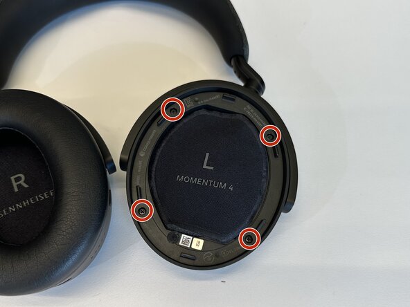

    • Use a Phillips #00 screwdriver to remove the four 6.5 mm screws that secure the left driver housing.

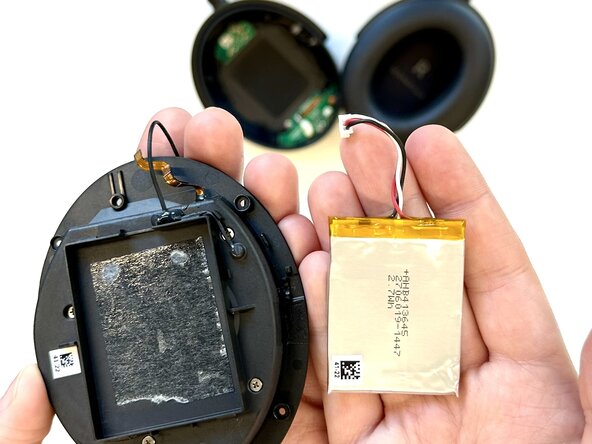

    • Insert the flat end of a spudger between the lower edge of the battery and the battery housing.
    • Do not bend, warp, or puncture the battery.
    • Gently lift the battery upward to release the adhesive that secures the battery.
    • If necessary, use a hairdryer to lightly heat the battery to loosen the adhesive.
    • Remove the battery.
For optimal performance, after completing this guide, calibrate your newly installed battery.
