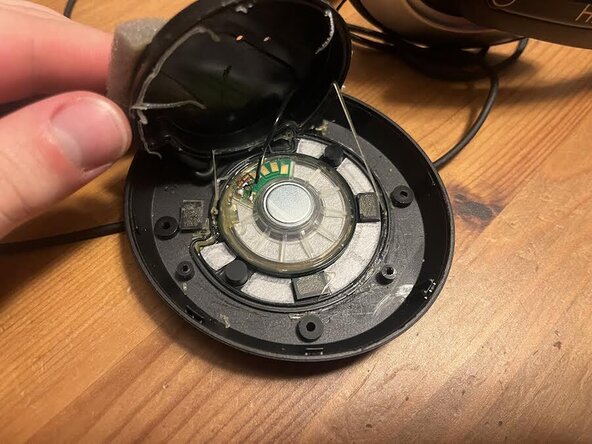

      • With your hands, carefully remove the ear cushions from the Sennheiser HD205 by pulling them away from the headphone earcup.
    1. Sennheiser HD205 Drivers Replacement, Drivers: crwdns2935265:02crwdnd2935265:01crwdnd2935265:03crwdne2935265:0 Sennheiser HD205 Drivers Replacement, Drivers: crwdns2935265:02crwdnd2935265:02crwdnd2935265:03crwdne2935265:0 Sennheiser HD205 Drivers Replacement, Drivers: crwdns2935265:02crwdnd2935265:03crwdnd2935265:03crwdne2935265:0
      • Using the 00-size screw bit, Remove the four screws and plastic cover from headphones. Flip over plastic cover to find the back of the drivers.
    2. Sennheiser HD205 Drivers Replacement: crwdns2935265:03crwdnd2935265:01crwdnd2935265:02crwdne2935265:0 Sennheiser HD205 Drivers Replacement: crwdns2935265:03crwdnd2935265:02crwdnd2935265:02crwdne2935265:0
      • Use hair dyer to soften glue, pry protective cover up
      • Replace drivers
To reassemble your device, follow these instructions in reverse order. Take your e-waste to an R2 or e-Stewards certified recycler.
