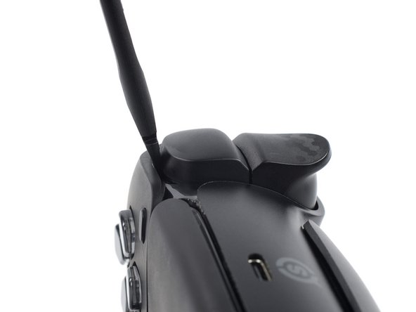

  1. Scuf Reflex L1 and R1 Bumper Replacement, Pry up the R1 bumper: crwdns2935265:01crwdnd2935265:01crwdnd2935265:03crwdne2935265:0 Scuf Reflex L1 and R1 Bumper Replacement, Pry up the R1 bumper: crwdns2935265:01crwdnd2935265:02crwdnd2935265:03crwdne2935265:0 Scuf Reflex L1 and R1 Bumper Replacement, Pry up the R1 bumper: crwdns2935265:01crwdnd2935265:03crwdnd2935265:03crwdne2935265:0
    • Before starting repairs, turn off your device and unplug any cables.
    • Insert the flat end of a spudger between the faceplate and the R1 bumper.
    • Pry up with the spudger to release the clips securing the bumper.

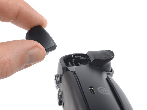

  2. Scuf Reflex L1 and R1 Bumper Replacement, Remove the R1 bumper: crwdns2935265:02crwdnd2935265:01crwdnd2935265:02crwdne2935265:0 Scuf Reflex L1 and R1 Bumper Replacement, Remove the R1 bumper: crwdns2935265:02crwdnd2935265:02crwdnd2935265:02crwdne2935265:0
    • Remove the R1 bumper.

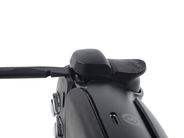

  3. Scuf Reflex L1 and R1 Bumper Replacement, Pry up the L1 bumper: crwdns2935265:03crwdnd2935265:01crwdnd2935265:03crwdne2935265:0 Scuf Reflex L1 and R1 Bumper Replacement, Pry up the L1 bumper: crwdns2935265:03crwdnd2935265:02crwdnd2935265:03crwdne2935265:0 Scuf Reflex L1 and R1 Bumper Replacement, Pry up the L1 bumper: crwdns2935265:03crwdnd2935265:03crwdnd2935265:03crwdne2935265:0
    • Insert the flat end of a spudger between the faceplate and the L1 bumper.
  4. Scuf Reflex L1 and R1 Bumper Replacement, Remove the L1 bumper: crwdns2935265:04crwdnd2935265:01crwdnd2935265:02crwdne2935265:0 Scuf Reflex L1 and R1 Bumper Replacement, Remove the L1 bumper: crwdns2935265:04crwdnd2935265:02crwdnd2935265:02crwdne2935265:0
    • Remove the L1 bumper.
    • To reinstall the bumpers, place them in their original position and firmly push them into place.
