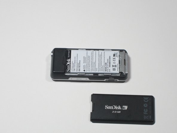

    • To remove the back cover, slide the back cover toward the top of the device with your thumb.

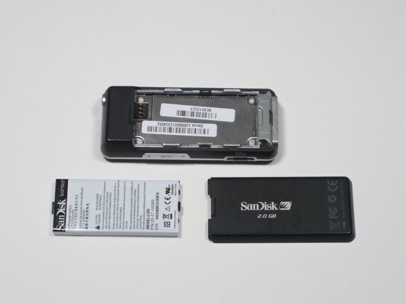

  2. SanDisk Sansa C250 Rear Case Cover Replacement, Battery: crwdns2935265:02crwdnd2935265:01crwdnd2935265:01crwdne2935265:0
    • Wedge the plastic pry tool under the edge of the battery.
  3. SanDisk Sansa C250 Rear Case Cover Replacement: crwdns2935265:03crwdnd2935265:01crwdnd2935265:02crwdne2935265:0 SanDisk Sansa C250 Rear Case Cover Replacement: crwdns2935265:03crwdnd2935265:02crwdnd2935265:02crwdne2935265:0
    • With the plastic pry tool, gently lift up. The battery should lift up and out.
  4. SanDisk Sansa C250 Rear Case Cover Replacement, Rear Case Cover: crwdns2935265:04crwdnd2935265:01crwdnd2935265:01crwdne2935265:0
    • Using a Phillips head screwdriver, remove the two black .265" screws at the base of the device.

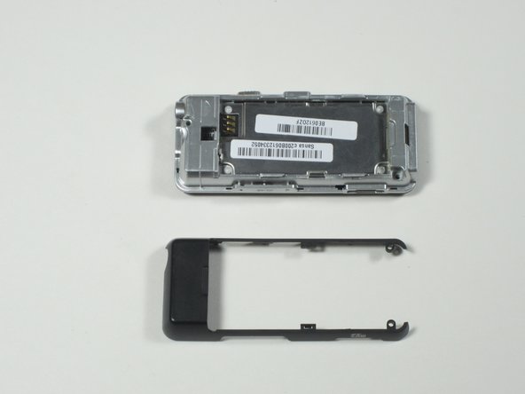

  5. SanDisk Sansa C250 Rear Case Cover Replacement: crwdns2935265:05crwdnd2935265:01crwdnd2935265:02crwdne2935265:0 SanDisk Sansa C250 Rear Case Cover Replacement: crwdns2935265:05crwdnd2935265:02crwdnd2935265:02crwdne2935265:0
    • Near the middle of the device, locate the two plastic arms of the case cover.
    • Using the plastic pry tool, pry up the two arms of the case to free them from the sides.
  6. SanDisk Sansa C250 Rear Case Cover Replacement: crwdns2935265:06crwdnd2935265:01crwdnd2935265:02crwdne2935265:0 SanDisk Sansa C250 Rear Case Cover Replacement: crwdns2935265:06crwdnd2935265:02crwdnd2935265:02crwdne2935265:0
    • To remove the rear case cover, slide the rear case cover toward the top of the device with your thumb to release it.
