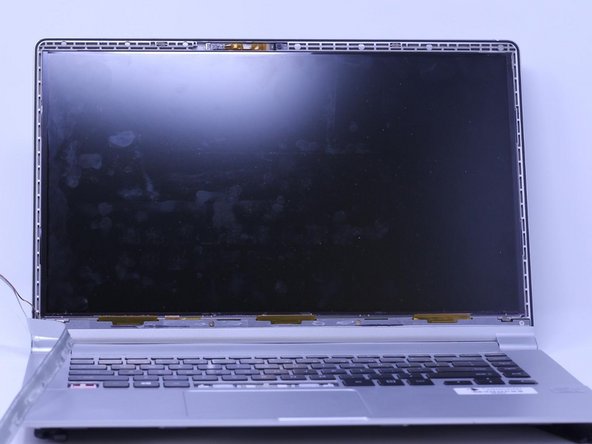

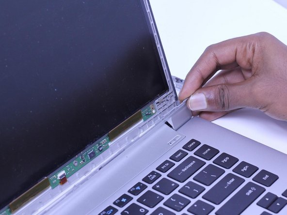

  4. Samsung Series 9 NP900X4D-A03US Display Replacement, Display: crwdns2935265:04crwdnd2935265:01crwdnd2935265:02crwdne2935265:0 Samsung Series 9 NP900X4D-A03US Display Replacement, Display: crwdns2935265:04crwdnd2935265:02crwdnd2935265:02crwdne2935265:0
    • Using tweezers, gently remove the adhesive surrounding the cover. At the same time, gently pry the cover off of the display using an iFixit opening tool.
    • Gently place the cover to the left, as a wire is still attached.

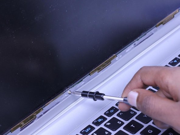

  5. Samsung Series 9 NP900X4D-A03US Display Replacement: crwdns2935265:05crwdnd2935265:01crwdnd2935265:03crwdne2935265:0 Samsung Series 9 NP900X4D-A03US Display Replacement: crwdns2935265:05crwdnd2935265:02crwdnd2935265:03crwdne2935265:0 Samsung Series 9 NP900X4D-A03US Display Replacement: crwdns2935265:05crwdnd2935265:03crwdnd2935265:03crwdne2935265:0
    • Use the Phillips #00 screwdriver to unscrew the four 2.5mm screws.
    • Gently remove the tabs from each corner.

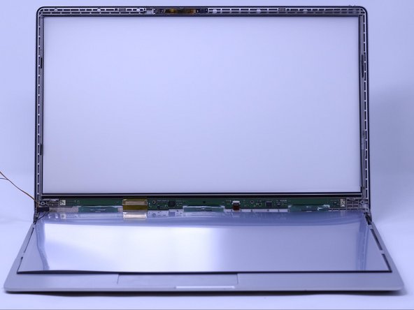

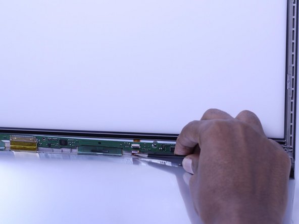

  6. Samsung Series 9 NP900X4D-A03US Display Replacement: crwdns2935265:06crwdnd2935265:01crwdnd2935265:02crwdne2935265:0 Samsung Series 9 NP900X4D-A03US Display Replacement: crwdns2935265:06crwdnd2935265:02crwdnd2935265:02crwdne2935265:0
    • Use the iFixit opening tool to detach the screen from the frame.
    • Slowly lay the screen down on the keyboard.
    • Be careful not to lift or tug on the display since a wire is still connected.

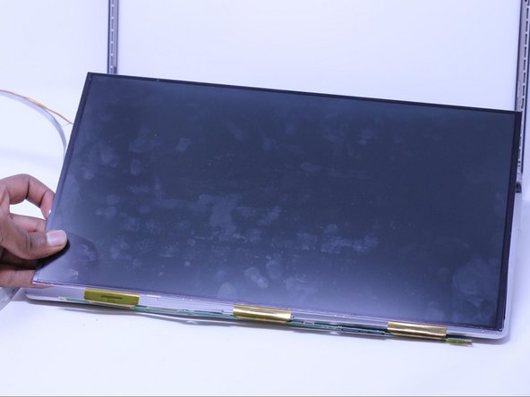

  7. Samsung Series 9 NP900X4D-A03US Display Replacement: crwdns2935265:07crwdnd2935265:01crwdnd2935265:03crwdne2935265:0 Samsung Series 9 NP900X4D-A03US Display Replacement: crwdns2935265:07crwdnd2935265:02crwdnd2935265:03crwdne2935265:0 Samsung Series 9 NP900X4D-A03US Display Replacement: crwdns2935265:07crwdnd2935265:03crwdnd2935265:03crwdne2935265:0
    • Using tweezers, slowly remove the connected wire from the display.
    • Gently remove the display from the device.
