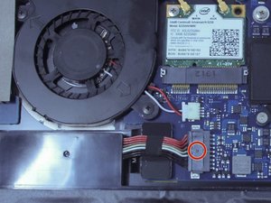

Lightly place some pressure into the highlighted cavity on the battery's outlet plug with a spudger.
Carefully remove the wires from the outlet plug.
Now you will be able to remove the battery from its place.
