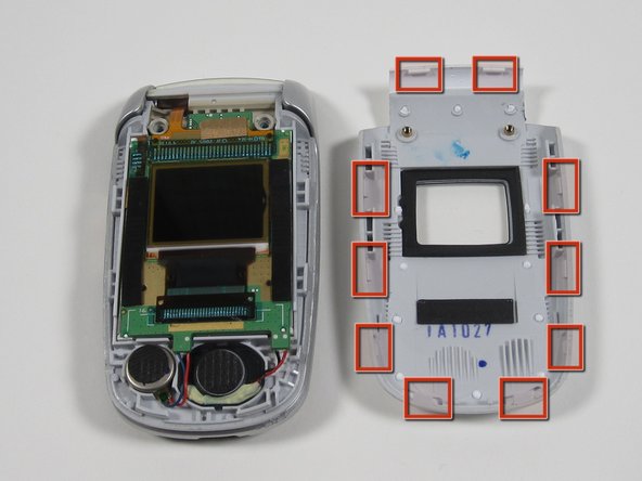

    • As shown above, with a plastic pry tool, begin working at the top corner and down each side. The face plate has 10 tabs that hook into the phone's body.
    • Before removing the 2 tabs on the bottom, the 3 tabs on either side must be free first.
    • Note: The bottom 2 are the most challenging to remove.
    • Note: When reassembling start with the bottom two tabs.

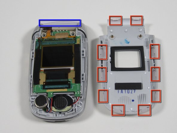

  4. Samsung SGH-X495 Face Plate Replacement: crwdns2935265:04crwdnd2935265:01crwdnd2935265:02crwdne2935265:0 Samsung SGH-X495 Face Plate Replacement: crwdns2935265:04crwdnd2935265:02crwdnd2935265:02crwdne2935265:0
    • Continue down each side toward the bottom with your pry tool.
    • Note: It may help to use multiple pry tools to help hold it open.
    • Second photo: location of the tabs.
  5. Samsung SGH-X495 Face Plate Replacement: crwdns2935265:05crwdnd2935265:01crwdnd2935265:02crwdne2935265:0 Samsung SGH-X495 Face Plate Replacement: crwdns2935265:05crwdnd2935265:02crwdnd2935265:02crwdne2935265:0
    • With 8 tabs released, the face plate is nearly free.
    • With the phone in your left hand, gently wiggle the face plate from side to side and push the face place upward.
    • Note: A strip of double sided tape holds the faceplate, so expect some resistance
