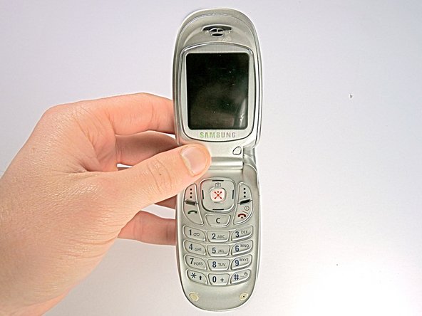

Samsung SGH-E317 Camera Replacement
  1. Samsung SGH-E317 Camera Replacement, Battery: crwdns2935265:01crwdnd2935265:01crwdnd2935265:01crwdne2935265:0
    • Remove the back panel by pressing up on switch, located at the top on the back of the phone.
    • You may want to use a plastic opening tool to help pry the back panel off.
  2. Samsung SGH-E317 Camera Replacement, Motherboard: crwdns2935265:02crwdnd2935265:01crwdnd2935265:01crwdne2935265:0
    • Unscrew the four 4.5mm screws located on the back plate.

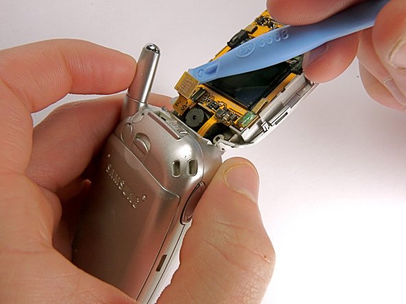

  12. Samsung SGH-E317 Camera Replacement: crwdns2935265:012crwdnd2935265:01crwdnd2935265:01crwdne2935265:0
    • Wedge the plastic opening tool under the crevice on the inner surface of the phone screen.
    • Gently pry the top panel off around the entire frame.
  13. Samsung SGH-E317 Camera Replacement: crwdns2935265:013crwdnd2935265:01crwdnd2935265:02crwdne2935265:0 Samsung SGH-E317 Camera Replacement: crwdns2935265:013crwdnd2935265:02crwdnd2935265:02crwdne2935265:0
    • Make sure that the top panel is completely separated from the LCD display around the entire perimeter.

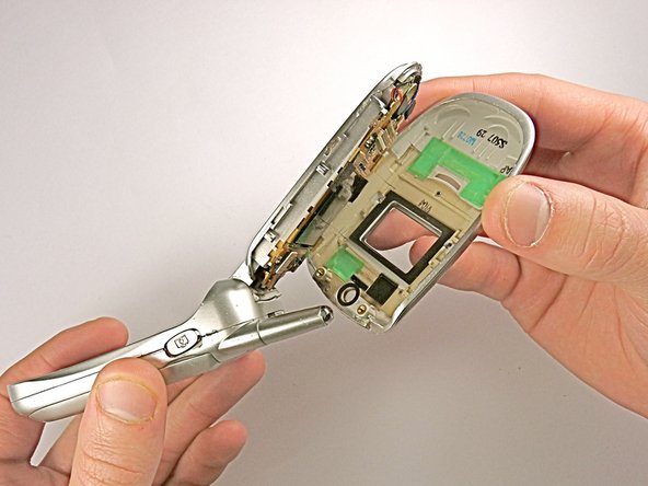

  14. Samsung SGH-E317 Camera Replacement: crwdns2935265:014crwdnd2935265:01crwdnd2935265:01crwdne2935265:0
    • Take the top panel off of the phone.
  15. Samsung SGH-E317 Camera Replacement: crwdns2935265:015crwdnd2935265:01crwdnd2935265:02crwdne2935265:0 Samsung SGH-E317 Camera Replacement: crwdns2935265:015crwdnd2935265:02crwdnd2935265:02crwdne2935265:0
    • Use the wedge to detach the connecting wire panel from the LCD display system.
    • Be gentle when detatching this wire to prevent damaging surrounding components.

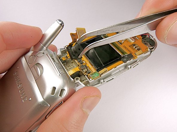

  16. Samsung SGH-E317 Camera Replacement: crwdns2935265:016crwdnd2935265:01crwdnd2935265:02crwdne2935265:0 Samsung SGH-E317 Camera Replacement: crwdns2935265:016crwdnd2935265:02crwdnd2935265:02crwdne2935265:0
    • Use the tweezers to remove the camera from the cellphone casing.
To reassemble your device, follow these instructions in reverse order.Take your e-waste to an R2 or e-Stewards certified recycler.
