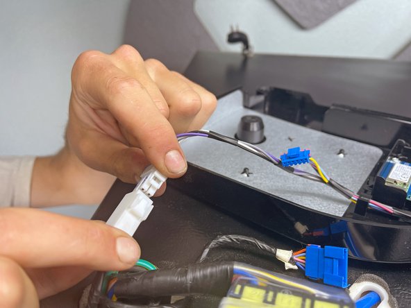

    • Use your fingers to release the wire connectors under the hinge cover.
    • Disconnect the wiring so you can remove the hinge cover.

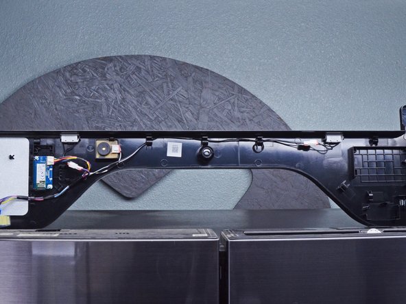

  6. Samsung Refrigerator Door Sensors Replacement, Sensor information: crwdns2935265:06crwdnd2935265:01crwdnd2935265:02crwdne2935265:0 Samsung Refrigerator Door Sensors Replacement, Sensor information: crwdns2935265:06crwdnd2935265:02crwdnd2935265:02crwdne2935265:0
    • The door sensors are located in the hinge cover. In this example, the hinge cover has two door sensors:
    • The left door sensor
    • The left door sensor connector
    • The right door sensor
    • The right door sensor connector
    • Depending on your situation, you may need to replace either or both sensors.

    • Use your fingers to squeeze and disconnect the sensor cable connector.

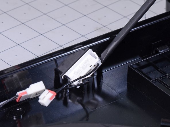

    • Use a spudger or a flathead screwdriver to pry the sensor out of its retaining clips.
  9. Samsung Refrigerator Door Sensors Replacement: crwdns2935265:09crwdnd2935265:01crwdnd2935265:01crwdne2935265:0
    • Remove the door sensor.
