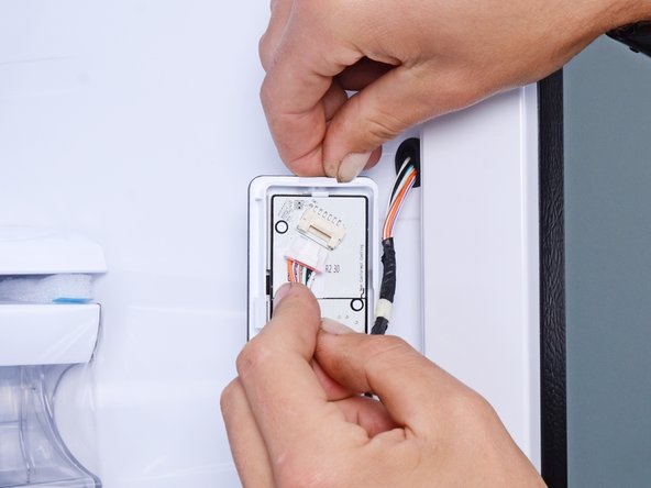

  4. Samsung Refrigerator Control Panel Replacement: crwdns2935265:04crwdnd2935265:01crwdnd2935265:01crwdne2935265:0
    • Flip the control panel over to reveal the cable connector.
  5. Samsung Refrigerator Control Panel Replacement: crwdns2935265:05crwdnd2935265:01crwdnd2935265:02crwdne2935265:0 Samsung Refrigerator Control Panel Replacement: crwdns2935265:05crwdnd2935265:02crwdnd2935265:02crwdne2935265:0
    • Use your fingers to slide the cable connector out of its socket.
  6. Samsung Refrigerator Control Panel Replacement, Remove the control panel: crwdns2935265:06crwdnd2935265:01crwdnd2935265:01crwdne2935265:0
    • Remove the control panel.
