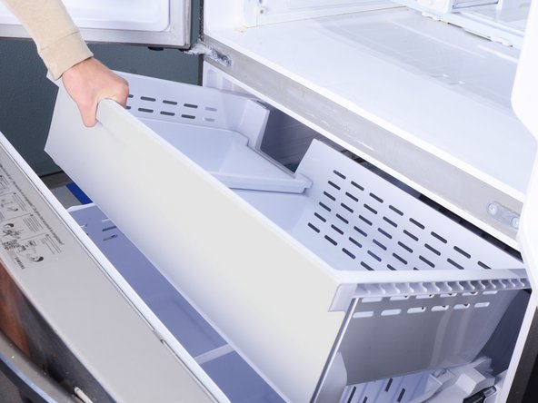

  3. Samsung RF28T5001SR Refrigerator Evaporator Fan Replacement, Remove the freezer bins: crwdns2935265:03crwdnd2935265:01crwdnd2935265:03crwdne2935265:0 Samsung RF28T5001SR Refrigerator Evaporator Fan Replacement, Remove the freezer bins: crwdns2935265:03crwdnd2935265:02crwdnd2935265:03crwdne2935265:0 Samsung RF28T5001SR Refrigerator Evaporator Fan Replacement, Remove the freezer bins: crwdns2935265:03crwdnd2935265:03crwdnd2935265:03crwdne2935265:0
    • Lift and remove all the freezer bins from the drawer.
    • You may need to open the refrigerator doors in order to remove the large bin.

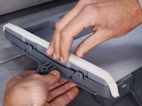

  4. Samsung RF28T5001SR Refrigerator Evaporator Fan Replacement, Remove the freezer door: crwdns2935265:04crwdnd2935265:01crwdnd2935265:03crwdne2935265:0 Samsung RF28T5001SR Refrigerator Evaporator Fan Replacement, Remove the freezer door: crwdns2935265:04crwdnd2935265:02crwdnd2935265:03crwdne2935265:0 Samsung RF28T5001SR Refrigerator Evaporator Fan Replacement, Remove the freezer door: crwdns2935265:04crwdnd2935265:03crwdnd2935265:03crwdne2935265:0
    • A plastic tab locks each drawer rail in place.
    • Use a flathead screwdriver or your fingers to press in the plastic tab near the inner end of the drawer rail.
    • While pressing the plastic tab, grasp the rail with your free hand and slide it towards you slightly to unlock the rail.

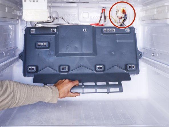

  7. Samsung RF28T5001SR Refrigerator Evaporator Fan Replacement, Remove the evaporator cover: crwdns2935265:07crwdnd2935265:01crwdnd2935265:01crwdne2935265:0
    • Use a Phillips screwdriver to remove the two 18.5 mm‑long screws securing the evaporator cover to the refrigerator.
  8. Samsung RF28T5001SR Refrigerator Evaporator Fan Replacement: crwdns2935265:08crwdnd2935265:01crwdnd2935265:02crwdne2935265:0 Samsung RF28T5001SR Refrigerator Evaporator Fan Replacement: crwdns2935265:08crwdnd2935265:02crwdnd2935265:02crwdne2935265:0
    • Lift the bottom edge of the evaporator cover away from the refrigerator to release the bottom clips.
    • Don't try to fully remove the cover. It's still connected by a few wires.
    • Shift the evaporator cover downwards to access the connectors in the top right corner of the freezer compartment.

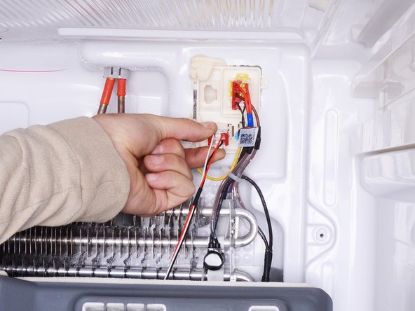

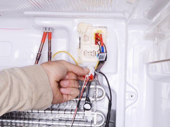

  9. Samsung RF28T5001SR Refrigerator Evaporator Fan Replacement, Disconnect the fan connector: crwdns2935265:09crwdnd2935265:01crwdnd2935265:03crwdne2935265:0 Samsung RF28T5001SR Refrigerator Evaporator Fan Replacement, Disconnect the fan connector: crwdns2935265:09crwdnd2935265:02crwdnd2935265:03crwdne2935265:0 Samsung RF28T5001SR Refrigerator Evaporator Fan Replacement, Disconnect the fan connector: crwdns2935265:09crwdnd2935265:03crwdnd2935265:03crwdne2935265:0
    • Squeeze the bottom edge of the fan connector to unlock it from the freezer wall.
    • Pull and disconnect the fan connector.

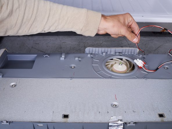

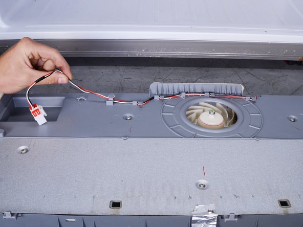

  11. Samsung RF28T5001SR Refrigerator Evaporator Fan Replacement, Loosen the fan cable: crwdns2935265:011crwdnd2935265:01crwdnd2935265:03crwdne2935265:0 Samsung RF28T5001SR Refrigerator Evaporator Fan Replacement, Loosen the fan cable: crwdns2935265:011crwdnd2935265:02crwdnd2935265:03crwdne2935265:0 Samsung RF28T5001SR Refrigerator Evaporator Fan Replacement, Loosen the fan cable: crwdns2935265:011crwdnd2935265:03crwdnd2935265:03crwdne2935265:0
    • Guide the fan cable out of the evaporator cover clips.
    • If you have trouble getting the cable out of the clips, squeeze the clips with pliers to create a wider gap.

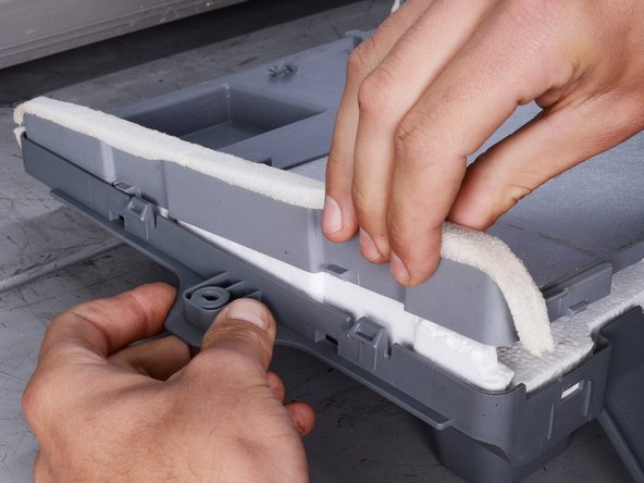

  13. Samsung RF28T5001SR Refrigerator Evaporator Fan Replacement: crwdns2935265:013crwdnd2935265:01crwdnd2935265:03crwdne2935265:0 Samsung RF28T5001SR Refrigerator Evaporator Fan Replacement: crwdns2935265:013crwdnd2935265:02crwdnd2935265:03crwdne2935265:0 Samsung RF28T5001SR Refrigerator Evaporator Fan Replacement: crwdns2935265:013crwdnd2935265:03crwdnd2935265:03crwdne2935265:0
    • Use your fingers to pry and release the clips along the short edge of the evaporator cover.
    • If the perimeter foam insulation prevents you from releasing the clips, cut the foam with scissors.

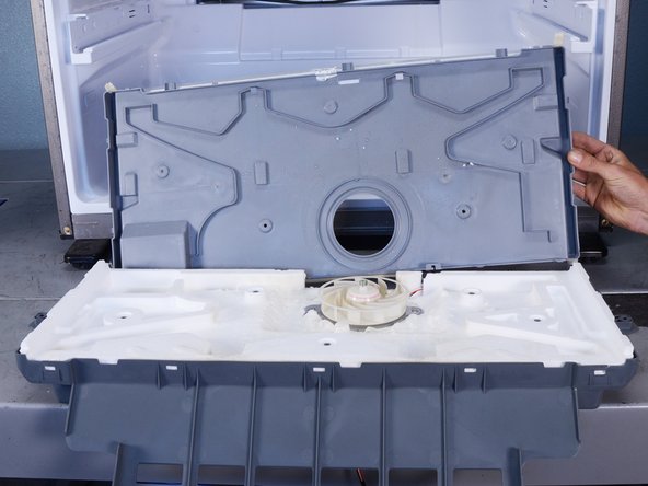

  14. Samsung RF28T5001SR Refrigerator Evaporator Fan Replacement: crwdns2935265:014crwdnd2935265:01crwdnd2935265:03crwdne2935265:0 Samsung RF28T5001SR Refrigerator Evaporator Fan Replacement: crwdns2935265:014crwdnd2935265:02crwdnd2935265:03crwdne2935265:0 Samsung RF28T5001SR Refrigerator Evaporator Fan Replacement: crwdns2935265:014crwdnd2935265:03crwdnd2935265:03crwdne2935265:0
    • Lift and separate the back panel from the evaporator cover.

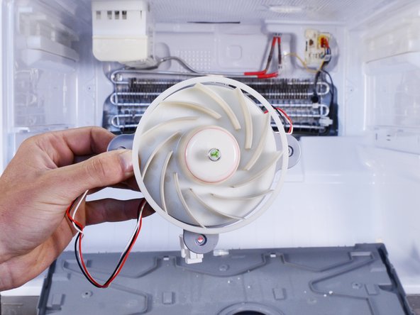

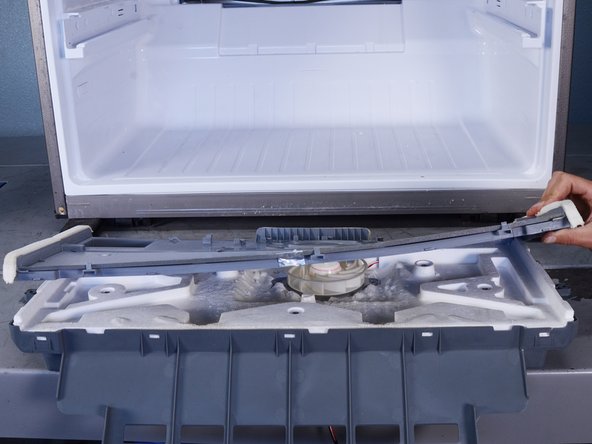

  15. Samsung RF28T5001SR Refrigerator Evaporator Fan Replacement, Remove the evaporator fan: crwdns2935265:015crwdnd2935265:01crwdnd2935265:01crwdne2935265:0
    • Use a Phillips screwdriver to remove the three 14.2 mm‑long screws securing the evaporator fan.
  16. Samsung RF28T5001SR Refrigerator Evaporator Fan Replacement: crwdns2935265:016crwdnd2935265:01crwdnd2935265:02crwdne2935265:0 Samsung RF28T5001SR Refrigerator Evaporator Fan Replacement: crwdns2935265:016crwdnd2935265:02crwdnd2935265:02crwdne2935265:0
    • Lift and remove the evaporator fan.
    • During reassembly, be sure to install the fan in the right orientation: the side with the center label should face down towards the evaporator cover.
