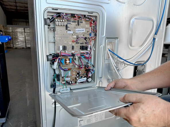

  2. Samsung Older French Door Refrigerator Inverter Board Replacement, Unfasten the control board cover: crwdns2935265:02crwdnd2935265:01crwdnd2935265:01crwdne2935265:0
    • Use a #2 Phillips driver to remove the screws securing the control board cover.
  3. Samsung Older French Door Refrigerator Inverter Board Replacement, Remove the control board cover: crwdns2935265:03crwdnd2935265:01crwdnd2935265:02crwdne2935265:0 Samsung Older French Door Refrigerator Inverter Board Replacement, Remove the control board cover: crwdns2935265:03crwdnd2935265:02crwdnd2935265:02crwdne2935265:0
    • Grasp the cover at the upper edge and tilt the upper edge toward you.
    • Lift the lower edge off of the tabs at the bottom and remove the cover.

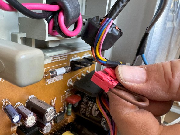

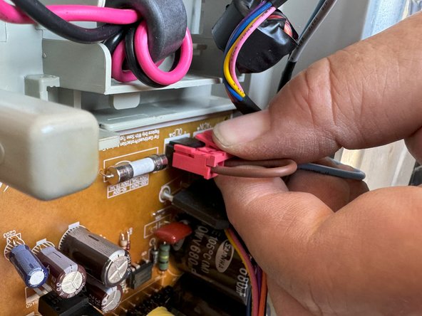

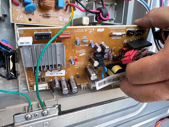

  4. Samsung Older French Door Refrigerator Inverter Board Replacement, Disconnect the inverter board: crwdns2935265:04crwdnd2935265:01crwdnd2935265:01crwdne2935265:0
    • Locate the inverter board connectors in the red rectangles.
  5. Samsung Older French Door Refrigerator Inverter Board Replacement: crwdns2935265:05crwdnd2935265:01crwdnd2935265:03crwdne2935265:0 Samsung Older French Door Refrigerator Inverter Board Replacement: crwdns2935265:05crwdnd2935265:02crwdnd2935265:03crwdne2935265:0 Samsung Older French Door Refrigerator Inverter Board Replacement: crwdns2935265:05crwdnd2935265:03crwdnd2935265:03crwdne2935265:0
    • Disconnect each connector by squeezing the locking tab and pulling it straight out from the board.
    • Repeat this for each of the connectors.
    • One connector is shown as an example.

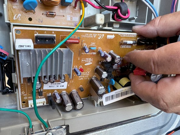

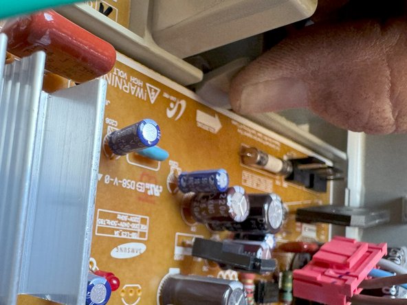

  6. Samsung Older French Door Refrigerator Inverter Board Replacement, Retaining lock tab location: crwdns2935265:06crwdnd2935265:01crwdnd2935265:01crwdne2935265:0
    • Locate the lock tab.
  7. Samsung Older French Door Refrigerator Inverter Board Replacement, Release the inverter board: crwdns2935265:07crwdnd2935265:01crwdnd2935265:03crwdne2935265:0 Samsung Older French Door Refrigerator Inverter Board Replacement, Release the inverter board: crwdns2935265:07crwdnd2935265:02crwdnd2935265:03crwdne2935265:0 Samsung Older French Door Refrigerator Inverter Board Replacement, Release the inverter board: crwdns2935265:07crwdnd2935265:03crwdnd2935265:03crwdne2935265:0
    • Lift the locking tab to release the inverter board.
    • Pull the top edge of the board outward toward you.

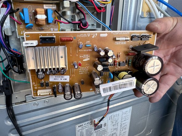

  8. Samsung Older French Door Refrigerator Inverter Board Replacement, Remove the inverter board: crwdns2935265:08crwdnd2935265:01crwdnd2935265:03crwdne2935265:0 Samsung Older French Door Refrigerator Inverter Board Replacement, Remove the inverter board: crwdns2935265:08crwdnd2935265:02crwdnd2935265:03crwdne2935265:0 Samsung Older French Door Refrigerator Inverter Board Replacement, Remove the inverter board: crwdns2935265:08crwdnd2935265:03crwdnd2935265:03crwdne2935265:0
    • Remove the inverter board by pulling the top edge further toward you and lifting the board upward to free it from the lower retaining tabs.
