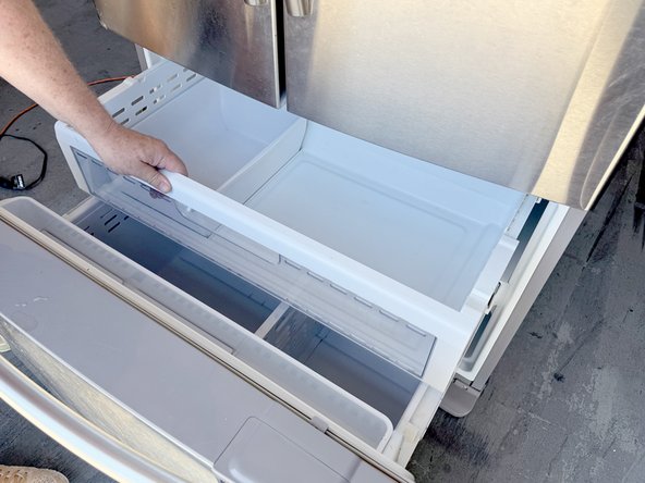

  3. Samsung Older French Door Refrigerator Freezer Drawer Replacement, Remove small drawer basket: crwdns2935265:03crwdnd2935265:01crwdnd2935265:03crwdne2935265:0 Samsung Older French Door Refrigerator Freezer Drawer Replacement, Remove small drawer basket: crwdns2935265:03crwdnd2935265:02crwdnd2935265:03crwdne2935265:0 Samsung Older French Door Refrigerator Freezer Drawer Replacement, Remove small drawer basket: crwdns2935265:03crwdnd2935265:03crwdnd2935265:03crwdne2935265:0
    • Unclip the basket hinge retainer by tilting the rear edge up and remove it from the drawer rail.
    • Release the small drawer basket and lift it up and out.

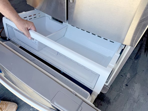

  4. Samsung Older French Door Refrigerator Freezer Drawer Replacement, Remove the drawer basket: crwdns2935265:04crwdnd2935265:01crwdnd2935265:01crwdne2935265:0
    • Lift the drawer basket out of the drawer frame and remove it.

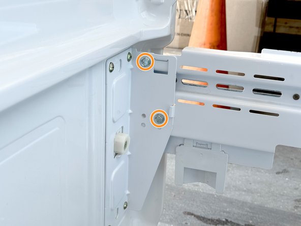

  5. Samsung Older French Door Refrigerator Freezer Drawer Replacement, Unfasten the drawer front: crwdns2935265:05crwdnd2935265:01crwdnd2935265:02crwdne2935265:0 Samsung Older French Door Refrigerator Freezer Drawer Replacement, Unfasten the drawer front: crwdns2935265:05crwdnd2935265:02crwdnd2935265:02crwdne2935265:0
    • Use a 3/8" socket wrench, box wrench, or open end wrench to remove the bolts securing the drawer front to the right drawer slide.
    • Repeat the process for the left drawer slide.

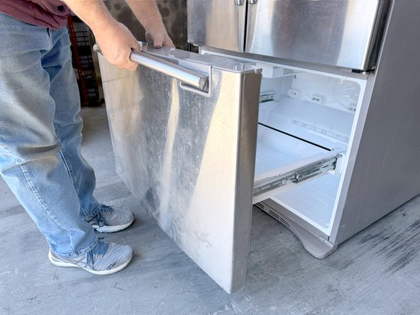

  6. Samsung Older French Door Refrigerator Freezer Drawer Replacement, Remove the drawer front: crwdns2935265:06crwdnd2935265:01crwdnd2935265:03crwdne2935265:0 Samsung Older French Door Refrigerator Freezer Drawer Replacement, Remove the drawer front: crwdns2935265:06crwdnd2935265:02crwdnd2935265:03crwdne2935265:0 Samsung Older French Door Refrigerator Freezer Drawer Replacement, Remove the drawer front: crwdns2935265:06crwdnd2935265:03crwdnd2935265:03crwdne2935265:0
    • Lift the drawer front upwards to free it from the drawer slides.
    • Remove the drawer front.

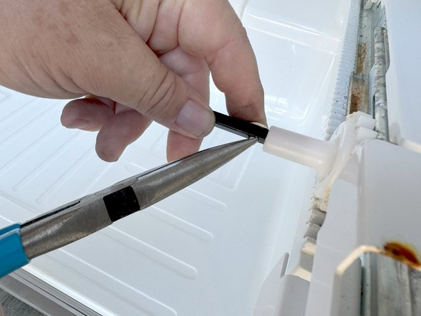

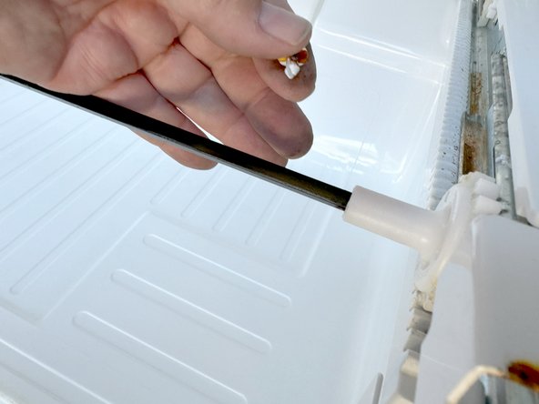

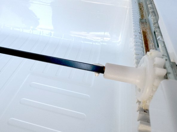

  7. Samsung Older French Door Refrigerator Freezer Drawer Replacement, Release the connector rod retaining pin: crwdns2935265:07crwdnd2935265:01crwdnd2935265:03crwdne2935265:0 Samsung Older French Door Refrigerator Freezer Drawer Replacement, Release the connector rod retaining pin: crwdns2935265:07crwdnd2935265:02crwdnd2935265:03crwdne2935265:0 Samsung Older French Door Refrigerator Freezer Drawer Replacement, Release the connector rod retaining pin: crwdns2935265:07crwdnd2935265:03crwdnd2935265:03crwdne2935265:0
    • Rotate the slide connector rod until you can access the retaining pin.
    • Use a pair of long nose pliers to squeeze the retaining pin shank to release it.

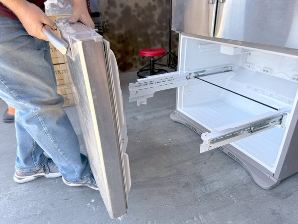

  8. Samsung Older French Door Refrigerator Freezer Drawer Replacement, Remove the drawer slide connecting rod: crwdns2935265:08crwdnd2935265:01crwdnd2935265:02crwdne2935265:0 Samsung Older French Door Refrigerator Freezer Drawer Replacement, Remove the drawer slide connecting rod: crwdns2935265:08crwdnd2935265:02crwdnd2935265:02crwdne2935265:0
    • Pull the retaining pin out of the hole.
    • Slide the connecting rod to the right to free the left end of the rod.
    • Remove the rod by lifting it upward and sliding it back to the left.
