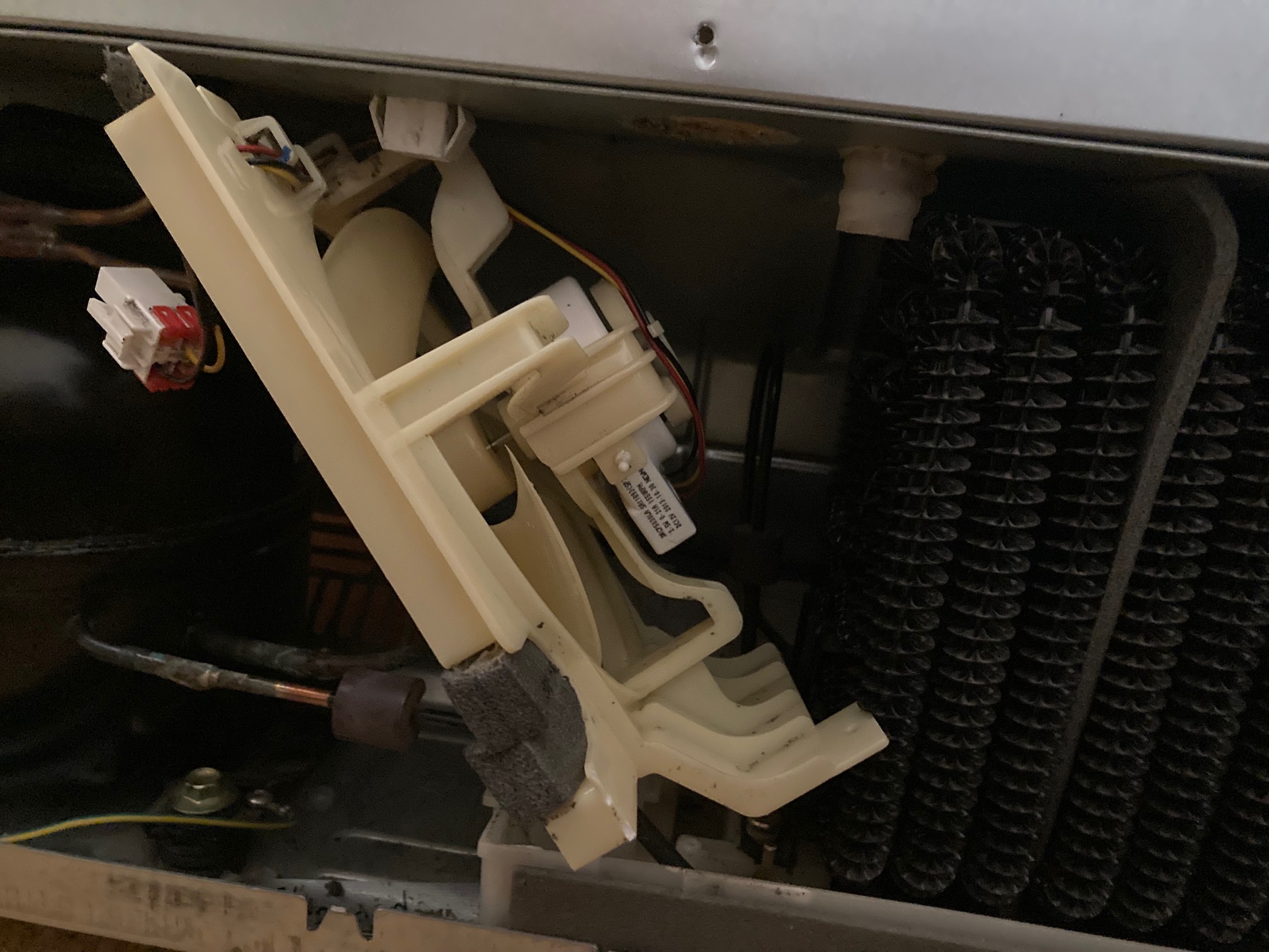

    • Rotate the fan bracket clockwise, as shown by the arrows.
    • There is a refrigerant tube (red box) that passes through the bracket. Do not attempt to free the bracket from the tube just yet.
    • The third photo shows the fan bracket pivoting on the refrigerant tube after it has been rotated as mentioned.
    • By rotating the bracket clockwise first, you will be able to then pivot the assembly out of the machinery compartment.

My Samsung (RS21NASV) was similar with one big and important difference. Look at the bottom of the fan assembly as shown above in this great write-up. It is outside of the drain tray. On mine the tray extends further to the left so that the fan assembly sits in it. The fan assembly has to tilt to the LEFT past the white electrical connector that remains after you unplug the fan. There is a notch in the top of the fan assembly to allow it to pass by the female connector. Tear away part of the gray gasket to reveal it - spent some time before figuring this out! It is a tight squeeze to get it out and puts some stress on the refrigerant tube shown in the red box in Step 7, but it I was able to do it successfully. Thanks Mr. Bill Gilbert! Photo link: Fan Assembly - tilt the top to the LEFT.
