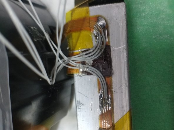

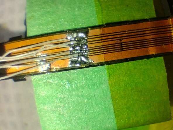

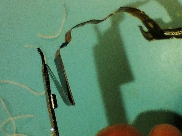

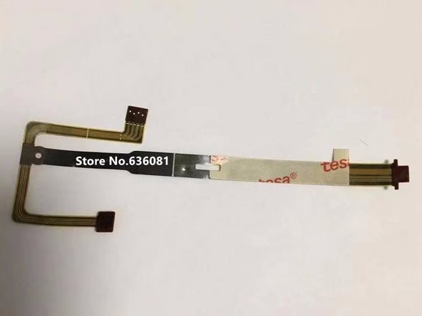

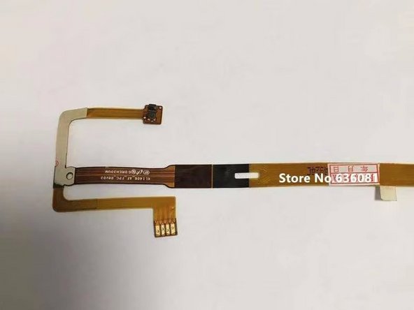

  1. Samsung NX 50-150 f/2.8 S Lens - Focus Cable Repair, Extra Pictures of FPC: crwdns2935265:02crwdnd2935265:01crwdnd2935265:02crwdne2935265:0 Samsung NX 50-150 f/2.8 S Lens - Focus Cable Repair, Extra Pictures of FPC: crwdns2935265:02crwdnd2935265:02crwdnd2935265:02crwdne2935265:0
    • Some pictures of the FPC from when there was still some stock available to buy

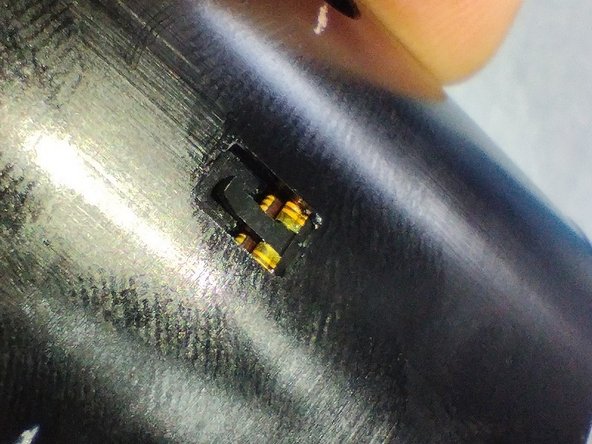

  5. Samsung NX 50-150 f/2.8 S Lens - Focus Cable Repair, Detach Electrical Contact Block: crwdns2935265:06crwdnd2935265:01crwdnd2935265:02crwdne2935265:0 Samsung NX 50-150 f/2.8 S Lens - Focus Cable Repair, Detach Electrical Contact Block: crwdns2935265:06crwdnd2935265:02crwdnd2935265:02crwdne2935265:0
    • Using PH00 Screwdriver remove the two screws holding the contact block.
    • Use a pair of fine tweezers as you undo the screws to prevent them falling inside the lens
    • The contact block will now be loose, but held by its flex pcb.
    • Screws: 2@ M1.4 x 2.5mm wafer head (Black)
    • Bag and label removed parts as you go.

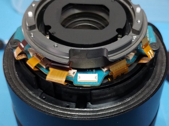

  8. Samsung NX 50-150 f/2.8 S Lens - Focus Cable Repair, Disconnect PCB: crwdns2935265:09crwdnd2935265:01crwdnd2935265:02crwdne2935265:0 Samsung NX 50-150 f/2.8 S Lens - Focus Cable Repair, Disconnect PCB: crwdns2935265:09crwdnd2935265:02crwdnd2935265:02crwdne2935265:0
    • Insert the finest tip flat blade screwdriver between the tab on the ribbon cables and the white connectors, and gently pry the 6 FPCs out.
    • Markings on the contact block FPC are: XL1103_CONTAC_FPCB-PV2-110701, FC1441, 1-18
    • Where FPC are installed contacts down there are two white lines on the FPC reinforcer showing the correct insertion level. One line inside connector and other other just outside.
    • Be Gentle with the FPC ribbons.

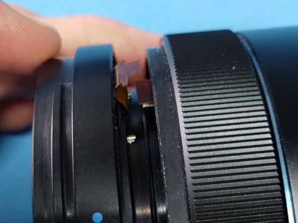

  11. Samsung NX 50-150 f/2.8 S Lens - Focus Cable Repair, Remove Zoom Ring - Outer: crwdns2935265:012crwdnd2935265:01crwdnd2935265:02crwdne2935265:0 Samsung NX 50-150 f/2.8 S Lens - Focus Cable Repair, Remove Zoom Ring - Outer: crwdns2935265:012crwdnd2935265:02crwdnd2935265:02crwdne2935265:0
    • Using a PH0 Screwdriver (you may need to use a PH00 if the shaft is too thick to fit) remove the 3 deeply recessed screws in the zoom ring.
    • When reassembling note the ridges on the zoom ring that fit into slots on the body. This is what transfers the torque from the ring to the body.
    • Screws: 3@ M1.4 x 3.5mm wafer head (black)

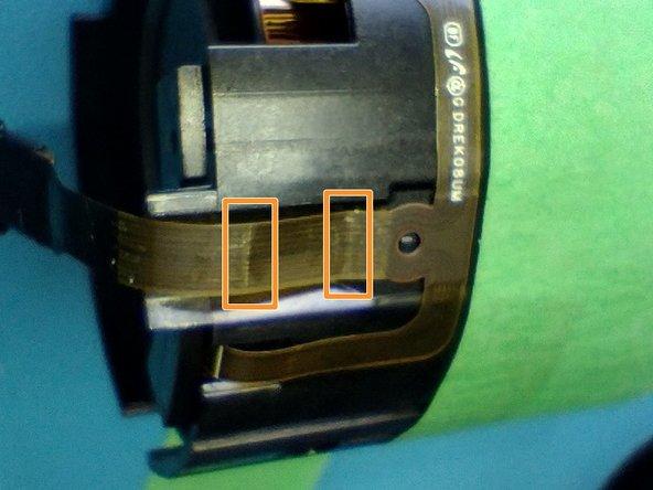

    • On this lens the rubber grip on the zoom ring was loose. Rotate the bodies zoom mechanism to the 50mm position (or 150mm), and then with the slots and ridges lined up, work out the correct position for the rubber grip by rotating it against the body. It appears to have been originally glued, but it can be repaired with some thin double sided tape.
    • Note that this lens has been apart once before. There was black tape securing the FPC ribbons which has been replaced with kapton (polyamide) tape.
    • The FPC Ribbons are double sided taped to the body
    • Note how the wide FPC ribbon that goes inside the metal body has been folded and taped together.

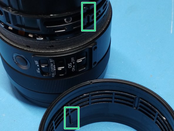

  15. Samsung NX 50-150 f/2.8 S Lens - Focus Cable Repair, iFn Sleeve removal: crwdns2935265:017crwdnd2935265:01crwdnd2935265:03crwdne2935265:0 Samsung NX 50-150 f/2.8 S Lens - Focus Cable Repair, iFn Sleeve removal: crwdns2935265:017crwdnd2935265:02crwdnd2935265:03crwdne2935265:0 Samsung NX 50-150 f/2.8 S Lens - Focus Cable Repair, iFn Sleeve removal: crwdns2935265:017crwdnd2935265:03crwdnd2935265:03crwdne2935265:0
    • Using a PH0 Screwdriver remove the 3 silver screws holding the iFn sleeve onto the body. Do not separate yet.
    • Do NOT separate the two parts yet
    • Note the plastic shims that will come apart with this. The black one is inner (towards the front of the lens), and the clear one outer (towards camera).
    • Lie the lens on its side, and gently and gradually pull the front of the lens away from the body exposing a FPC Ribbon cable. Disconnect the cable from the connector and then finish separating the parts.
    • Screws: 3@ M1.4 x 4mm Wafer head (thread lock)
    • FPC Ribbon: XL1406_MF_PI_FPC_Rev04
    • This shows the iFn ring and ribbon cables.
    • Note the quadrature encoders for the iFn ring.
    • The XL1406_MF_PI_FPC_Rev04 cable has the quadrature encoders, and also runs to the connector at the front which connects to the internal focus motor and presumably sensors.
    • The XL1406 Switch FPC Rev04 connects to the iFn button and selector switches.

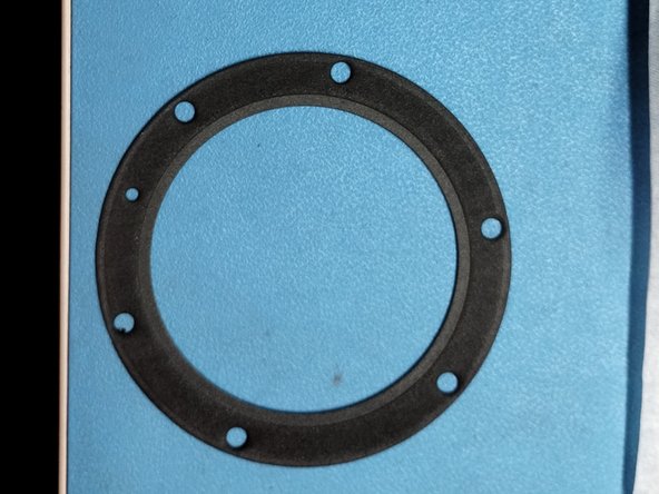

  17. Samsung NX 50-150 f/2.8 S Lens - Focus Cable Repair, Remove Front Lens seal: crwdns2935265:021crwdnd2935265:01crwdnd2935265:02crwdne2935265:0 Samsung NX 50-150 f/2.8 S Lens - Focus Cable Repair, Remove Front Lens seal: crwdns2935265:021crwdnd2935265:02crwdnd2935265:02crwdne2935265:0
    • Use PH00 Screwdriver to remove the six screws holding the the seal cap.
    • Lift the plastic ring, and the foam seal underneath.
    • Note the foam gasket has a hole for a locating pin on the plastic ring.
    • Screw Size: 6@ M1.4 x 4.5mm with threadlock

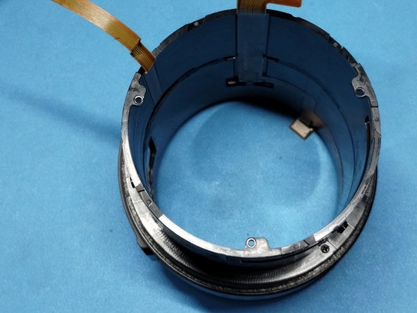

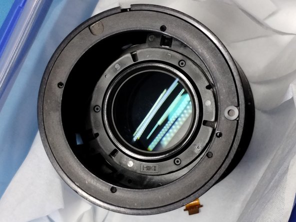

    • At this point we are left with the inner interlocking barrels.
    • The cover for the focus mechanism FPCB is also visible

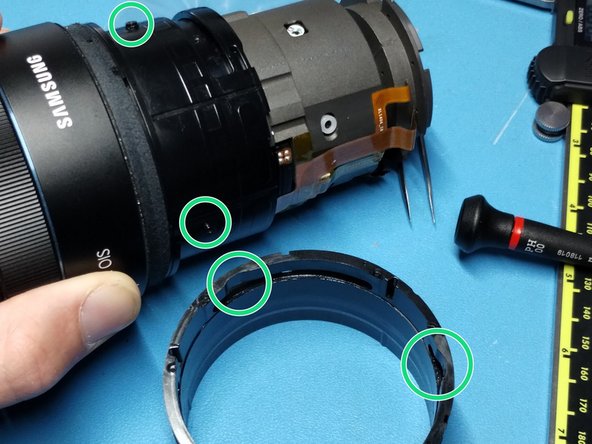

  20. Samsung NX 50-150 f/2.8 S Lens - Focus Cable Repair, Remove Barrel Lip: crwdns2935265:025crwdnd2935265:01crwdnd2935265:02crwdne2935265:0 Samsung NX 50-150 f/2.8 S Lens - Focus Cable Repair, Remove Barrel Lip: crwdns2935265:025crwdnd2935265:02crwdnd2935265:02crwdne2935265:0
    • The rear end of the barrel assembly has a metal cap
    • Using PH00 Screwdriver remove the 4 screws
    • Screws: 4@ M1.4 x 3mm wafer head
    • Use a flat blade screwdriver to carefully lift the cap at multiple points around the circumference. It is a tight fit.
    • Be careful when removing it, as there is a plastic spacer underneath.
    • There appears to be places for two spacers, but only one was fitted in this lens.

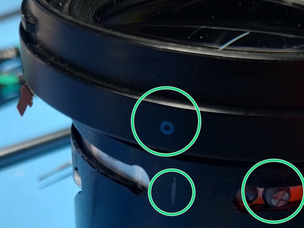

  21. Samsung NX 50-150 f/2.8 S Lens - Focus Cable Repair, Remove outer barrel: crwdns2935265:026crwdnd2935265:01crwdnd2935265:03crwdne2935265:0 Samsung NX 50-150 f/2.8 S Lens - Focus Cable Repair, Remove outer barrel: crwdns2935265:026crwdnd2935265:02crwdnd2935265:03crwdne2935265:0 Samsung NX 50-150 f/2.8 S Lens - Focus Cable Repair, Remove outer barrel: crwdns2935265:026crwdnd2935265:03crwdnd2935265:03crwdne2935265:0

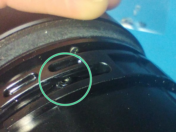

    • Using a flat blade screwdriver remove the three special screws in the straight guides at the front of the lens.
    • Using a PH0 Screwdriver remove the 6 screws and spacers holding the two groups of lenses in place.
    • Do not loosen the screws with blue varnish inside white spacers. I'm guessing these are to align the lens elements.
    • The outer barrel can now be removed.
    • Remember to mark how things are aligned.

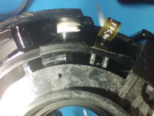

  22. Samsung NX 50-150 f/2.8 S Lens - Focus Cable Repair, Remove Focus Group: crwdns2935265:027crwdnd2935265:01crwdnd2935265:02crwdne2935265:0 Samsung NX 50-150 f/2.8 S Lens - Focus Cable Repair, Remove Focus Group: crwdns2935265:027crwdnd2935265:02crwdnd2935265:02crwdne2935265:0
    • Remove the two screws holding the focus cable guard
    • Screws: 2@ M1.4 x 3mm
    • On the outside of the barrel you will see a small slot and a prong. This is the bottom end of the cable retainer.
    • Move the cable retainer inwards, there is a small amount of glue at the bottom that will separate.
    • The Focus group can now be removed

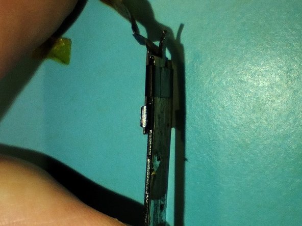

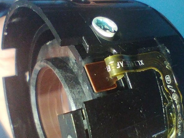

  23. Samsung NX 50-150 f/2.8 S Lens - Focus Cable Repair, Review: crwdns2935265:028crwdnd2935265:01crwdnd2935265:03crwdne2935265:0 Samsung NX 50-150 f/2.8 S Lens - Focus Cable Repair, Review: crwdns2935265:028crwdnd2935265:02crwdnd2935265:03crwdne2935265:0 Samsung NX 50-150 f/2.8 S Lens - Focus Cable Repair, Review: crwdns2935265:028crwdnd2935265:03crwdnd2935265:03crwdne2935265:0
    • Some pictures of the focus element
    • Note the varnish / thread-lock on the screws inside the special white spacers. This is aligning the lenses.
    • The white spacers will be eccentric, so as they are rotated through 360 degrees (note the torx shaped inner wall), the lens will lift up or down, and then can be locked in place with the screw.
    • disassembling and reassembling this section will require marking each spacer exactly so that it can be put back in precisely the correct location.
    • Note the optical proximity sensor which is detecting the inner mechanisms endpoint (towards the motor).

    • Inspecting the flex-pcb shows the likely fault. Over time the flex-pcb has developed a weak spot, which then becomes the point that flexes the most, causing it to weaken even further.
    • Flexing the cable shows that this spot is bending at a sharp angle.
    • Note how the main ribbon splits into two, one side going to the motor and the other to a sensor. The narrower ribbons could also have a fault as they also flex (orange), but in this lens the fault occurred during flexing of the main ribbon (changing zoom as the barrel elements move), not as focus changed. I will only be repairing the main ribbon.

    • As there are two weak spots (orange boxes) in the cable, the repair needs to run from before the first to after the second.
  26. Samsung NX 50-150 f/2.8 S Lens - Focus Cable Repair, Initial Failed Repair Technique: crwdns2935265:031crwdnd2935265:01crwdnd2935265:03crwdne2935265:0 Samsung NX 50-150 f/2.8 S Lens - Focus Cable Repair, Initial Failed Repair Technique: crwdns2935265:031crwdnd2935265:02crwdnd2935265:03crwdne2935265:0 Samsung NX 50-150 f/2.8 S Lens - Focus Cable Repair, Initial Failed Repair Technique: crwdns2935265:031crwdnd2935265:03crwdnd2935265:03crwdne2935265:0
    • This is what I did after locating the faults on this particular lens.
    • Use masking tape to hold things in place while you work on them. I also cut some pieces of rigid foam to hold things in position. I recommend mounting this on a board that you can rotate for soldering at convenient angles. Cover the lenses (I used pieces of ziplock bag taped across) to avoid flux splash or dust while working.
    • Use a scalpel to scrape away some of the epoxy coating, being careful not to cut the copper traces.
    • Use some 34AWG stranded wire to replace the damaged section to flex PCB.
    • Use a multimeter to check the best you can, as you don't want to have to disassemble it again after testing.
    • Clean with flux remover on cotton swabs. Followed by IPA. Insulate with kapton/polyamide tape. Use double sided tape to reattach cables where they need to go.
    • Soldering the ribbon was very difficult. The traces were ~0.1 - 0.2mm wide. Stagger the soldering positions to help avoid shorts. At this stage I'm giving this repair job a 20% chance of success. If this doesn't work I will manufacturing a new flex ribbon - although I fitting to the motor will be challenging without removing the calibration screws.
  27. Samsung NX 50-150 f/2.8 S Lens - Focus Cable Repair, Focus group extra pictures: crwdns2935265:032crwdnd2935265:01crwdnd2935265:03crwdne2935265:0 Samsung NX 50-150 f/2.8 S Lens - Focus Cable Repair, Focus group extra pictures: crwdns2935265:032crwdnd2935265:02crwdnd2935265:03crwdne2935265:0 Samsung NX 50-150 f/2.8 S Lens - Focus Cable Repair, Focus group extra pictures: crwdns2935265:032crwdnd2935265:03crwdnd2935265:03crwdne2935265:0
    • Some extra pictures of the focus mechanism.
  28. Samsung NX 50-150 f/2.8 S Lens - Focus Cable Repair, Manufacture new Flex PCB: crwdns2935265:033crwdnd2935265:01crwdnd2935265:02crwdne2935265:0 Samsung NX 50-150 f/2.8 S Lens - Focus Cable Repair, Manufacture new Flex PCB: crwdns2935265:033crwdnd2935265:02crwdnd2935265:02crwdne2935265:0
    • After the initial failed repair attempt using thin wire, a Flex PCB was designed to splice into the stubs of the original flex PCB going to the motor and sensor.
    • JLCPCB.com was used to make the cables, but other suppliers could be used. The second picture shows the manufacturing details.
    • See https://github.com/mostlyhorses/XL1406_A... for the PCB gerber files
    • You will want at least 3 cables so you have something to practice on.
  29. Samsung NX 50-150 f/2.8 S Lens - Focus Cable Repair, Disassemble Flex PCB Holder: crwdns2935265:034crwdnd2935265:01crwdnd2935265:03crwdne2935265:0 Samsung NX 50-150 f/2.8 S Lens - Focus Cable Repair, Disassemble Flex PCB Holder: crwdns2935265:034crwdnd2935265:02crwdnd2935265:03crwdne2935265:0 Samsung NX 50-150 f/2.8 S Lens - Focus Cable Repair, Disassemble Flex PCB Holder: crwdns2935265:034crwdnd2935265:03crwdnd2935265:03crwdne2935265:0
    • Cut the original flex PCB from the focus mechanism (red lines in first picture), leaving a tail from the motor and sensor for splicing onto replacement cable.
    • Notice how the flex PCB is adhered and folded into the metal carrier, including how the tape has been placed.
  30. Samsung NX 50-150 f/2.8 S Lens - Focus Cable Repair, Splice in replacement FPCB: crwdns2935265:035crwdnd2935265:01crwdnd2935265:03crwdne2935265:0 Samsung NX 50-150 f/2.8 S Lens - Focus Cable Repair, Splice in replacement FPCB: crwdns2935265:035crwdnd2935265:02crwdnd2935265:03crwdne2935265:0 Samsung NX 50-150 f/2.8 S Lens - Focus Cable Repair, Splice in replacement FPCB: crwdns2935265:035crwdnd2935265:03crwdnd2935265:03crwdne2935265:0
    • Scrape the coverlay off the original flex pcb so that it can be soldered to. Be careful not to damage the traces as you don't have much to work with.
    • Join the new flex pcb to the stubs. This was more difficult than I hoped, as the solder would not bridge across the 0.07mm height difference reliably. The technique I used was
    • Use the double sided tape to attach the stub to the long tail of the splice PCB.
    • Use a much cooler soldering iron than usual, so that the solder can be 'moulded' as you push it around with the iron tip. If you get the right temperature it will be much easier.
    • Bridge the outer traces and the guard sections of PCB so you can use a large blob of solder here, which will bridge the gap between the two PCBs. Note how I've cut a piece out of the guard section so it doesn't join the motor and sensor.
    • On the inner traces use a fine strand of wire to join the sections.
    • Insulate the soldering with polyamide tape and reattach it to the body using double sided tape.
    • Check with a multimeter that the traces are connected and not shorting. Note that Pins 5 and 7 are one motor winding, and pins 6 and 8 the other, so they will measure as connected, but as they have a trace between them you can tell it's intentional and not a soldering short.
    • Use the Helimax-XP grease to lubricate the barrels and other rotating parts. I didn't apply enough, but I don't want to open the lens again to add more.
    • When re-installing screws into plastic, gently turn them backwards (anti-clockwise) until you feel the thread engage before tightening them clockwise.
    • Don't overtighten the screws
