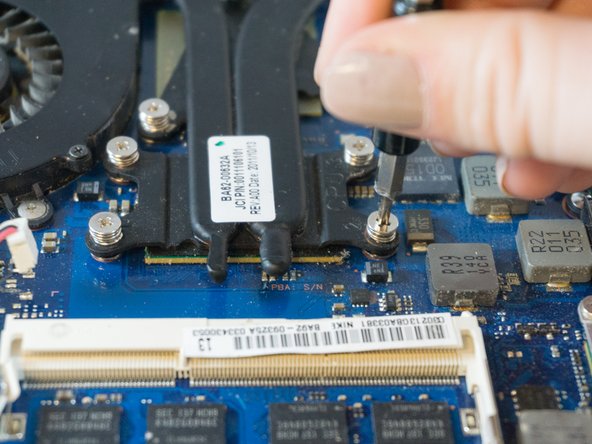

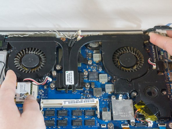

    1. Samsung NP700Z5AH Fan Replacement, Fan: crwdns2935265:07crwdnd2935265:01crwdnd2935265:02crwdne2935265:0 Samsung NP700Z5AH Fan Replacement, Fan: crwdns2935265:07crwdnd2935265:02crwdnd2935265:02crwdne2935265:0
      • Loosen but don't remove the 7 silver Phillips #00 3.5mm screws securing the fan to the motherboard. They should detach from the motherboard and remain attached to the fan assembly.

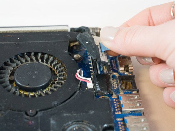

    2. Samsung NP700Z5AH Fan Replacement: crwdns2935265:08crwdnd2935265:01crwdnd2935265:02crwdne2935265:0 Samsung NP700Z5AH Fan Replacement: crwdns2935265:08crwdnd2935265:02crwdnd2935265:02crwdne2935265:0
      • Using your fingers, grasp the blue ribbon on the fan connector and pull straight up to disconnect it from the motherboard.
      • To reinstall the cable, hold it near the end and push it straight into the connector, being careful not to kink the cable.

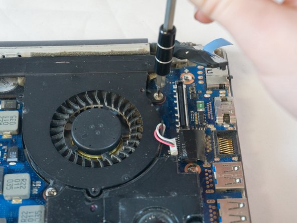

    3. Samsung NP700Z5AH Fan Replacement: crwdns2935265:09crwdnd2935265:01crwdnd2935265:02crwdne2935265:0 Samsung NP700Z5AH Fan Replacement: crwdns2935265:09crwdnd2935265:02crwdnd2935265:02crwdne2935265:0
      • Using the Phillips#00 remove the four 3.5mm screws securing the fan to the motherboard.

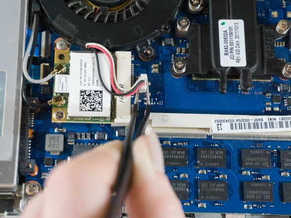

    4. Samsung NP700Z5AH Fan Replacement: crwdns2935265:010crwdnd2935265:01crwdnd2935265:02crwdne2935265:0 Samsung NP700Z5AH Fan Replacement: crwdns2935265:010crwdnd2935265:02crwdnd2935265:02crwdne2935265:0
      • Using tweezers, carefully pull up on the four power cable connectors to disconnect them from the motherboard.
      • These connections were originally soldered and will need a small drop of solder to be re-attached. Use this guide to learn How To Solder and Desolder Connections

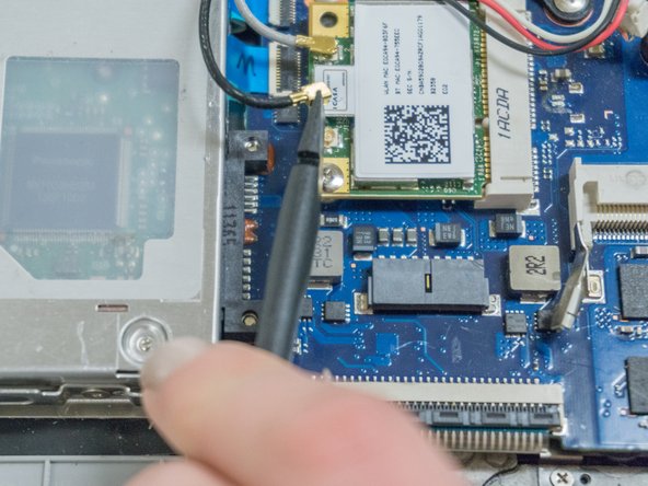

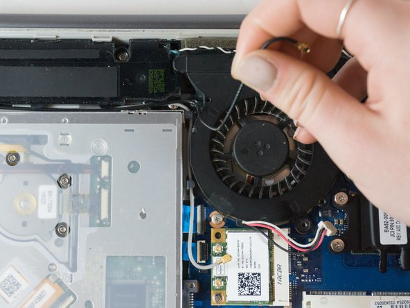

    5. Samsung NP700Z5AH Fan Replacement: crwdns2935265:011crwdnd2935265:01crwdnd2935265:03crwdne2935265:0 Samsung NP700Z5AH Fan Replacement: crwdns2935265:011crwdnd2935265:02crwdnd2935265:03crwdne2935265:0 Samsung NP700Z5AH Fan Replacement: crwdns2935265:011crwdnd2935265:03crwdnd2935265:03crwdne2935265:0
      • Place the tip of the spudger under the metal caps of the black and grey coaxial connectors and pry upwards to disconnect them.
      • After they are disconnected, un-thread them from around the fan.
      • To reinstall, hold the connectors in place and gently press them straight down. The connectors “snap” into their sockets much like the metal snaps on a jacket.

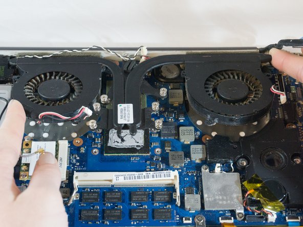

    6. Samsung NP700Z5AH Fan Replacement: crwdns2935265:012crwdnd2935265:01crwdnd2935265:03crwdne2935265:0 Samsung NP700Z5AH Fan Replacement: crwdns2935265:012crwdnd2935265:02crwdnd2935265:03crwdne2935265:0 Samsung NP700Z5AH Fan Replacement: crwdns2935265:012crwdnd2935265:03crwdnd2935265:03crwdne2935265:0
      • Wedge your fingers under opposite corners of the fan and lift to remove it.
