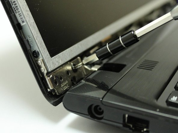

    • Locate the six (6) 2.39 mm screws on the display bracket.
    • Remove the four (4) screws on the left and right sides of the display bracket located near the base of the display with the Philips #0 screwdriver.
    • Remove the two (2) screws on the left and right sides of the display bracket located near the top of the display with the Phillips #0 screwdriver.

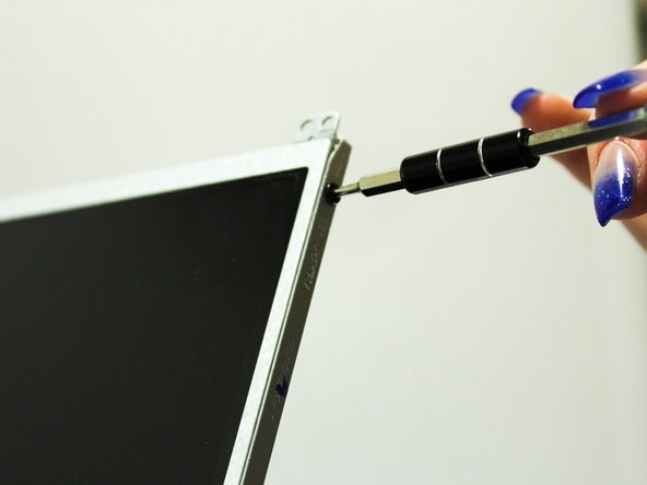

    • Locate the six (6) 1.85 mm screws on the left and right brackets holding the display in place.
    • Remove the screws on each side of the bracket, alternating sides when removing each screw with the Philips #0 screwdriver.

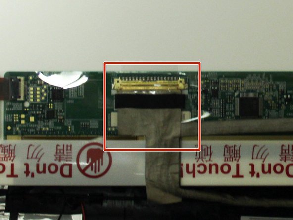

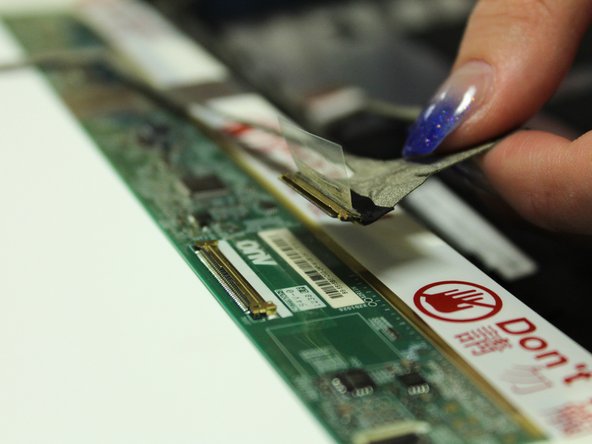

    • Locate the display connector on the back of the display.
    • Carefully remove the tape on the display connector.
    • Remove the display connector by unplugging it from its outlet.

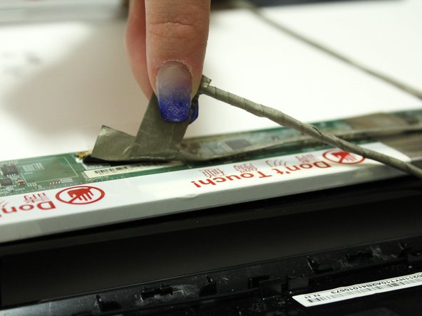

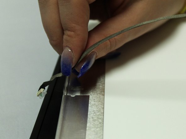

  11. Samsung NP36535C-S05US Display Screen Replacement: crwdns2935265:011crwdnd2935265:01crwdnd2935265:03crwdne2935265:0 Samsung NP36535C-S05US Display Screen Replacement: crwdns2935265:011crwdnd2935265:02crwdnd2935265:03crwdne2935265:0 Samsung NP36535C-S05US Display Screen Replacement: crwdns2935265:011crwdnd2935265:03crwdnd2935265:03crwdne2935265:0
    • Locate and remove the tape from the back of the display in the two (2) sections marked on the supporting image.
  12. Samsung NP36535C-S05US Display Screen Replacement: crwdns2935265:012crwdnd2935265:01crwdnd2935265:01crwdne2935265:0
    • You have successfully removed the display screen.
