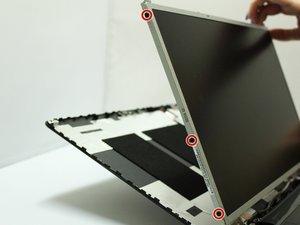

Locate the six (6) 1.85 mm screws on the left and right brackets holding the display in place.
Remove the screws on each side of the bracket, alternating sides when removing each screw with the Philips #0 screwdriver.
