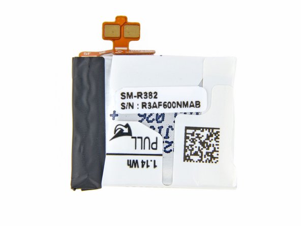

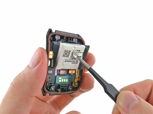

    • First off, let's take a peek at the Gear Live's battery.
    • We use a spudger to pry the lightly-adhered battery contact pad from its roost in the rear cover, and then use some sweet tweezers to pull the powerhouse out of the rear panel.
    • The battery inscription says "1.14 Wh." According to mathemagics and a 300 mAh battery, we conclude this watch runs on a fairly standard 3.8 V design.

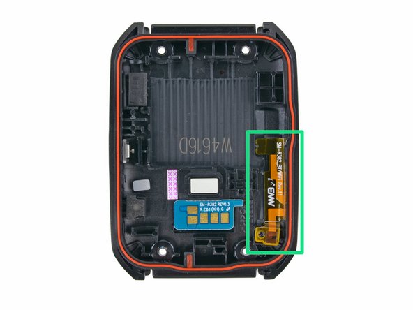

    • Next goes the power button ribbon cable. It was holding on like a champ for a while, but eventually our tweezers overtook it.

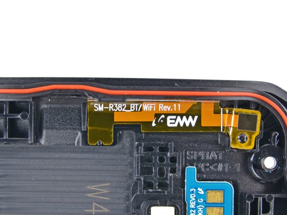

    • Hey, what's this? A Bluetooth / Wi-Fi antenna? This thing isn't supposed to have Wi-Fi! We don't know if Samsung is hiding anything for the future, but we are quite adept at reading cable inscriptions.
    • Also notable is the liquid damage indicator. So although this device is "IP67 water resistant," we don't necessarily recommend going into a pool with it.

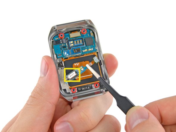

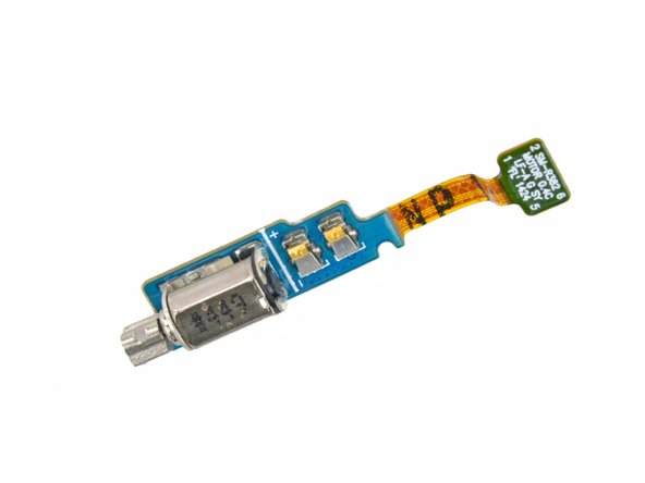

    • Next we focus our attention on the vibrator assembly. We definitely know this is the right vibrator inside, since the assembly also contains the Gear Live's SM-R382 model number.
    • This is also a limited-release vibrator motor — #449 of fifty billion produced.*
    • (*Our estimate based on no real knowledge of actual manufacturing numbers.)

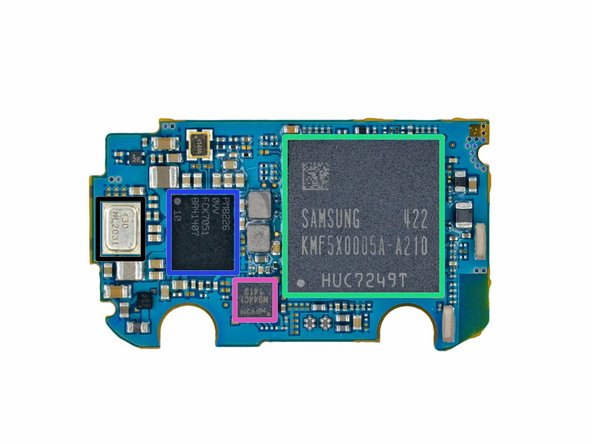

    • With a bit of patient spudgering, the boards are disengaged—leaving the motherboard stripped and primed for some primo IC analysis:
    • Maxim Integrated MAX77836 Low-Voltage Input, 3V/3.3V/5V/ Adjustable Output, Step-Up DC-DC Converter
    • Broadcom BCM4334W Bluetooth 4.0 / 802.11 a/b/g/n Wi-Fi / FM Receiver
    • STMicroelectronics STM32F401B ARM-Cortex M4 MCU with 128KB Flash
    • Samsung KMF5X0005A-A210 512 MB DRAM package with the Qualcomm APQ8026 System on Chip layered beneath
    • Qualcomm PM8226 power management IC
    • InvenSense MP92M 9-axis Gyro + Accelerometer + Compass
    • InvenSense ICS-43430 microphone

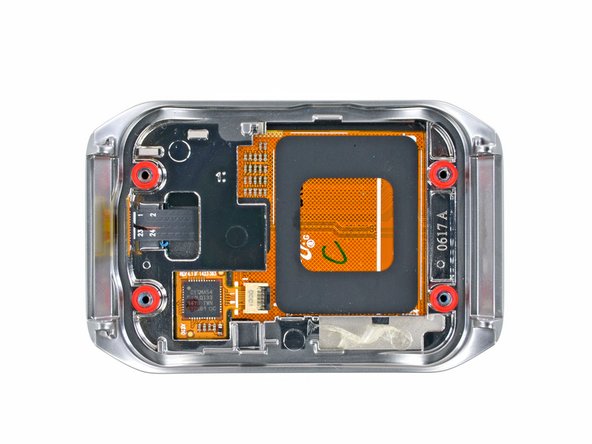

  11. Samsung Gear Live Teardown: crwdns2935265:012crwdnd2935265:01crwdnd2935265:03crwdne2935265:0 Samsung Gear Live Teardown: crwdns2935265:012crwdnd2935265:02crwdnd2935265:03crwdne2935265:0 Samsung Gear Live Teardown: crwdns2935265:012crwdnd2935265:03crwdnd2935265:03crwdne2935265:0

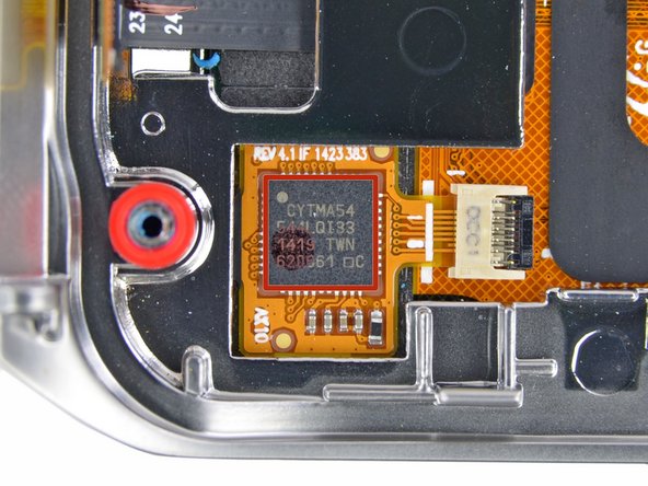

    • Happily, we're not yet done tweezing, because this little thermal pad needs some tweezing. Did we mention that "tweezing" is both useful and fun to say?
    • Beneath the thermal pad, a Cypress Semiconductor CYTMA545 touchscreen controller blinks its eyes under the bright lights of the teardown table.
    • Would that the display itself could also be tweezed. Sadly, it seems to be glued into the metal chassis.

Is there a chip on the device that would support Wifi? What is more power friendly: BT 4.0 or Wifi? So many questions!
Tim - crwdns2934203:0crwdne2934203:0
BT 4.0 is less enegy expensive
