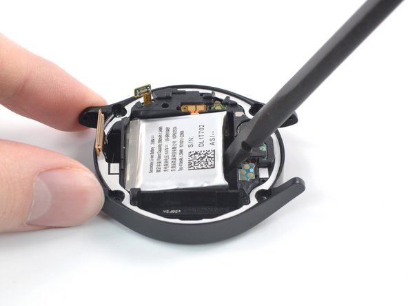

  10. Samsung Galaxy Watch5 Battery Replacement, Pry up the battery: crwdns2935265:010crwdnd2935265:01crwdnd2935265:02crwdne2935265:0 Samsung Galaxy Watch5 Battery Replacement, Pry up the battery: crwdns2935265:010crwdnd2935265:02crwdnd2935265:02crwdne2935265:0
    • Place a spudger into the small gap between the plastic frame and the battery, opposite the display cable.
    • Carefully pry the battery up and out of its recess.
    • The battery is adhered to the core with mild adhesive. If it feels stuck, lightly heat it with an iOpener or hair dryer to soften the adhesive underneath.
    • Don't try to fully remove the battery just yet, as its connector is still adhered to the core assembly.

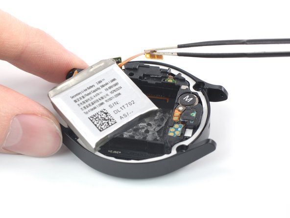

  11. Samsung Galaxy Watch5 Battery Replacement, Release the battery connector: crwdns2935265:011crwdnd2935265:01crwdnd2935265:02crwdne2935265:0 Samsung Galaxy Watch5 Battery Replacement, Release the battery connector: crwdns2935265:011crwdnd2935265:02crwdnd2935265:02crwdne2935265:0
    • Lift the battery up enough to access its glued-down connector cable.
    • Use a pair of tweezers to peel the battery connector from the frame.
    • You'll most likely be able to reuse the existing adhesive to secure the new battery. If it's not sticky enough, use double sided or pre-cut adhesive tape.

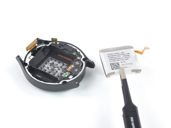

  12. Samsung Galaxy Watch5 Battery Replacement, Remove the battery: crwdns2935265:012crwdnd2935265:01crwdnd2935265:02crwdne2935265:0 Samsung Galaxy Watch5 Battery Replacement, Remove the battery: crwdns2935265:012crwdnd2935265:02crwdnd2935265:02crwdne2935265:0
    Tesa 61395 Tape
    $5.99
    • Use a pair of tweezers or your fingers to remove the battery.
    • Don't accidentally poke or slice the battery with any sharp tools. A punctured battery may leak dangerous chemicals or catch fire.
    • Never reuse a deformed or damaged battery—it's a fire hazard. Replace it with a new battery.
    • To install a new battery:
    • Use tweezers or your fingers to remove the old adhesive from the frame.
    • Use high-concentration isopropyl alcohol (>90%) and a lint-free cloth to remove any remaining adhesive residue.
    • If your replacement battery isn‘t already equipped with adhesive, apply thin, double-sided tape such as Tesa Tape directly to the battery recess where the old adhesive was.
    • Lay the replacement battery in its recess and press down firmly to secure it.
