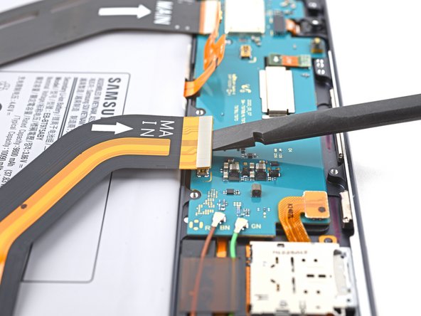

  24. Samsung Galaxy Tab S7 Plus 5G Battery Replacement, Disconnect the keyboard dock port cable: crwdns2935265:024crwdnd2935265:01crwdnd2935265:02crwdne2935265:0 Samsung Galaxy Tab S7 Plus 5G Battery Replacement, Disconnect the keyboard dock port cable: crwdns2935265:024crwdnd2935265:02crwdnd2935265:02crwdne2935265:0
    • Use the flat end of a spudger to pry up and disconnect the keyboard dock port cable's press connector secured to the motherboard.
  25. Samsung Galaxy Tab S7 Plus 5G Battery Replacement, Disconnect the daughterboard interconnect cable: crwdns2935265:025crwdnd2935265:01crwdnd2935265:02crwdne2935265:0 Samsung Galaxy Tab S7 Plus 5G Battery Replacement, Disconnect the daughterboard interconnect cable: crwdns2935265:025crwdnd2935265:02crwdnd2935265:02crwdne2935265:0
    • Use the flat end of a spudger to pry up and disconnect the daughterboard interconnect cable's press connector secured to the motherboard.
