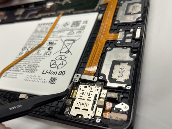

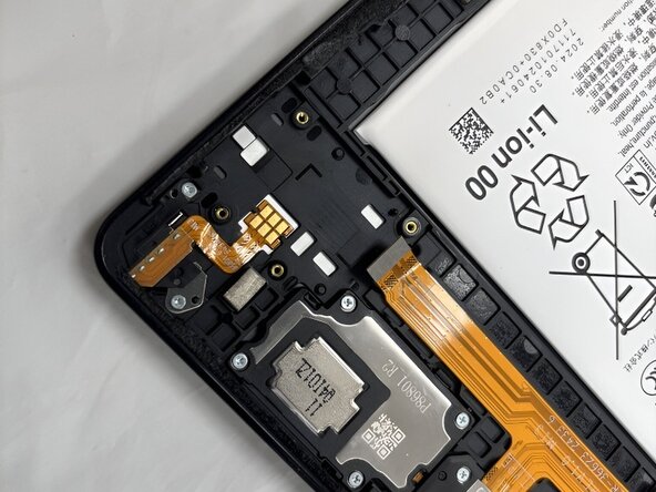

    • Gently lift the screen towards the top of the device (the side with the front camera), being careful not to damage the orange flex cable.
    • Use a JIS #00 screwdriver to remove two 2.4 mm screws securing the metal bracket.
    • Remove the metal bracket covering the connector and place it to the side to use for reassembly.

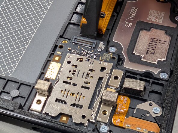

    • Insert the SIM tool into the small hole on the side of the case until the tray pops out. Then remove the tray and set it aside.
    • If you're having trouble removing the tray, reinsert the SIM tool and gently pull the tray out with it until you can use your hands to remove it.
    • Use a JIS #00 to remove the single 2.3 mm screw that holds the metal bracket in place.
    • Remove the metal bracket that covers the press connector and set aside with its screw.
    • Place a spudger or an opening tool under the connector's edge and pry straight up to disconnect it.
    • Make sure to pry under the edge of the connector itself, and not under the socket on the board. Otherwise, you risk permanently damaging the socket.

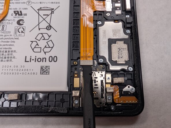

    • Unscrew the three JIS #00 screws found around the edges of the SIM Tray.
    • Gently wedge the spudger underneath the SIM port to get leverage to remove it more easily.
    • Remove the SIM port from the device, ensuring that no debris or dust remains where it was previously located.
