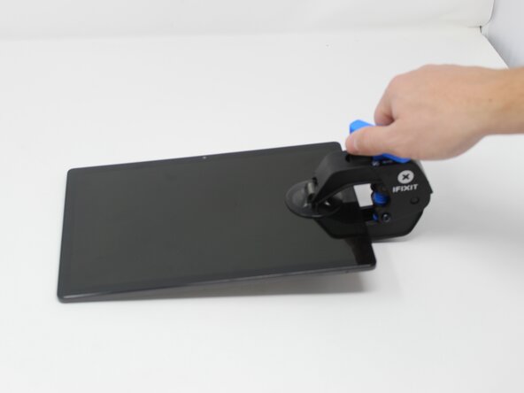

    • Fully power off the device.
    • Apply anti-clamp or other suction device to apply constant upward force on the screen.
    • Orient the screen so it is face-up.
    • Heat the screen to soften the adhesive with a heat gun or blow dryer. Be sure to heat all sides as evenly as possible.
    • Be careful not to overheat the device, as that could cause damage. It should be just too hot to touch.

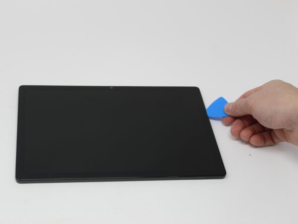

  2. Samsung Galaxy Tab A8 Screen Replacement: crwdns2935265:02crwdnd2935265:01crwdnd2935265:03crwdne2935265:0 Samsung Galaxy Tab A8 Screen Replacement: crwdns2935265:02crwdnd2935265:02crwdnd2935265:03crwdne2935265:0 Samsung Galaxy Tab A8 Screen Replacement: crwdns2935265:02crwdnd2935265:03crwdnd2935265:03crwdne2935265:0
    • Use plastic Opening Picks, or a Jimmy if necessary, to remove the adhesive and get under the screen.
    • Using the plastic Opening Picks, move around the screen slowly, one corner at a time. Every few inches, leave an additional Opening Pick behind where you are working to hold the screen open while continuing to remove the adhesive.
    • Be careful not to scratch or break the screen during removal.
