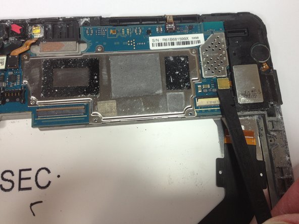

    • Hold down the motherboard with your finger and use a spudger to gently pry up the connection for the volume keys and power key.
  8. Samsung Galaxy Tab 10.1 Motherboard Replacement, Flash and Rear Camera Connection: crwdns2935265:08crwdnd2935265:01crwdnd2935265:02crwdne2935265:0 Samsung Galaxy Tab 10.1 Motherboard Replacement, Flash and Rear Camera Connection: crwdns2935265:08crwdnd2935265:02crwdnd2935265:02crwdne2935265:0

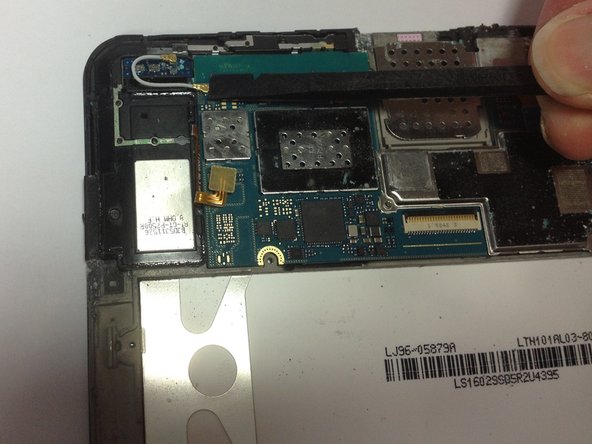

    • Using the flat end of a spudger, disconnect the black flash cable connector from the motherboard.
    • Disconnect the white rear-facing camera connector.

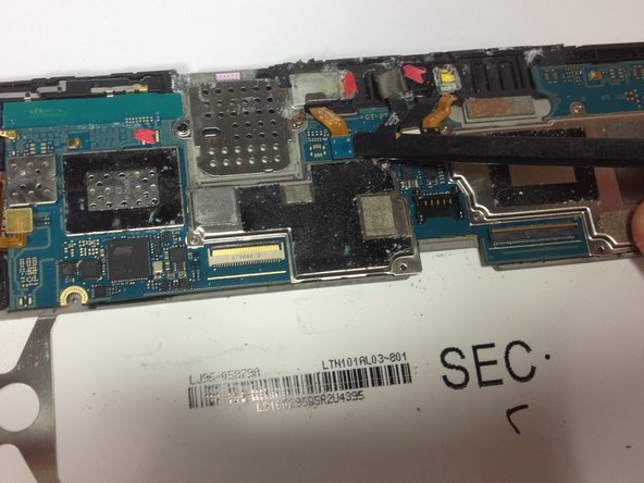

    • Use the flat end of a spudger to disconnect the orange front-facing camera connector.
    • Disconnect the blue Micro SD card/headphone jack connector from its socket on the motherboard.
  10. Samsung Galaxy Tab 10.1 Motherboard Replacement, Speakers and Antenna Connection: crwdns2935265:010crwdnd2935265:01crwdnd2935265:03crwdne2935265:0 Samsung Galaxy Tab 10.1 Motherboard Replacement, Speakers and Antenna Connection: crwdns2935265:010crwdnd2935265:02crwdnd2935265:03crwdne2935265:0 Samsung Galaxy Tab 10.1 Motherboard Replacement, Speakers and Antenna Connection: crwdns2935265:010crwdnd2935265:03crwdnd2935265:03crwdne2935265:0
    • Using the flat end of a spudger, disconnect the orange speaker connectors for the left and right speakers.
    • Disconnect the gold antenna cable connector from its socket on the motherboard.

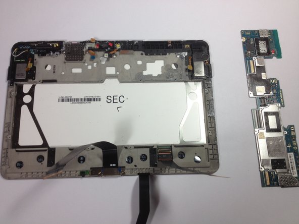

  11. Samsung Galaxy Tab 10.1 Motherboard Replacement, Motherboard Removal: crwdns2935265:011crwdnd2935265:01crwdnd2935265:02crwdne2935265:0 Samsung Galaxy Tab 10.1 Motherboard Replacement, Motherboard Removal: crwdns2935265:011crwdnd2935265:02crwdnd2935265:02crwdne2935265:0
    • Lifting from the bottom edge, gently remove the motherboard.
