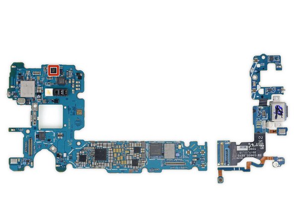

Next we turn our attention to the brains of the phone, and after removing a few friendly Phillips screws, the motherboard slides free.
Near the top of the board we get a look at the S9's new heart rate and blood pressure sensors, a step up from the standard heart rate sensor seen on many phones.
Say hello to Dr. Bixby.

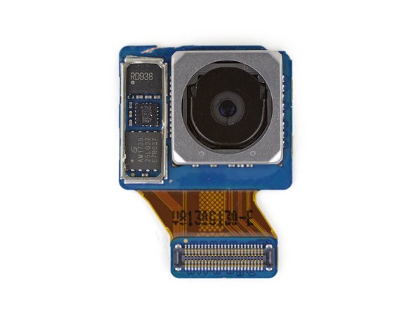

Compared to some flagships, the S9 has twice the f-stops and half the sensors.
Not shown: Samsung's highly touted 2 Gbit LPDDR4 DRAM, layered right underneath the image sensor.
Shown: Some other mystery chips.
RD938 likely OIS driver
STMicroelectronics L2G2IS 2-axis OIS gyroscope
GigaDevice GD25LQ32 32 Mb serial flash

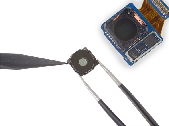

We want to try out the S9's new dual aperture, but using the camera app seems a little too conventional.
After a bit of disassembly, a spudger seems to do the trick instead.
This may seem goofy, but the S9 really will have a small actuator that mechanically opens and closes the aperture—a mechanical bit that can fail.
Removing the lens also reveals the image sensor. Taking a closer look we see...yep that's an image sensor. Maybe some X-rays can show us that DRAM...
