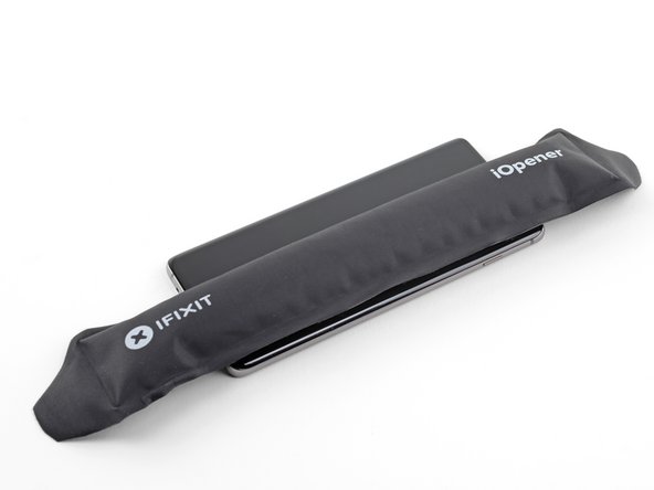

      • Unplug and power off your phone before you begin.
      • Heat an iOpener and apply it to the back cover's right edge for two minutes.
      • A hair dryer, heat gun, or hot plate may also be used, but be careful not to overheat the phone—the display and internal battery are both susceptible to heat damage.
      • As you wait, take a look at the image of the removed back cover and take note of where the adhesive is located.

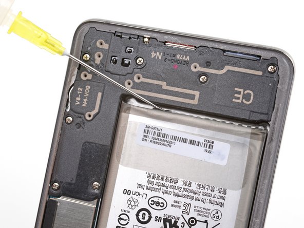

    1. Samsung Galaxy S10+ Battery Replacement, Battery: crwdns2935265:014crwdnd2935265:01crwdnd2935265:02crwdne2935265:0 Samsung Galaxy S10+ Battery Replacement, Battery: crwdns2935265:014crwdnd2935265:02crwdnd2935265:02crwdne2935265:0
      • The battery is heavily glued in place. Note the marked areas under the battery:
      • The frame, where the battery is held by strong adhesive
      • A cutout in the frame, exposing the fragile display assembly underneath. Be careful when prying in this area, or you may damage the display.
    2. Samsung Galaxy S10+ Battery Replacement: crwdns2935265:015crwdnd2935265:01crwdnd2935265:03crwdne2935265:0 Samsung Galaxy S10+ Battery Replacement: crwdns2935265:015crwdnd2935265:02crwdnd2935265:03crwdne2935265:0 Samsung Galaxy S10+ Battery Replacement: crwdns2935265:015crwdnd2935265:03crwdnd2935265:03crwdne2935265:0
      • Applying high concentration (over 90%) isopropyl alcohol to the battery will make the battery removal significantly easier.
      • Lift the bottom edge of the phone up and hold the phone in a tilted position.
      • Apply 1-2 drops of isopropyl alcohol into the crevice between the battery and the phone's bottom midframe.
      • Using too much alcohol can damage the display.
      • Hold the phone in a tilted position for a minute to allow the isopropyl alcohol to soak into the adhesive.
      • Alternatively, heat an iOpener and apply it to the right side of the front of the phone for two minutes.

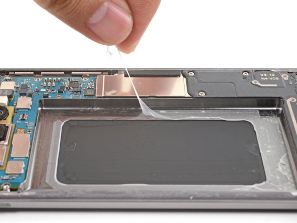

The hardest part was actually getting rid of all the adhesive residue everywhere. That step took the longest. The battery removal went very quickly, surprisingly so.
isely - crwdns2934203:0crwdne2934203:0 crwdns2950251:0crwdne2950251:0
Worked great to replace my swollen battery, and thanks to it being swollen I could actually skip the steps to pry open the back cover. Anyway, from my experience everything is correct, the only downside is that I used a little more than a few drops to loosen the battery and after the whole annoyance of removing the glue and placing the new battery I turned on the phone to check everything was working and my back cameras were blurry.... yeah, too much alcohol, had to clean them up very well.... but the sad part is that some of the alcohol made it's way to the front cameras... now they are both blurry.
Brian - crwdns2934203:0crwdne2934203:0 crwdns2950251:0crwdne2950251:0
لم استطيع أشحن البطارية خارج أمريكا اذاً ما الفائدة ؟
Omar Al - crwdns2934203:0crwdne2934203:0 crwdns2950251:0crwdne2950251:0
I agree with isely - the toughest part was removing all the left over adhesive. Removing the battery was a bit of a pain as well, even with isopropyl alcohol. I recommend using heat to remove the battery.
To get rid of the excess adhesive, I recommend using a heat gun and peeling it up with your thumb. As long as it's malleable, you can slowly peel it up to create a ball of adhesive and hopefully get most of it off at once. I was trying Q-Tips with isopropyl alcohol and that mostly just spread around the adhesive and got fluff from the Q-Tip over the phone.
Finally, I recommend buying a precut adhesive card to glue it back in place. It took me quite a while to cut a bunch of strips with my 2mm double sided tape.
