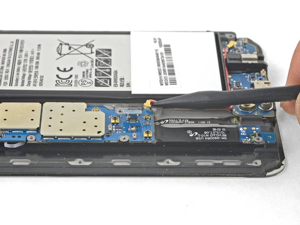

  14. Samsung Galaxy Note5 Display Assembly Replacement, Samsung Galaxy Note5 Battery Disconnect: crwdns2935265:014crwdnd2935265:01crwdnd2935265:02crwdne2935265:0 Samsung Galaxy Note5 Display Assembly Replacement, Samsung Galaxy Note5 Battery Disconnect: crwdns2935265:014crwdnd2935265:02crwdnd2935265:02crwdne2935265:0
    • Using the flat end of a spudger, lift the battery connector straight up from its socket on the motherboard.

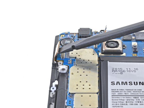

  15. Samsung Galaxy Note5 Display Assembly Replacement, Motherboard: crwdns2935265:015crwdnd2935265:01crwdnd2935265:02crwdne2935265:0 Samsung Galaxy Note5 Display Assembly Replacement, Motherboard: crwdns2935265:015crwdnd2935265:02crwdnd2935265:02crwdne2935265:0
    • Using the flat end of a spudger, disconnect the earpiece connector.

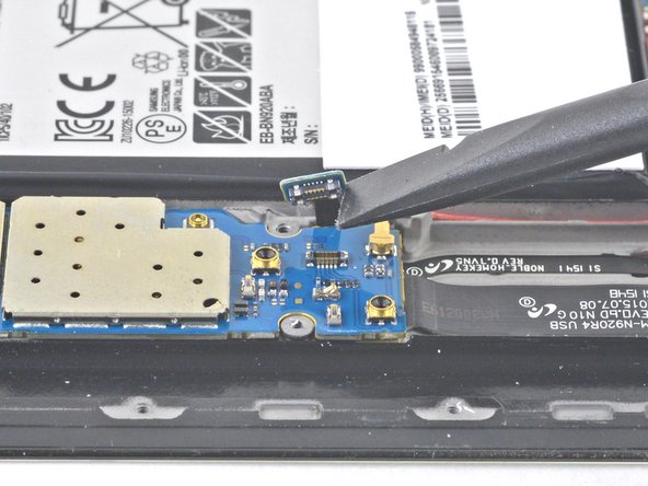

  19. Samsung Galaxy Note5 Display Assembly Replacement: crwdns2935265:019crwdnd2935265:01crwdnd2935265:02crwdne2935265:0 Samsung Galaxy Note5 Display Assembly Replacement: crwdns2935265:019crwdnd2935265:02crwdnd2935265:02crwdne2935265:0
    • Using the pointed end of a spudger, disconnect the antenna cable.

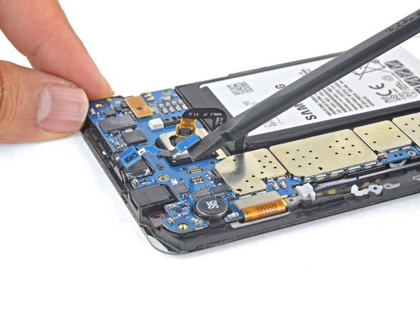

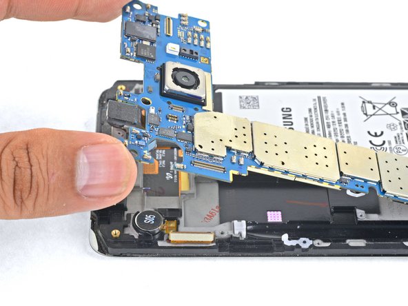

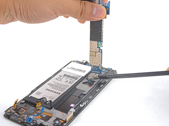

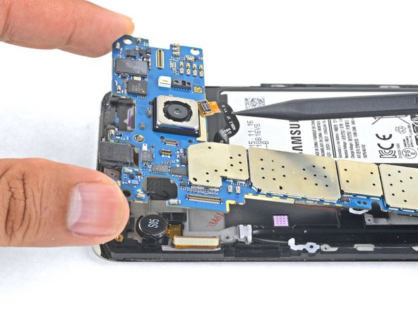

  20. Samsung Galaxy Note5 Display Assembly Replacement: crwdns2935265:020crwdnd2935265:01crwdnd2935265:03crwdne2935265:0 Samsung Galaxy Note5 Display Assembly Replacement: crwdns2935265:020crwdnd2935265:02crwdnd2935265:03crwdne2935265:0 Samsung Galaxy Note5 Display Assembly Replacement: crwdns2935265:020crwdnd2935265:03crwdnd2935265:03crwdne2935265:0
    • Holding the motherboard by the top corners, hinge it upwards while clearing flex cables out of its path.
    • Do not remove the motherboard. It is still attached to the daughterboard.
  21. Samsung Galaxy Note5 Display Assembly Replacement: crwdns2935265:021crwdnd2935265:01crwdnd2935265:02crwdne2935265:0 Samsung Galaxy Note5 Display Assembly Replacement: crwdns2935265:021crwdnd2935265:02crwdnd2935265:02crwdne2935265:0
    • Using the flat end of a spudger, disconnect the daughterboard connector from the motherboard.
    • Remove the motherboard.

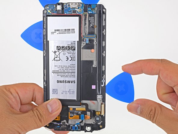

  22. Samsung Galaxy Note5 Display Assembly Replacement, Display Assembly: crwdns2935265:022crwdnd2935265:01crwdnd2935265:01crwdne2935265:0
    • Prepare an iOpener and apply it to the left edge of the display for about two minutes.
    • You may need to reheat and reapply the iOpener several times to get the phone warm enough. Follow the iOpener instructions to avoid overheating.
    • The glue securing the display can be significantly stronger than the glue that secures the back cover. If necessary, switch to a hair dryer or heat gun in order to apply enough heat to weaken the adhesive.

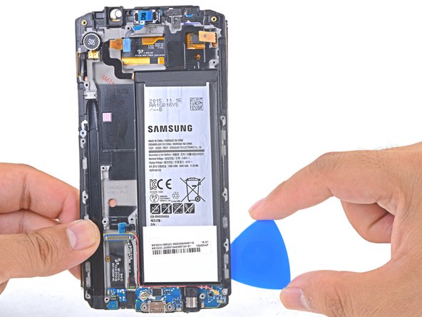

  23. Samsung Galaxy Note5 Display Assembly Replacement: crwdns2935265:023crwdnd2935265:01crwdnd2935265:02crwdne2935265:0 Samsung Galaxy Note5 Display Assembly Replacement: crwdns2935265:023crwdnd2935265:02crwdnd2935265:02crwdne2935265:0
    • Insert an opening pick between the plastic frame and the display assembly on the same edge you just heated.
    • The pick should reside above the pink shielding layer, which covers the OLED panel.
    • If you can see the pick through the front glass, you've inserted it between the OLED panel and the front glass. Remove the pick and try again.

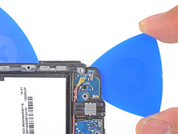

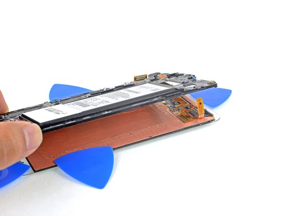

  24. Samsung Galaxy Note5 Display Assembly Replacement: crwdns2935265:024crwdnd2935265:01crwdnd2935265:03crwdne2935265:0 Samsung Galaxy Note5 Display Assembly Replacement: crwdns2935265:024crwdnd2935265:02crwdnd2935265:03crwdne2935265:0 Samsung Galaxy Note5 Display Assembly Replacement: crwdns2935265:024crwdnd2935265:03crwdnd2935265:03crwdne2935265:0
    • Slide the opening pick down the battery-side of the phone, separating the adhesive.
    • Stop when you get to the bottom of the battery to avoid damaging delicate capacitive buttons at the bottom of the display.
    • Go slowly so that the tip doesn't slip out of the seam. If sliding becomes difficult, reheat and reapply the iOpener.
    • Leave the pick in place and grab a second pick as you proceed to the next step. Leaving the pick inserted can help prevent the glue you just separated from re-adhering.

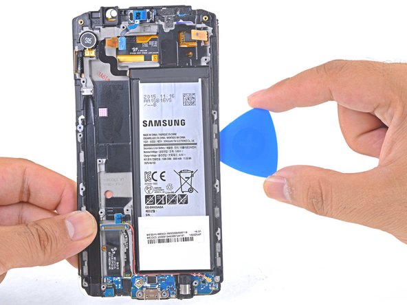

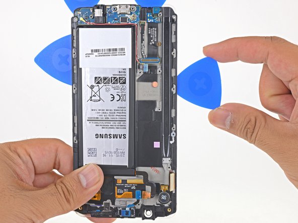

  25. Samsung Galaxy Note5 Display Assembly Replacement: crwdns2935265:025crwdnd2935265:01crwdnd2935265:03crwdne2935265:0 Samsung Galaxy Note5 Display Assembly Replacement: crwdns2935265:025crwdnd2935265:02crwdnd2935265:03crwdne2935265:0 Samsung Galaxy Note5 Display Assembly Replacement: crwdns2935265:025crwdnd2935265:03crwdnd2935265:03crwdne2935265:0

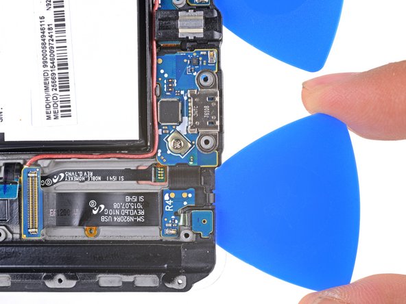

    • Heat an iOpener and apply it to the non-battery-edge of the phone.
    • Insert a pick no more than 0.25 inches (~6 mm) into the bottom edge of the phone.
    • Carefully slide the pick along the edge, starting at the headphone jack, until you reach just past the charging port.

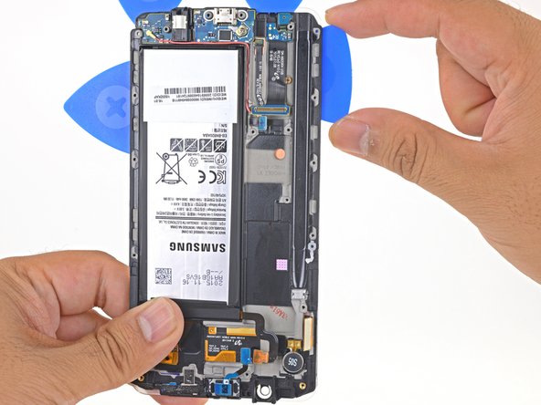

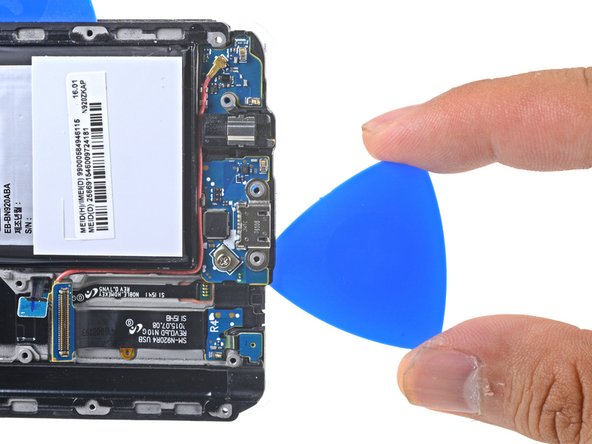

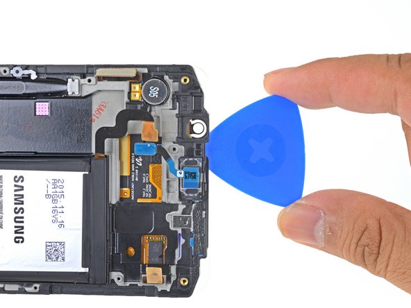

  26. Samsung Galaxy Note5 Display Assembly Replacement: crwdns2935265:026crwdnd2935265:01crwdnd2935265:02crwdne2935265:0 Samsung Galaxy Note5 Display Assembly Replacement: crwdns2935265:026crwdnd2935265:02crwdnd2935265:02crwdne2935265:0
    • Slide an opening pick from the battery edge battery edge of the phone along the edge of the phone to safely cut over the capacitive button.
    • Leave the pick in place as you proceed to the next button.

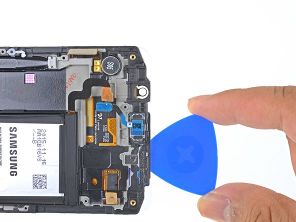

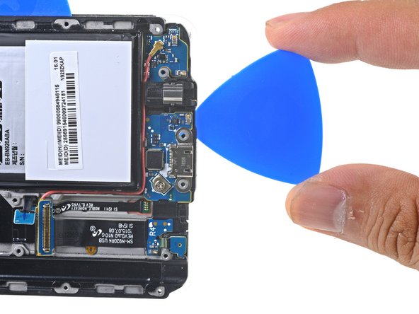

  27. Samsung Galaxy Note5 Display Assembly Replacement: crwdns2935265:027crwdnd2935265:01crwdnd2935265:02crwdne2935265:0 Samsung Galaxy Note5 Display Assembly Replacement: crwdns2935265:027crwdnd2935265:02crwdnd2935265:02crwdne2935265:0
    • Insert an opening pick under the bottom edge of the display directly below the daughterboard ribbon cable to cut over the other capacitive button.
    • Leave the pick in place.

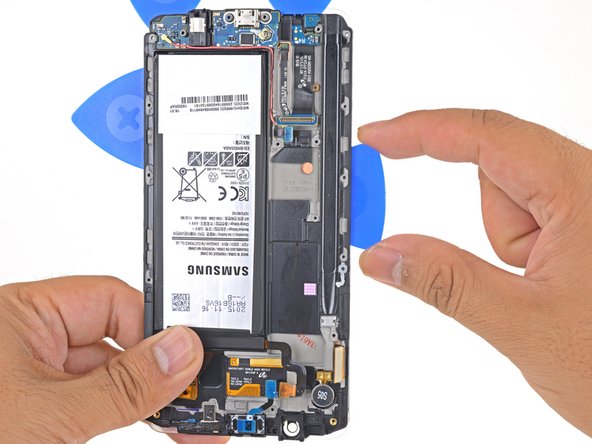

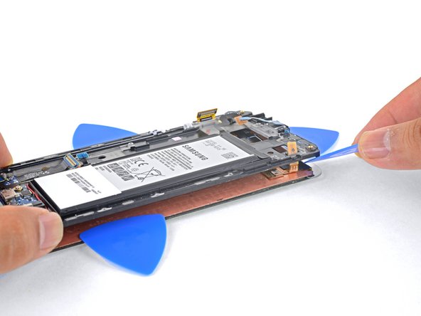

  28. Samsung Galaxy Note5 Display Assembly Replacement: crwdns2935265:028crwdnd2935265:01crwdnd2935265:03crwdne2935265:0 Samsung Galaxy Note5 Display Assembly Replacement: crwdns2935265:028crwdnd2935265:02crwdnd2935265:03crwdne2935265:0 Samsung Galaxy Note5 Display Assembly Replacement: crwdns2935265:028crwdnd2935265:03crwdnd2935265:03crwdne2935265:0
    • Slide an opening pick down the non-battery-edge of the phone, separating the adhesive.
  29. Samsung Galaxy Note5 Display Assembly Replacement: crwdns2935265:029crwdnd2935265:01crwdnd2935265:03crwdne2935265:0 Samsung Galaxy Note5 Display Assembly Replacement: crwdns2935265:029crwdnd2935265:02crwdnd2935265:03crwdne2935265:0 Samsung Galaxy Note5 Display Assembly Replacement: crwdns2935265:029crwdnd2935265:03crwdnd2935265:03crwdne2935265:0
    • The non-battery-edge contains a wider swath of adhesive than the other sides. Insert the opening pick as deep as you can to cut through all of it.
    • If cutting is difficult, apply more heat as needed.
    • Leave the pick in place to prevent the adhesive from resealing, and grab another pick as you proceed to the next step.

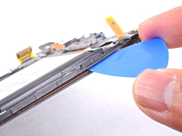

  30. Samsung Galaxy Note5 Display Assembly Replacement: crwdns2935265:030crwdnd2935265:01crwdnd2935265:03crwdne2935265:0 Samsung Galaxy Note5 Display Assembly Replacement: crwdns2935265:030crwdnd2935265:02crwdnd2935265:03crwdne2935265:0 Samsung Galaxy Note5 Display Assembly Replacement: crwdns2935265:030crwdnd2935265:03crwdnd2935265:03crwdne2935265:0
    • Cut along the top edge of the phone, making sure not to insert the pick more than 0.25 inches (~6 mm) to avoid damaging the front-facing sensors.

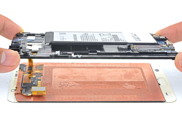

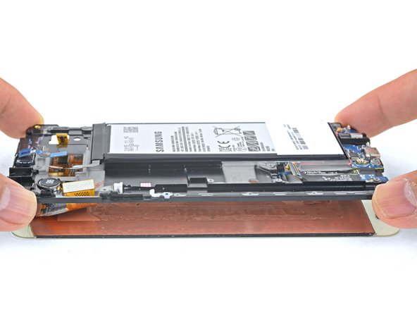

  31. Samsung Galaxy Note5 Display Assembly Replacement: crwdns2935265:031crwdnd2935265:01crwdnd2935265:03crwdne2935265:0 Samsung Galaxy Note5 Display Assembly Replacement: crwdns2935265:031crwdnd2935265:02crwdnd2935265:03crwdne2935265:0 Samsung Galaxy Note5 Display Assembly Replacement: crwdns2935265:031crwdnd2935265:03crwdnd2935265:03crwdne2935265:0
    • Use the opening picks to cut any remaining adhesive holding the display to the frame.
    • Swing the frame away from the display assembly, threading the touchscreen connector through the frame.
  32. Samsung Galaxy Note5 Display Assembly Replacement: crwdns2935265:032crwdnd2935265:01crwdnd2935265:03crwdne2935265:0 Samsung Galaxy Note5 Display Assembly Replacement: crwdns2935265:032crwdnd2935265:02crwdnd2935265:03crwdne2935265:0 Samsung Galaxy Note5 Display Assembly Replacement: crwdns2935265:032crwdnd2935265:03crwdnd2935265:03crwdne2935265:0
    • Lift the frame away from the display assembly, threading the display connector through the frame.
    • Remove the frame.

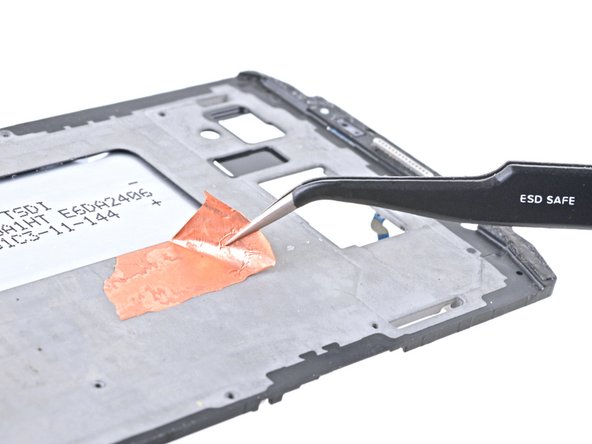

  33. Samsung Galaxy Note5 Display Assembly Replacement: crwdns2935265:033crwdnd2935265:01crwdnd2935265:02crwdne2935265:0 Samsung Galaxy Note5 Display Assembly Replacement: crwdns2935265:033crwdnd2935265:02crwdnd2935265:02crwdne2935265:0
    • Before installing a new display, it's very important to remove all traces of the old adhesive from the frame, while taking special care to remove any small glass fragments or other debris.
    • After removing all traces of glue and glass from the frame, clean the adhesion areas with 90% (or higher) isopropyl alcohol and a lint-free cloth or coffee filter. Swipe in one direction only, not back and forth.
    • This helps remove any remaining adhesive residue and preps the surface for the new display.
    • If the frame is bent, or if any glue or glass remnants are left behind, the new display will not mount correctly and may be damaged.
Compare your new replacement part to the original part. You may need to transfer remaining components or remove adhesive backings from the new part before installing.
