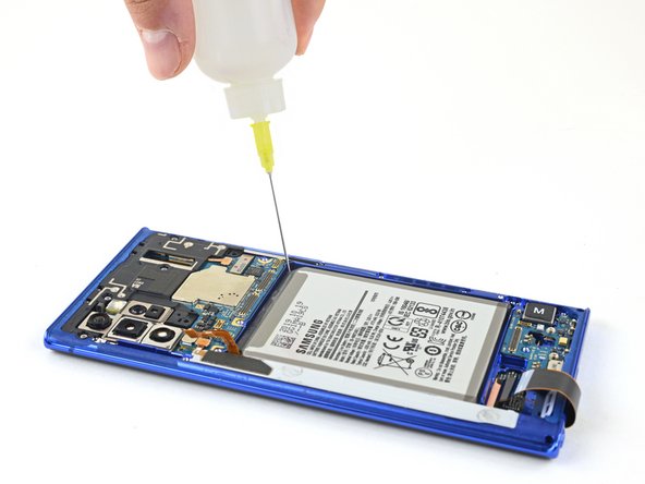

    2. Samsung Galaxy Note10+ Battery Replacement, Loosen the battery adhesive: crwdns2935265:017crwdnd2935265:01crwdnd2935265:02crwdne2935265:0 Samsung Galaxy Note10+ Battery Replacement, Loosen the battery adhesive: crwdns2935265:017crwdnd2935265:02crwdnd2935265:02crwdne2935265:0
      • Apply 1-2 drops of high concentration (90% or greater) isopropyl alcohol underneath the battery at the tear-shaped indents near the corners of the battery well.
      • Using too much alcohol can damage the display.
      • Wait about two minutes for the isopropyl alcohol to penetrate and weaken the battery adhesive before you proceed to the next step.

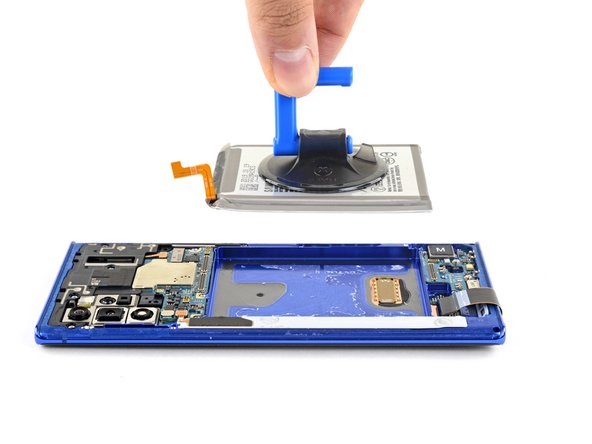

    3. Samsung Galaxy Note10+ Battery Replacement, Remove the battery: crwdns2935265:018crwdnd2935265:01crwdnd2935265:03crwdne2935265:0 Samsung Galaxy Note10+ Battery Replacement, Remove the battery: crwdns2935265:018crwdnd2935265:02crwdnd2935265:03crwdne2935265:0 Samsung Galaxy Note10+ Battery Replacement, Remove the battery: crwdns2935265:018crwdnd2935265:03crwdnd2935265:03crwdne2935265:0
      • Apply a suction cup to the back of the battery.
      • Pull up on the suction cup with strong, steady force to begin to separate the battery from the frame.
      • If this is difficult, apply a few more drops of isopropyl alcohol underneath the battery, let it sit for two minutes, and try again.
      • Insert the point of an opening pick into the gap created between the battery and frame.
      • Don't insert the opening pick more than halfway or you risk damaging the fingerprint sensor underneath.
      • Pull up on the suction cup to remove the battery.
      • If you used isopropyl alcohol, wait ten minutes before installing the new battery to allow the alcohol to completely evaporate.
      • When you're reassembling your phone, remove the old adhesive and apply stretch release adhesive strips, double sided adhesive tape, or pre-cut adhesive to secure the new battery.
