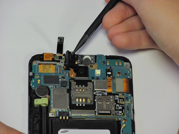

  7. Samsung Galaxy Note Headphone Jack and Earpiece Replacement, Headphone Jack and Earpiece: crwdns2935265:07crwdnd2935265:01crwdnd2935265:01crwdne2935265:0
    • Use the spudger to pry up the yellow ribbon cable.
  8. Samsung Galaxy Note Headphone Jack and Earpiece Replacement: crwdns2935265:08crwdnd2935265:01crwdnd2935265:01crwdne2935265:0
    • Use the spudger to pry up the long, green ribbon next to the yellow one you just pried up.
    • Push the green ribbon back to access the black bracket underneath it.
  9. Samsung Galaxy Note Headphone Jack and Earpiece Replacement: crwdns2935265:09crwdnd2935265:01crwdnd2935265:01crwdne2935265:0
    • Use your fingers to gently lift up the black bracket and set it aside.
  10. Samsung Galaxy Note Headphone Jack and Earpiece Replacement: crwdns2935265:010crwdnd2935265:01crwdnd2935265:02crwdne2935265:0 Samsung Galaxy Note Headphone Jack and Earpiece Replacement: crwdns2935265:010crwdnd2935265:02crwdnd2935265:02crwdne2935265:0
    • Flip the spudger around and insert the pointy end into the headphone jack.
    • Lift the headphone jack directly upwards using the spudger as a lever. This will also remove the connected speaker.
    • The headphone jack and earpiece are held down with an adhesive, so removing them might take some force.
