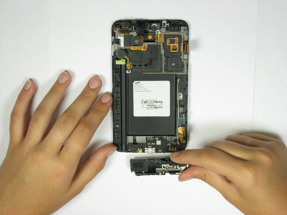

    1. Samsung Galaxy Note Antenna Replacement, Antenna: crwdns2935265:07crwdnd2935265:01crwdnd2935265:01crwdne2935265:0
      • Remove the two 3mm screws surrounded by a gold border with a Phillips #00 screwdriver.
    2. Samsung Galaxy Note Antenna Replacement: crwdns2935265:08crwdnd2935265:01crwdnd2935265:02crwdne2935265:0 Samsung Galaxy Note Antenna Replacement: crwdns2935265:08crwdnd2935265:02crwdnd2935265:02crwdne2935265:0

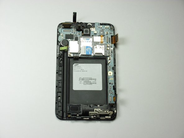

      • Use the spudger to pry up all six flex ribbons that hold the motherboard in place. They should pop off easily.
    3. Samsung Galaxy Note Antenna Replacement: crwdns2935265:09crwdnd2935265:01crwdnd2935265:01crwdne2935265:0
      • Use the spudger to pull off the white wire with the gold connector.
    4. Samsung Galaxy Note Antenna Replacement: crwdns2935265:010crwdnd2935265:01crwdnd2935265:01crwdne2935265:0
      • Lift the motherboard (PCB) directly up with your hands.
      • If the screws are all removed, the motherboard should come off easily.
    5. Samsung Galaxy Note Antenna Replacement: crwdns2935265:011crwdnd2935265:01crwdnd2935265:02crwdne2935265:0 Samsung Galaxy Note Antenna Replacement: crwdns2935265:011crwdnd2935265:02crwdnd2935265:02crwdne2935265:0
      • Use a Phillips #00 screwdriver to remove the three 3mm screws on the black rectangular bracket located towards the bottom of the phone.
    6. Samsung Galaxy Note Antenna Replacement: crwdns2935265:012crwdnd2935265:01crwdnd2935265:01crwdne2935265:0
      • Use the spudger's flat end to disconnect the other end of the antenna.
