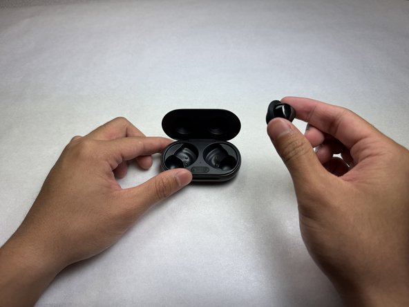

    • Before you proceed, discharge your battery below 25%. A charged lithium-ion battery can catch fire and/or explode if accidentally punctured.

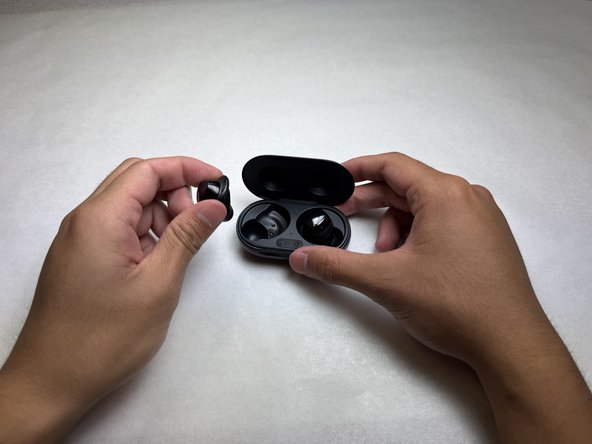

    • Open the case and remove both of the earbuds.

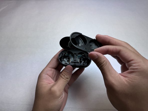

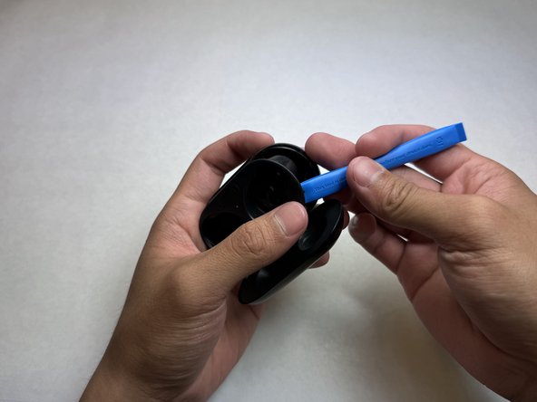

    • Insert an opening tool between the interior plastic cover and the exterior case.
    • This may take multiple tries at different contact angles.
    • Once inserted, pry up to begin separating the interior cover from the exterior case.
    • Move the opening tool around the edge until all of the clips holding the interior cover in place are released.
    • Remove and place the interior cover to the side.

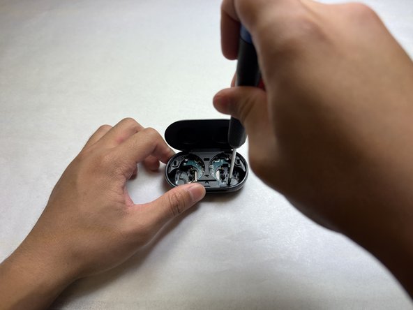

  3. Samsung Galaxy Buds Plus Case Battery Replacement: crwdns2935265:03crwdnd2935265:01crwdnd2935265:02crwdne2935265:0 Samsung Galaxy Buds Plus Case Battery Replacement: crwdns2935265:03crwdnd2935265:02crwdnd2935265:02crwdne2935265:0

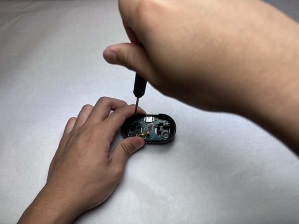

    • Use a Phillips #000 screwdriver to remove the four screws holding the case's lid and hinge.
    • All of the screws in this guide share the same head and are the same length.

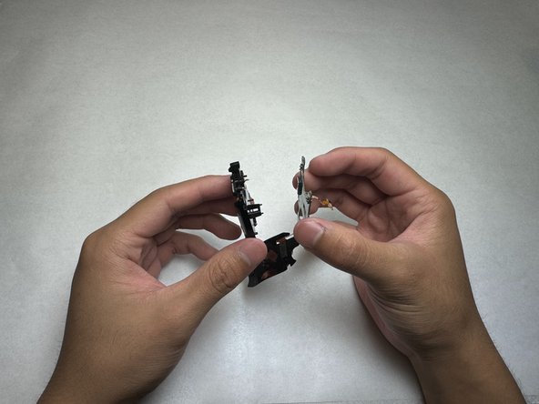

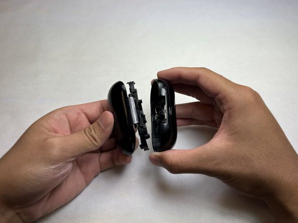

    • Flip the case over to the back.
    • Use a nylon spudger to pry and pop out the hinge from the body of the case.

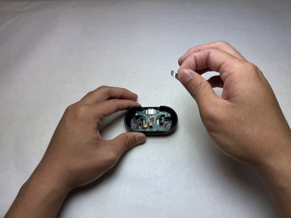

    • Use a Phillips #000 screwdriver to remove the two screws on either side of the USB-C port.
    • Remove the metal shielding from the USB-C port.
    • Remove the final Phillips #000 screw securing the motherboard and battery to the case.

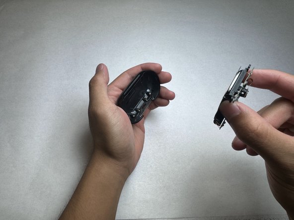

    • Firmly hold the case in one hand and pull out the motherboard and battery from the case using two fingers.

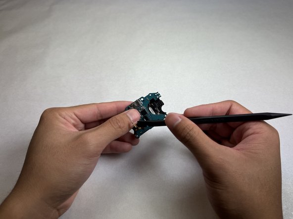

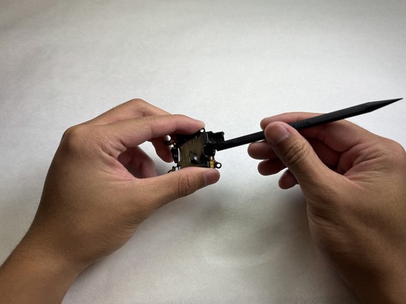

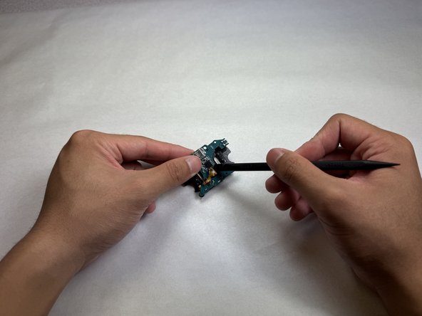

    • Identify the LED indicator and gently detach it from the plastic housing of the motherboard using the spudger.
  8. Samsung Galaxy Buds Plus Case Battery Replacement: crwdns2935265:08crwdnd2935265:01crwdnd2935265:02crwdne2935265:0 Samsung Galaxy Buds Plus Case Battery Replacement: crwdns2935265:08crwdnd2935265:02crwdnd2935265:02crwdne2935265:0
    • Flip the board over and peel off the wireless charging coil.
    • Be careful not to break the two thin wires connecting the charging coil to the motherboard.

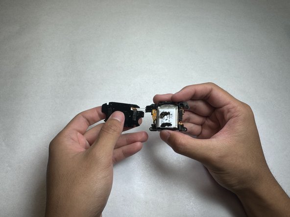

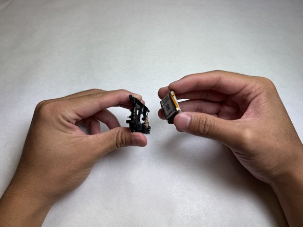

    • Separate the motherboard from the battery and plastic housing.
  10. Samsung Galaxy Buds Plus Case Battery Replacement: crwdns2935265:010crwdnd2935265:01crwdnd2935265:02crwdne2935265:0 Samsung Galaxy Buds Plus Case Battery Replacement: crwdns2935265:010crwdnd2935265:02crwdnd2935265:02crwdne2935265:0

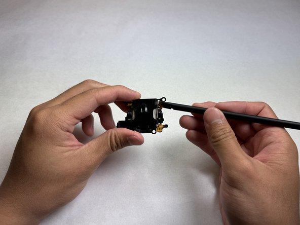

    • Identify the positive and negative terminal pads that are connected to the battery.
    • The corner that is diagonal to the correct pads should not have any pads.
    • Use the spudger to detach the pads from the plastic housing.
