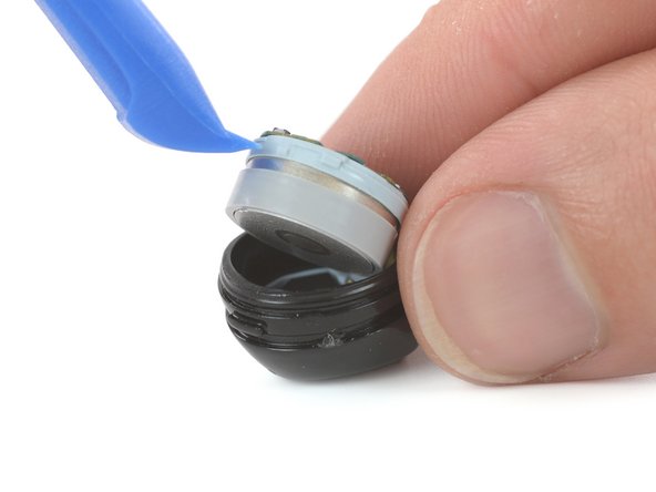

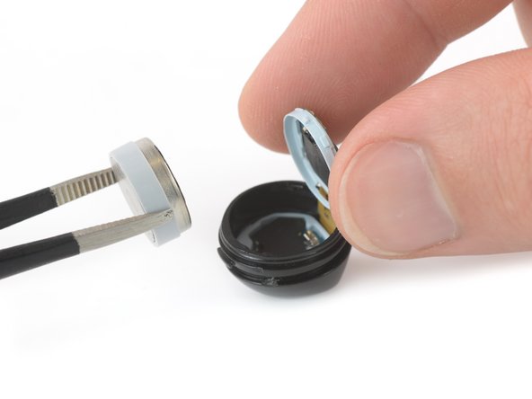

  8. Samsung Galaxy Buds Plus Battery Replacement, Remove the battery housing: crwdns2935265:08crwdnd2935265:01crwdnd2935265:02crwdne2935265:0 Samsung Galaxy Buds Plus Battery Replacement, Remove the battery housing: crwdns2935265:08crwdnd2935265:02crwdnd2935265:02crwdne2935265:0
    • The battery is housed in the plastic case.
    • Use a pair of blunt nose tweezers to remove the battery housing while holding the upper part with your fingers.
    • Be careful not to rip the thin motherboard flex cable.

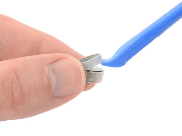

  9. Samsung Galaxy Buds Plus Battery Replacement, Remove the battery: crwdns2935265:09crwdnd2935265:01crwdnd2935265:02crwdne2935265:0 Samsung Galaxy Buds Plus Battery Replacement, Remove the battery: crwdns2935265:09crwdnd2935265:02crwdnd2935265:02crwdne2935265:0
    • Use an opening tool to separate the housing from the battery.
    • Remove the battery.
