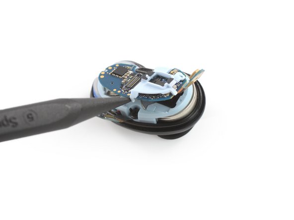

  5. Samsung Galaxy Buds Live Battery Replacement, Remove the motherboard: crwdns2935265:05crwdnd2935265:01crwdnd2935265:03crwdne2935265:0 Samsung Galaxy Buds Live Battery Replacement, Remove the motherboard: crwdns2935265:05crwdnd2935265:02crwdnd2935265:03crwdne2935265:0 Samsung Galaxy Buds Live Battery Replacement, Remove the motherboard: crwdns2935265:05crwdnd2935265:03crwdnd2935265:03crwdne2935265:0
    • Use a spudger to gently lift up the motherboard.
    • Remove the motherboard.

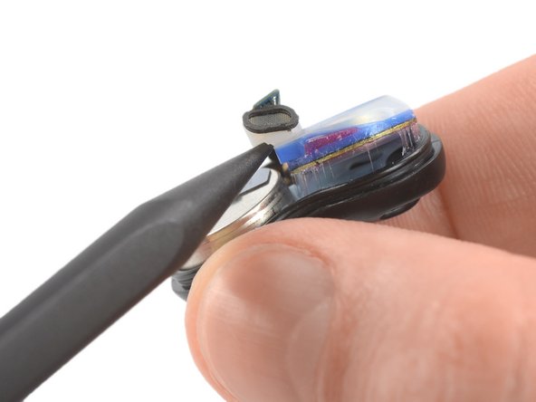

  8. Samsung Galaxy Buds Live Battery Replacement, Clear the battery: crwdns2935265:08crwdnd2935265:01crwdnd2935265:02crwdne2935265:0 Samsung Galaxy Buds Live Battery Replacement, Clear the battery: crwdns2935265:08crwdnd2935265:02crwdnd2935265:02crwdne2935265:0
    • Use the pointed end of a spudger to slightly lift up the speaker driver obscuring the battery.
    • The driver is held in place with light adhesive. Work carefully and don't tug on anything too hard.

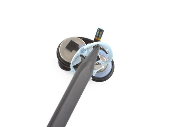

  9. Samsung Galaxy Buds Live Battery Replacement, Pry up the battery: crwdns2935265:09crwdnd2935265:01crwdnd2935265:03crwdne2935265:0 Samsung Galaxy Buds Live Battery Replacement, Pry up the battery: crwdns2935265:09crwdnd2935265:02crwdnd2935265:03crwdne2935265:0 Samsung Galaxy Buds Live Battery Replacement, Pry up the battery: crwdns2935265:09crwdnd2935265:03crwdnd2935265:03crwdne2935265:0
    • The battery is held in place by a mild adhesive.
    • Insert the pointed end of a spudger underneath the battery.
    • Use constant, steady pressure to pry the battery up.
  10. Samsung Galaxy Buds Live Battery Replacement, Remove the battery: crwdns2935265:010crwdnd2935265:01crwdnd2935265:01crwdne2935265:0
    • Remove the battery.
    • Do not reinstall a damaged battery, as doing so is a potential safety hazard.
