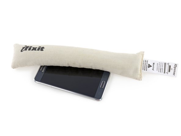

  8. Samsung Galaxy Alpha Teardown: crwdns2935265:08crwdnd2935265:01crwdnd2935265:02crwdne2935265:0 Samsung Galaxy Alpha Teardown: crwdns2935265:08crwdnd2935265:02crwdnd2935265:02crwdne2935265:0
    • After plenty of heat and patience, we've finally softened the front panel adhesive enough to wedge an opening pick into a gap.
    • The pictures make it look easy—but we spent about half an hour heating and prying around the edge of the front panel until we were ready to lift it up without destroying anything.
    • We'd like to take this moment to complain about having to travel through the display assembly to get to the motherboard and other internal components—cameras, vibrator, buttons, and speakers are all on the far side of a repair ordeal if they ever need servicing.

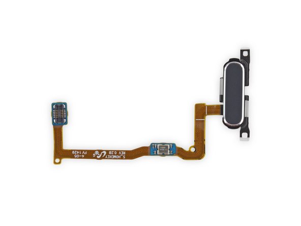

  9. Samsung Galaxy Alpha Teardown: crwdns2935265:09crwdnd2935265:01crwdnd2935265:01crwdne2935265:0
    • Both the Samsung Galaxy S5 and iPhone 5s brought fingerprint scanning to the home button. And both did it fairly crudely, with a flimsy cable in the line of fire when opening the device.
    • The iPhone 6 and 6 Plus saw Apple rerouting this cable into the display assembly, to better protect it.
    • Samsung decided to simply detach the home button from the display assembly, so that its cable now routes down into the interior.
    • This eases the opening procedure a bit, but the capacitative touch button cables are still obnoxiously delicate and require painstaking precision to free.

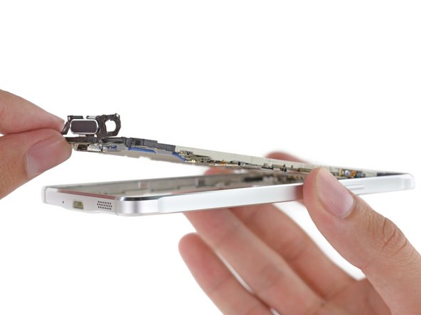

  11. Samsung Galaxy Alpha Teardown: crwdns2935265:011crwdnd2935265:01crwdnd2935265:03crwdne2935265:0 Samsung Galaxy Alpha Teardown: crwdns2935265:011crwdnd2935265:02crwdnd2935265:03crwdne2935265:0 Samsung Galaxy Alpha Teardown: crwdns2935265:011crwdnd2935265:03crwdnd2935265:03crwdne2935265:0
    • Removing the screws from the back earlier did nothing—but now that they're out, we're free to pop open the midframe sandwich and get to the meat of the matter.
    • Releasing a few plastic clips lets us push the inner midframe and motherboard up and out of the outer frame (previously sealed by the display).

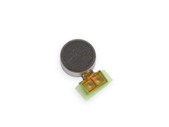

    • The speaker and vibrator stay with the outer midframe, connected to the motherboard by spring contacts.

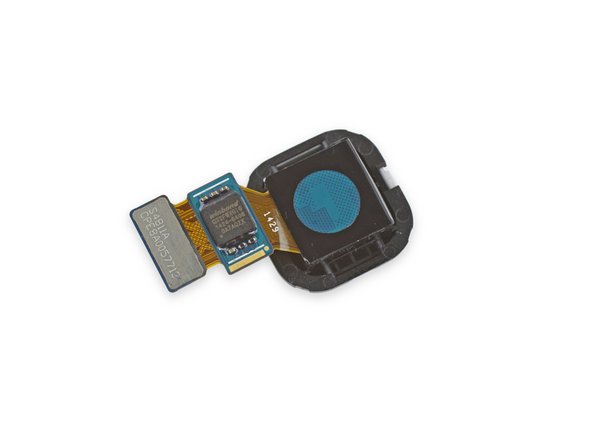

  13. Samsung Galaxy Alpha Teardown: crwdns2935265:013crwdnd2935265:01crwdnd2935265:03crwdne2935265:0 Samsung Galaxy Alpha Teardown: crwdns2935265:013crwdnd2935265:02crwdnd2935265:03crwdne2935265:0 Samsung Galaxy Alpha Teardown: crwdns2935265:013crwdnd2935265:03crwdnd2935265:03crwdne2935265:0
    • The Galaxy Alpha is loaded with a hefty 12 MP rear-facing camera. Judging purely by sensor size, that's a step down from the Galaxy S5's 16 MP monster.
    • From the buzz on the nets, we gather that this camera is comparable to the S5's in quality if not quantity of pixels—and that both fall a little short of the iPhone 6's 8 MP camera, which has better low-light performance and color accuracy.

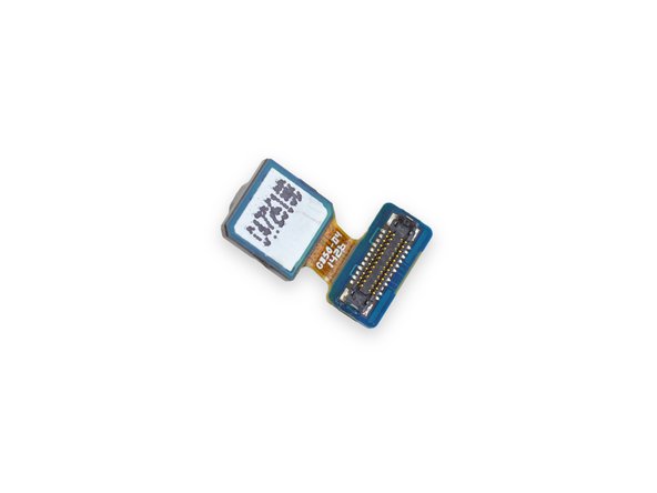

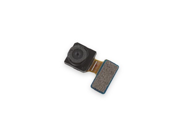

  14. Samsung Galaxy Alpha Teardown: crwdns2935265:014crwdnd2935265:01crwdnd2935265:03crwdne2935265:0 Samsung Galaxy Alpha Teardown: crwdns2935265:014crwdnd2935265:02crwdnd2935265:03crwdne2935265:0 Samsung Galaxy Alpha Teardown: crwdns2935265:014crwdnd2935265:03crwdnd2935265:03crwdne2935265:0
    • The lonely 2.1 MP selfie cam comes off the motherboard without issue.
    • Unlike the iPhone's now-standard mini cluster-mess of a front-facing camera cable.

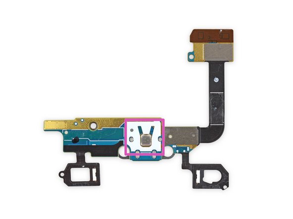

  17. Samsung Galaxy Alpha Teardown: crwdns2935265:017crwdnd2935265:01crwdnd2935265:03crwdne2935265:0 Samsung Galaxy Alpha Teardown: crwdns2935265:017crwdnd2935265:02crwdnd2935265:03crwdne2935265:0 Samsung Galaxy Alpha Teardown: crwdns2935265:017crwdnd2935265:03crwdnd2935265:03crwdne2935265:0
    • Time to clean up and remove the last few pieces of the Alpha puzzle.
    • This daughterboard, located at the bottom of the device, is home to several components:
    • Micro USB 2.0 port
    • Capacitative touch soft buttons
    • Microphone
    • Antenna spring contacts
    • 0055 1407 7899 (we suspect this is another Cypress CapSense capacitive touch-sensing controller, like in the Galaxy S5)
    • Home button switch (on the back)
  18. Samsung Galaxy Alpha Teardown: crwdns2935265:018crwdnd2935265:01crwdnd2935265:02crwdne2935265:0 Samsung Galaxy Alpha Teardown: crwdns2935265:018crwdnd2935265:02crwdnd2935265:02crwdne2935265:0
    • With the daughterboard removed, we can now peel out the home button cable.
    • That's quite a bit of disassembly to replace a common-failure part.

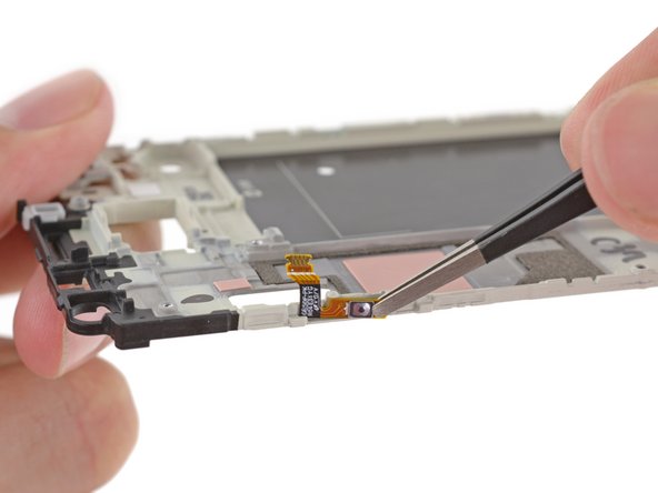

  20. Samsung Galaxy Alpha Teardown: crwdns2935265:020crwdnd2935265:01crwdnd2935265:03crwdne2935265:0 Samsung Galaxy Alpha Teardown: crwdns2935265:020crwdnd2935265:02crwdnd2935265:03crwdne2935265:0 Samsung Galaxy Alpha Teardown: crwdns2935265:020crwdnd2935265:03crwdnd2935265:03crwdne2935265:0
    • The tiny cable parade continues!
    • Tweezers are the tool of choice to peel up these lightly-adhered delicate little guys.
    • An antenna interconnect cable comes up first, and then the power button switch.
    • While the size of these cables puts them at risk of tearing, having so many isn't a bad thing. Separating components out into modular, individually-replaceable components makes repairs easier and cheaper.

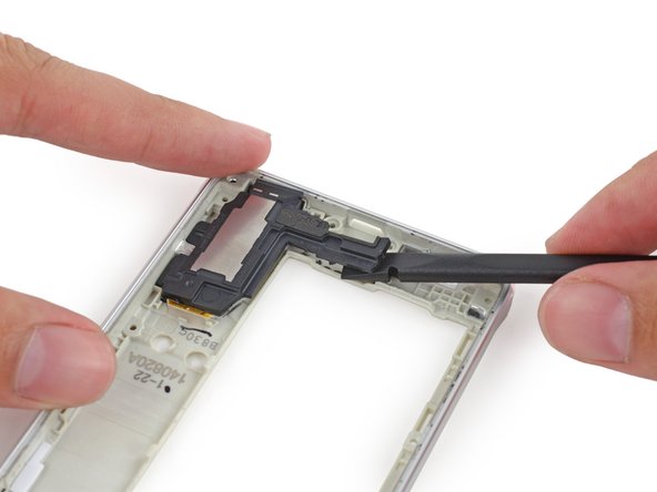

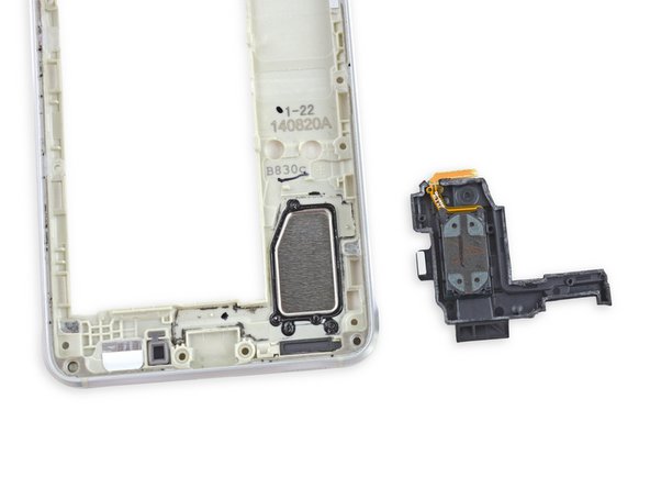

  21. Samsung Galaxy Alpha Teardown: crwdns2935265:021crwdnd2935265:01crwdnd2935265:03crwdne2935265:0 Samsung Galaxy Alpha Teardown: crwdns2935265:021crwdnd2935265:02crwdnd2935265:03crwdne2935265:0 Samsung Galaxy Alpha Teardown: crwdns2935265:021crwdnd2935265:03crwdnd2935265:03crwdne2935265:0
    • With the inner midframe exhausted, we turn to the outer frame in hopes of freeing its speaker and vibrator for your inspection.
    • Probing and prying at the speaker reveals it's adhered in place much more strongly than we expected—essentially using the midframe as half of the speaker box.
    • Once again, the iOpener prevails, softening the tar-like adhesive enough that we can pop the noisemaker up and out.
