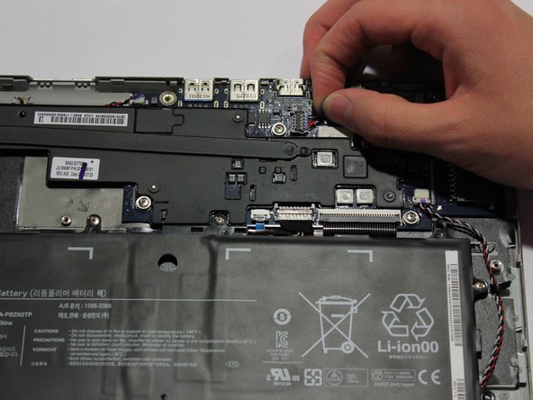

  5. Samsung Chromebook Series 3 Charging Port Replacement, Charging Port: crwdns2935265:05crwdnd2935265:01crwdnd2935265:03crwdne2935265:0 Samsung Chromebook Series 3 Charging Port Replacement, Charging Port: crwdns2935265:05crwdnd2935265:02crwdnd2935265:03crwdne2935265:0 Samsung Chromebook Series 3 Charging Port Replacement, Charging Port: crwdns2935265:05crwdnd2935265:03crwdnd2935265:03crwdne2935265:0
    • Unscrew the 3.4 mm screw holding down the charging port module using a Phillips #00 screwdriver.

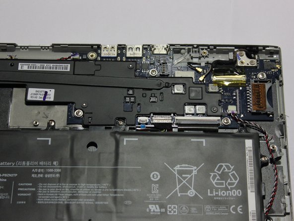

  6. Samsung Chromebook Series 3 Charging Port Replacement: crwdns2935265:06crwdnd2935265:01crwdnd2935265:02crwdne2935265:0 Samsung Chromebook Series 3 Charging Port Replacement: crwdns2935265:06crwdnd2935265:02crwdnd2935265:02crwdne2935265:0
    • Remove the metal cover above the charging port module by pulling up and moving it slightly left.

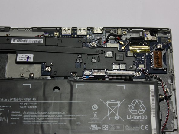

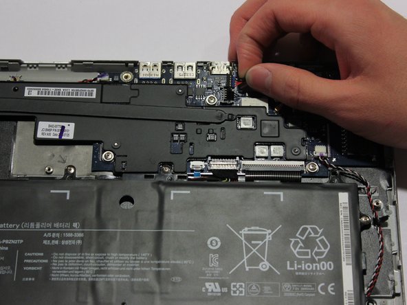

  7. Samsung Chromebook Series 3 Charging Port Replacement: crwdns2935265:07crwdnd2935265:01crwdnd2935265:03crwdne2935265:0 Samsung Chromebook Series 3 Charging Port Replacement: crwdns2935265:07crwdnd2935265:02crwdnd2935265:03crwdne2935265:0 Samsung Chromebook Series 3 Charging Port Replacement: crwdns2935265:07crwdnd2935265:03crwdnd2935265:03crwdne2935265:0
    • Pull out the charging port module connector by pulling directly up on it.
    • When reassembling, reconnect by positioning the connector directly above its original position and pushing down.

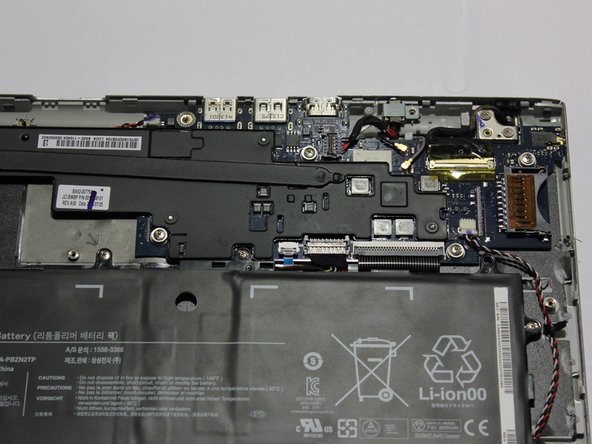

  8. Samsung Chromebook Series 3 Charging Port Replacement: crwdns2935265:08crwdnd2935265:01crwdnd2935265:02crwdne2935265:0 Samsung Chromebook Series 3 Charging Port Replacement: crwdns2935265:08crwdnd2935265:02crwdnd2935265:02crwdne2935265:0
    • You can now pull out the charging port module.
