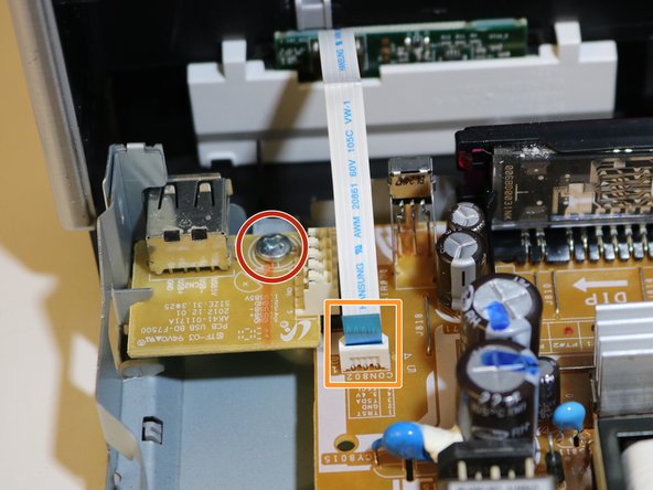

  6. Samsung BD-F7500 Blu-ray Player Mother Board Replacement, DC Power Board: crwdns2935265:06crwdnd2935265:01crwdnd2935265:02crwdne2935265:0 Samsung BD-F7500 Blu-ray Player Mother Board Replacement, DC Power Board: crwdns2935265:06crwdnd2935265:02crwdnd2935265:02crwdne2935265:0
    • Remove the 7 mm screw using a phillips head #J1 screwdriver.
    • To remove the ribbon cable, firmly grip the blue tab attached to the base and pull upwards.
    • The DC Power board needs to be drained of excess charge. This can be done by unplugging the device from the wall and pressing the power button a few times.
  7. Samsung BD-F7500 Blu-ray Player Mother Board Replacement: crwdns2935265:07crwdnd2935265:01crwdnd2935265:01crwdne2935265:0
    • To remove the USB board, grab the board and pull upwards until the plastic casing has been detached from the power board
    • The USB board is lodged against the metal frame. It is helpful to pull up from the white connector and rotate it out.
    • Be careful not to bend any pins, located beneath the white connector, while removing the USB board.

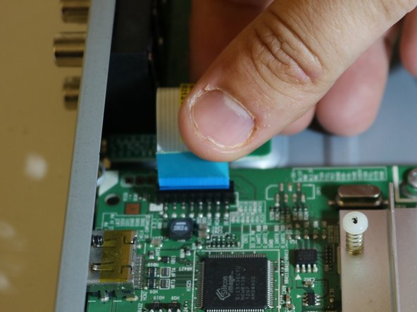

    • To remove the three ribbon cables connected to the mother board, firmly grip the blue tab attached to the base and pull upwards.
    • To remove the small, three wire connector, pinch the tab at the base of the wires and pull upwards.

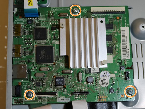

    • Remove two (2) 7 mm, black screws above HDMI outputs located on back of device using a phillips head #PH0 screwdriver.
    • Remove three (3) 7 mm, silver screws using a phillips head #J1 screwdriver.
    • There are screws that do not need to be removed, only remove those indicated in the image.
  11. Samsung BD-F7500 Blu-ray Player Mother Board Replacement: crwdns2935265:011crwdnd2935265:01crwdnd2935265:01crwdne2935265:0
    • To remove the mother board grip the edges of the board and pull upwards.
    • It may be necessary to slide the mother board towards the front of the device to remove the Ethernet port from being lodged into the rear frame.
