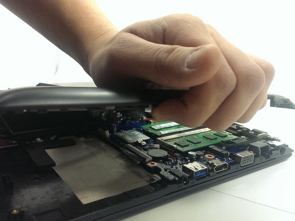

  3. Samsung ATIV Book 4 Mouse Pad Replacement: crwdns2935265:03crwdnd2935265:01crwdnd2935265:02crwdne2935265:0 Samsung ATIV Book 4 Mouse Pad Replacement: crwdns2935265:03crwdnd2935265:02crwdnd2935265:02crwdne2935265:0
    • Using plastic opening tool, pry plastic panel away from computer.
    • Start prying at one point and work your way around the entire computer until panel is free come computer.
    • Remove the panel from computer once all tabs are broke free.

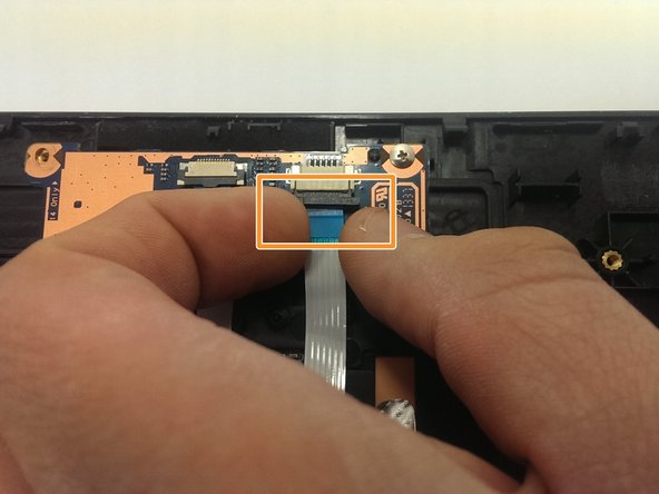

  4. Samsung ATIV Book 4 Mouse Pad Replacement: crwdns2935265:04crwdnd2935265:01crwdnd2935265:02crwdne2935265:0 Samsung ATIV Book 4 Mouse Pad Replacement: crwdns2935265:04crwdnd2935265:02crwdnd2935265:02crwdne2935265:0
    • Pull this tab outwards, as shown, to release the wire harness.
    • With the tab now pulled out, pull lightly on the blue tape, to remove the harness.
    • Pull on the blue tape to remove wire harness.
    • This harness may require a little more force to remove, but will slide right out.
    • Remove the two 3.5mm screws and remove the defective hardware.
    • This step may be easier if the battery is taken out. Follow the battery replacement guide to do so.
