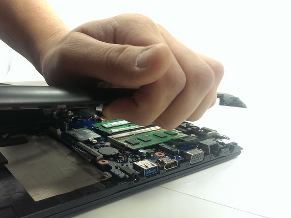

    3. Samsung ATIV Book 4 Battery Replacement: crwdns2935265:03crwdnd2935265:01crwdnd2935265:02crwdne2935265:0 Samsung ATIV Book 4 Battery Replacement: crwdns2935265:03crwdnd2935265:02crwdnd2935265:02crwdne2935265:0
      • Using the plastic opening tool, pry plastic panel away from computer.
      • Start prying at one point and work your way around the entire computer until panel is free come computer.
      • Remove the panel from computer, once all tabs are broken free.
