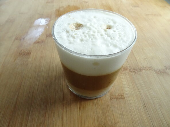

    • This is what the milk foam of the Xelsis or GranAroma should look like. If that's not the case, try the following solutions:
    • The milk itself could be the problem. Try a different kind of milk and chill it before use.
    • Thoroughly clean the milk system by hand. This is relatively easy and you should do it from time to time. Step 2.
    • Check the air supply at the solenoid valve. This is more time-consuming, since you have to open up the machine and loosen the valve block. Step 4.

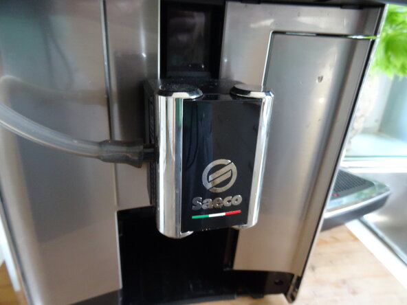

    • Pull off the milk tube.
    • Fold the lid over the coffee spout to the right.
    • The "Cappucinatore" becomes visible. Carefully pull it out from the bottom and remove it.
  3. Saeco Xelsis/GranAroma not frothing? Repair.: crwdns2935265:03crwdnd2935265:01crwdnd2935265:02crwdne2935265:0 Saeco Xelsis/GranAroma not frothing? Repair.: crwdns2935265:03crwdnd2935265:02crwdnd2935265:02crwdne2935265:0
    • The "Cappucinatore" can be easily disassembled into five different parts. All parts have nozzles, that need to be cleaned. Those nozzles are sensitive, so don't use any sharp or pointed tools. Tooth picks are a good choice, but work carefully nonetheless.
    • But first, place the parts in a cleaning solution made from milk system cleaner or dishwasher detergent. Then - carefully - clean the nozzles.
    • Pay particular attention to the inlet nozzle. A good tip is to blow and suck the nozzles with your mouth.
    • Reassemble everything and test. This usually solves the problem already.
