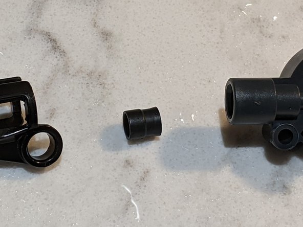

    • There are several o-rings in the brew unit that could be the source of leaks. I replaced all of those and that didn't fix the problem. After figuring out how to observe the brew unit during operation, I found that the leak was coming from the SBS valve.
    • The leak is coming from somewhere in the brew unit, but with the door closed, you can't see it in operation to identify the specific leak location.
    • Use a magnet to bypass the door open detector so you can observe the brew unit in operation. (See video - Saeco Talea Giro brew unit leak diagnosis)
    • I used a bag clip with an attached magnet and clipped it onto the sensor.
    • Run the brew cycle. You can use the coffee bypass cycle because you don't need to waste your good beans for this test. And, it's easier to clean up if it's just water.
    • Look for leaks!
    • On my machine, the SBS valve on the upper left of the brew unit was leaking during the brewing process. This valve admits the pressurized water into the brew unit and includes a one-way check valve to keep the pressure in.

    • Use a T10 torx screwdriver to remove the SBS valve. It might take a little force to pop it off the brew unit once the screws are removed.
    • Remove the top part of the SBS valve (with the 3 "wings") by turning it counter-clockwise. Be care not to loose the spring!
    • Inspect the valve diaphragm. Mine had a split, clearly the source of the coffee leak!
  2. Saeco Talea/Odea Brew Unit SBS Valve Replacement, Replace the SBS Valve: crwdns2935265:03crwdnd2935265:01crwdnd2935265:03crwdne2935265:0 Saeco Talea/Odea Brew Unit SBS Valve Replacement, Replace the SBS Valve: crwdns2935265:03crwdnd2935265:02crwdnd2935265:03crwdne2935265:0 Saeco Talea/Odea Brew Unit SBS Valve Replacement, Replace the SBS Valve: crwdns2935265:03crwdnd2935265:03crwdnd2935265:03crwdne2935265:0
    • The SBS valve diaphragm does not appear to be a part you can buy. So, you'll need to buy the SBS valve assembly. (about $25)
    • The replacement part I purchased arrive in 3 pieces. Insert the rubber tube and snap on the part that connects to the water input.
  3. Saeco Talea/Odea Brew Unit SBS Valve Replacement, Install the SBS valve in the brew unit: crwdns2935265:04crwdnd2935265:01crwdnd2935265:02crwdne2935265:0 Saeco Talea/Odea Brew Unit SBS Valve Replacement, Install the SBS valve in the brew unit: crwdns2935265:04crwdnd2935265:02crwdnd2935265:02crwdne2935265:0
    • Place the SBS valve into the brew unit, aligning the screw holes.
    • Replace the screws with the T10 torx screwdriver.
    • Make some espresso and see if your leak is gone!

Good guide. However, I'm pretty sure the SBS valve does not let pressurized water in, but the coffee out., while keeping the unit pressurized.
