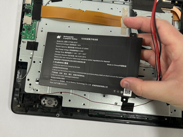

    • Gently remove the tape holding the battery's cord to the motherboard, followed by the tape in the middle of the cord.
    • If your battery is swollen, halt this guide and follow the swollen battery disposal guide.
  4. SGIN X15S Battery Replacement: crwdns2935265:04crwdnd2935265:01crwdnd2935265:03crwdne2935265:0 SGIN X15S Battery Replacement: crwdns2935265:04crwdnd2935265:02crwdnd2935265:03crwdne2935265:0 SGIN X15S Battery Replacement: crwdns2935265:04crwdnd2935265:03crwdnd2935265:03crwdne2935265:0

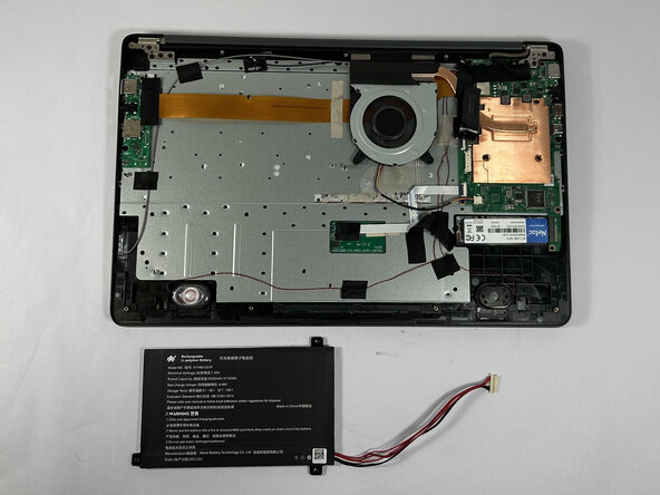

    • Use the nylon spudger to detach the battery from the motherboard.
  5. SGIN X15S Battery Replacement, Battery: crwdns2935265:05crwdnd2935265:01crwdnd2935265:03crwdne2935265:0 SGIN X15S Battery Replacement, Battery: crwdns2935265:05crwdnd2935265:02crwdnd2935265:03crwdne2935265:0 SGIN X15S Battery Replacement, Battery: crwdns2935265:05crwdnd2935265:03crwdnd2935265:03crwdne2935265:0
    • Using the Phillips #0 screwdriver, remove the three 4.4 mm screws attached to the battery.
    • Remove the battery.
