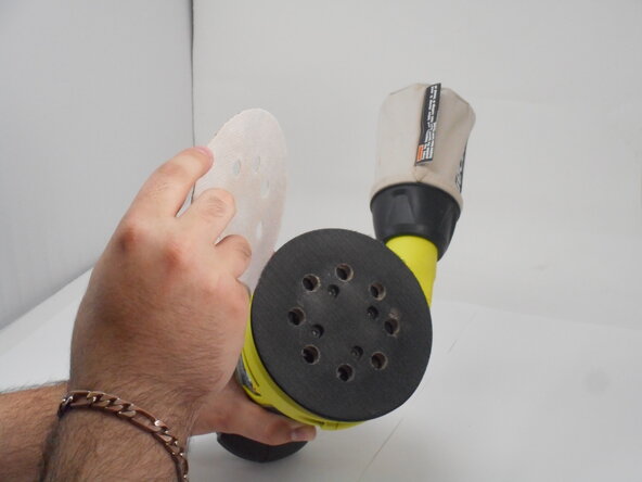

  1. Ryobi P411 Motor Replacement, Pad Assembly: crwdns2935265:01crwdnd2935265:01crwdnd2935265:03crwdne2935265:0 Ryobi P411 Motor Replacement, Pad Assembly: crwdns2935265:01crwdnd2935265:02crwdnd2935265:03crwdne2935265:0 Ryobi P411 Motor Replacement, Pad Assembly: crwdns2935265:01crwdnd2935265:03crwdnd2935265:03crwdne2935265:0

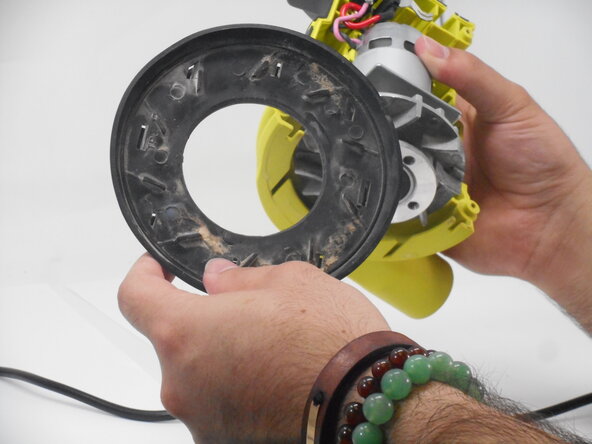

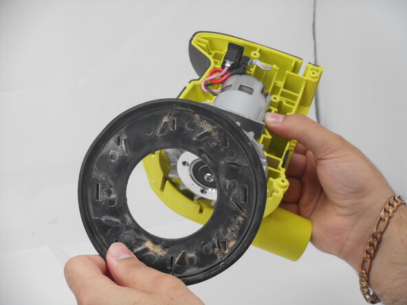

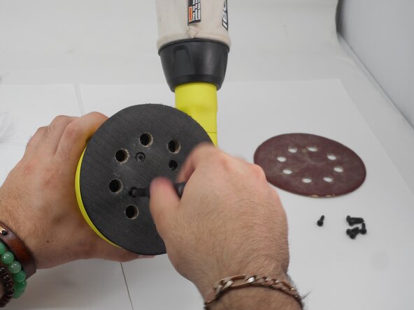

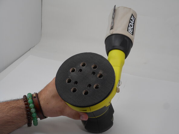

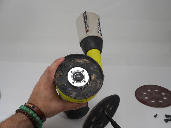

    • Remove the sanding pad to expose the screws at the bottom of the sander.
  2. Ryobi P411 Motor Replacement: crwdns2935265:02crwdnd2935265:01crwdnd2935265:03crwdne2935265:0 Ryobi P411 Motor Replacement: crwdns2935265:02crwdnd2935265:02crwdnd2935265:03crwdne2935265:0 Ryobi P411 Motor Replacement: crwdns2935265:02crwdnd2935265:03crwdnd2935265:03crwdne2935265:0
    • Remove the four M5 x 8.9mm screws with a T6 Torx screwdriver.
    • Remove the pad assembly.

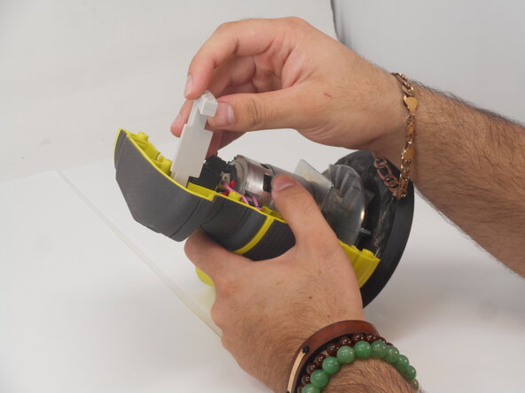

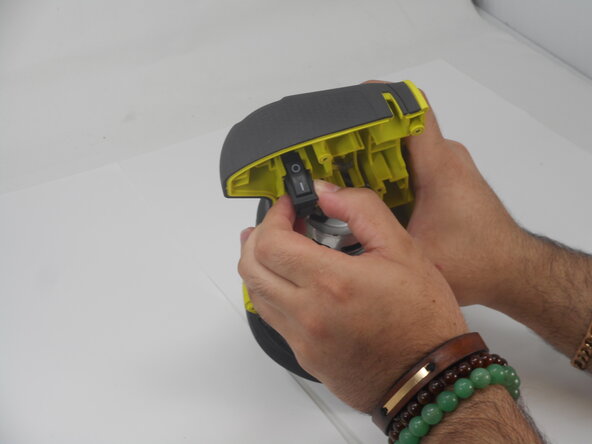

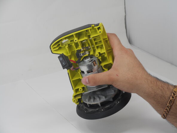

  3. Ryobi P411 Motor Replacement, Switch Trigger: crwdns2935265:03crwdnd2935265:01crwdnd2935265:03crwdne2935265:0 Ryobi P411 Motor Replacement, Switch Trigger: crwdns2935265:03crwdnd2935265:02crwdnd2935265:03crwdne2935265:0 Ryobi P411 Motor Replacement, Switch Trigger: crwdns2935265:03crwdnd2935265:03crwdnd2935265:03crwdne2935265:0
    • Push the switch trigger gently from the back to pull it out from the open face of the sander.

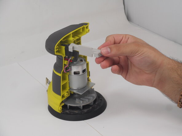

  4. Ryobi P411 Motor Replacement, Switch: crwdns2935265:04crwdnd2935265:01crwdnd2935265:03crwdne2935265:0 Ryobi P411 Motor Replacement, Switch: crwdns2935265:04crwdnd2935265:02crwdnd2935265:03crwdne2935265:0 Ryobi P411 Motor Replacement, Switch: crwdns2935265:04crwdnd2935265:03crwdnd2935265:03crwdne2935265:0
    • Remove the switch from its housing.
    • Take care not to strain the connected cables.

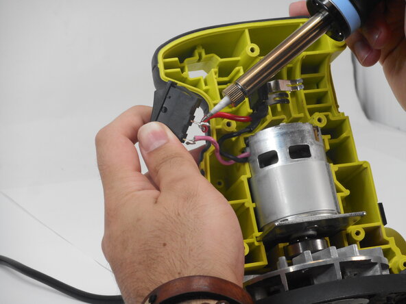

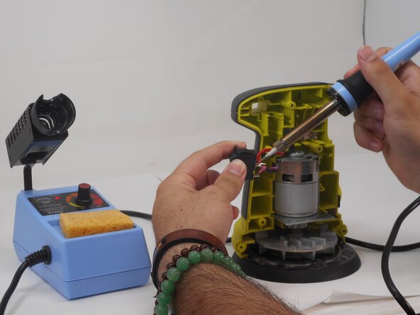

  5. Ryobi P411 Motor Replacement: crwdns2935265:05crwdnd2935265:01crwdnd2935265:03crwdne2935265:0 Ryobi P411 Motor Replacement: crwdns2935265:05crwdnd2935265:02crwdnd2935265:03crwdne2935265:0 Ryobi P411 Motor Replacement: crwdns2935265:05crwdnd2935265:03crwdnd2935265:03crwdne2935265:0
    • Use a soldering iron to desolder the two switch connections.
    • If you're unfamiliar with soldering, review this guide.

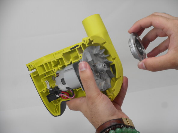

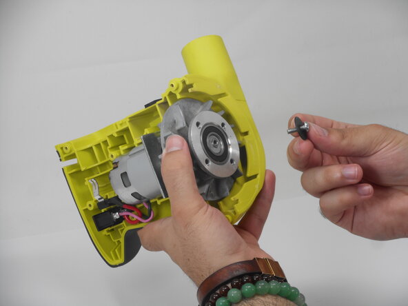

  6. Ryobi P411 Motor Replacement, Fan and Bearing Cap: crwdns2935265:06crwdnd2935265:01crwdnd2935265:03crwdne2935265:0 Ryobi P411 Motor Replacement, Fan and Bearing Cap: crwdns2935265:06crwdnd2935265:02crwdnd2935265:03crwdne2935265:0 Ryobi P411 Motor Replacement, Fan and Bearing Cap: crwdns2935265:06crwdnd2935265:03crwdnd2935265:03crwdne2935265:0
    • Remove the rubber brake from the bottom of the sander.

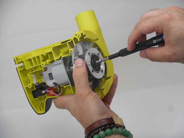

  7. Ryobi P411 Motor Replacement: crwdns2935265:07crwdnd2935265:01crwdnd2935265:03crwdne2935265:0 Ryobi P411 Motor Replacement: crwdns2935265:07crwdnd2935265:02crwdnd2935265:03crwdne2935265:0 Ryobi P411 Motor Replacement: crwdns2935265:07crwdnd2935265:03crwdnd2935265:03crwdne2935265:0
    • Use a T20 Torx screwdriver to loosen the 15.8 mm screw at the bottom of the sander.
    • Remove the screw and washer.

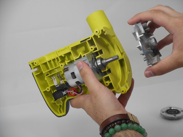

  8. Ryobi P411 Motor Replacement: crwdns2935265:08crwdnd2935265:01crwdnd2935265:03crwdne2935265:0 Ryobi P411 Motor Replacement: crwdns2935265:08crwdnd2935265:02crwdnd2935265:03crwdne2935265:0 Ryobi P411 Motor Replacement: crwdns2935265:08crwdnd2935265:03crwdnd2935265:03crwdne2935265:0
    • Remove the fan and bearing cap.

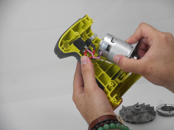

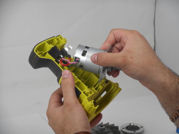

  9. Ryobi P411 Motor Replacement, Motor: crwdns2935265:09crwdnd2935265:01crwdnd2935265:03crwdne2935265:0 Ryobi P411 Motor Replacement, Motor: crwdns2935265:09crwdnd2935265:02crwdnd2935265:03crwdne2935265:0 Ryobi P411 Motor Replacement, Motor: crwdns2935265:09crwdnd2935265:03crwdnd2935265:03crwdne2935265:0
    • Desolder the motor connections from the switch and power supply.
    • Remove the motor from its housing.
