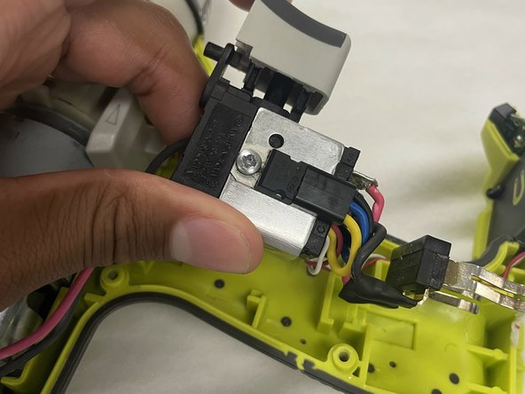

  4. Ryobi Compact 18 Volt Hammer Drill P214 Trigger Replacement, Trigger: crwdns2935265:04crwdnd2935265:01crwdnd2935265:03crwdne2935265:0 Ryobi Compact 18 Volt Hammer Drill P214 Trigger Replacement, Trigger: crwdns2935265:04crwdnd2935265:02crwdnd2935265:03crwdne2935265:0 Ryobi Compact 18 Volt Hammer Drill P214 Trigger Replacement, Trigger: crwdns2935265:04crwdnd2935265:03crwdnd2935265:03crwdne2935265:0
    • Gently lift the battery clip to gain access to the trigger.
    • You can now clean any debris blocking the trigger.
