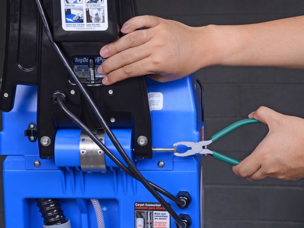

      • Before you begin disassembly, make sure that the Rug Doctor is not plugged in and that all reservoirs are empty of liquids.
      • Unclip the clear hose from the back of the Rug Doctor.
    2. Rug Doctor Spray Button Replacement: crwdns2935265:02crwdnd2935265:01crwdnd2935265:02crwdne2935265:0 Rug Doctor Spray Button Replacement: crwdns2935265:02crwdnd2935265:02crwdnd2935265:02crwdne2935265:0
      • Use a 7/16" (11 mm OK) wrench to hold the handle axle while you use a 7/16" socket to remove the cap nut securing the axle end.
    3. Rug Doctor Spray Button Replacement: crwdns2935265:03crwdnd2935265:01crwdnd2935265:02crwdne2935265:0 Rug Doctor Spray Button Replacement: crwdns2935265:03crwdnd2935265:02crwdnd2935265:02crwdne2935265:0

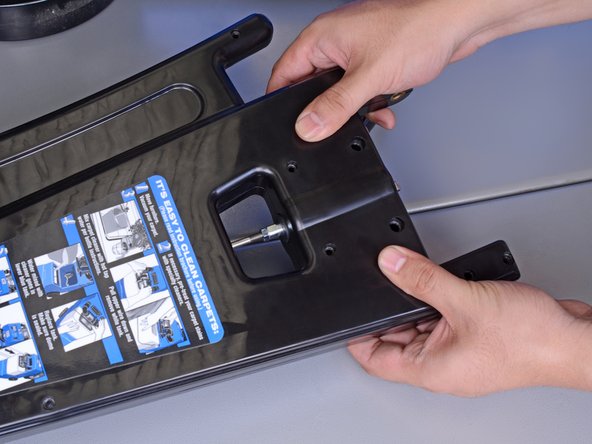

      • Support the handle with one hand. It will be loose after this step.
      • Use fingers or pliers to pull out the handle axle.
      • If the axle feels hard to pull out, squeeze the handle release lever to release pressure on the axle.
    4. Rug Doctor Spray Button Replacement: crwdns2935265:04crwdnd2935265:01crwdnd2935265:01crwdne2935265:0
      • Detach the handle from the Rug Doctor and set it down.

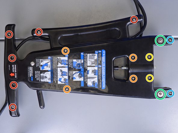

      • Uncoil the power cable from the handle.
      • Remove the sixteen Phillips fasteners of the following lengths:
      • Six 22.7 mm machine screws
      • Four 35.3 mm machine screws
      • Two 25.2 mm (thicker) machine screws
      • Two 48.4 mm bolts with washers
      • When reinstalling these, the order should be: bolt, washer, handle, washer, 3/8" nut.
      • Two 30.1 mm screws

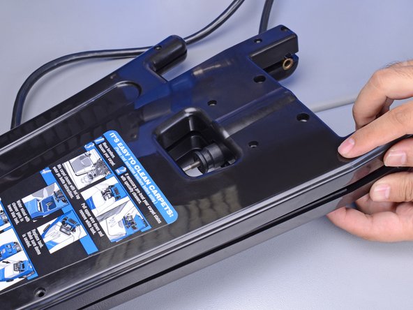

      • Separate the bottom edge of the handle slightly until the spring-loaded plunger pops out of its socket.
    3. Rug Doctor Spray Button Replacement: crwdns2935265:07crwdnd2935265:01crwdnd2935265:03crwdne2935265:0 Rug Doctor Spray Button Replacement: crwdns2935265:07crwdnd2935265:02crwdnd2935265:03crwdne2935265:0 Rug Doctor Spray Button Replacement: crwdns2935265:07crwdnd2935265:03crwdnd2935265:03crwdne2935265:0
      • Re-assembly tip—Follow this step to re-seat the plunger.
      • Use your fingers to push the black plunger down towards the bottom of the handle into position. This may take significant force.
      • Once the plunger slips into position, squeeze the the two handle halves together.
      • If done correctly, the handle should close tightly without a gap and lock the plunger in place.
      • If that doesn't happen, check to see if the plunger is properly positioned, and that no wires are pinched.
      • Continue squeezing the two handle halves together while you reinstall the handle's lower screws.

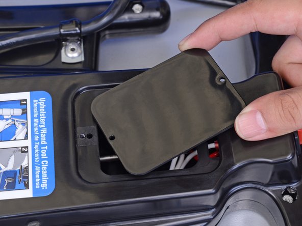

      • Remove the two 11.4 mm long Phillips screws holding the cover plate on the handle.
      • Remove the cover plate.

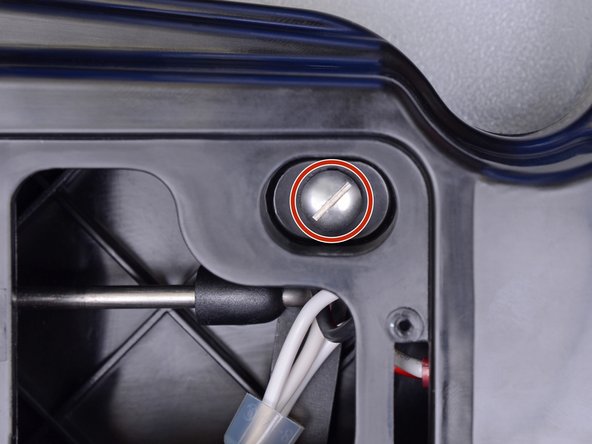

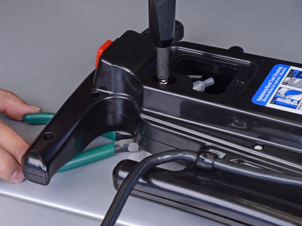

      • Use a pair of pliers to grasp the lip of the screw post close to the handle release lever.
      • While gripping the screw post, use a large flathead screwdriver to remove the machine screw mated to the other end of the screw post.

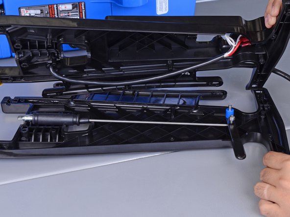

      • Pull the two handle halves apart.

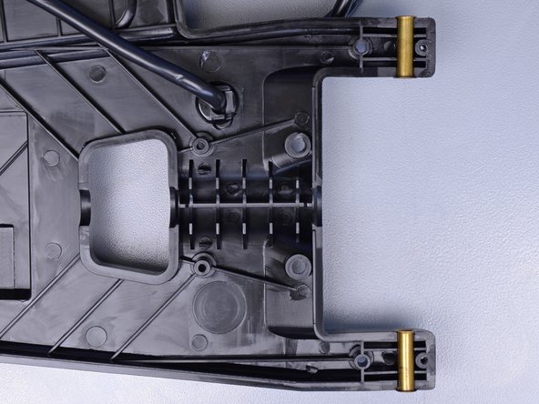

      • Re-assembly tip—Before you close the handle, check the following:
      • The lever mechanism components are properly stacked and oriented as shown.
      • Both brass bushings are in their sockets.

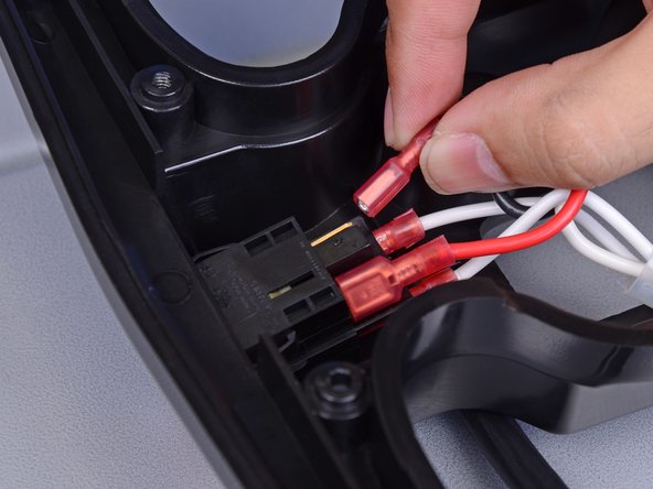

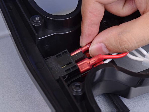

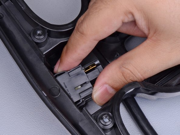

      • Note how the switch is wired:
      • Red and black wires on the top sockets (order does not matter)
      • Two white wires on the bottom sockets
      • Use fingers or pliers to wiggle and pull the four connectors from the switch module.
    9. Rug Doctor Spray Button Replacement: crwdns2935265:013crwdnd2935265:01crwdnd2935265:03crwdne2935265:0 Rug Doctor Spray Button Replacement: crwdns2935265:013crwdnd2935265:02crwdnd2935265:03crwdne2935265:0 Rug Doctor Spray Button Replacement: crwdns2935265:013crwdnd2935265:03crwdnd2935265:03crwdne2935265:0

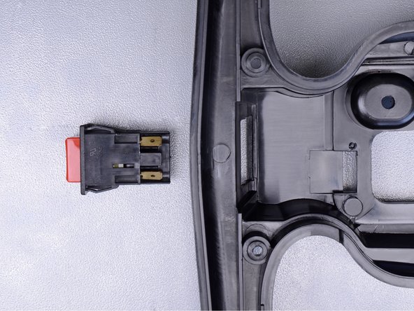

      • Use fingers or wide pliers to squeeze the black retainer tabs on each side of the button module.
      • While squeezing, wiggle and push the button module out of the front of the handle.
      • Remove the button module.
      • To install a replacement button, push the button in through the top of the handle until it clicks in place. It should not be loose or easily budged.
