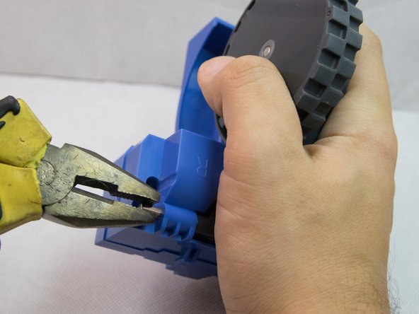

  5. Roomba 650 wheel module Disassembly, Suspension: crwdns2935265:05crwdnd2935265:01crwdnd2935265:02crwdne2935265:0 Roomba 650 wheel module Disassembly, Suspension: crwdns2935265:05crwdnd2935265:02crwdnd2935265:02crwdne2935265:0
    • Push the pin that acts as the pivot point for the suspension. I got away with just pushing with a screwdriver
    • Use pliers to pull from the other end to remove the pin completely
    • Unscrew all the remaining bolts

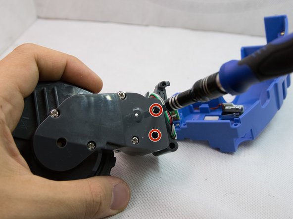

  6. Roomba 650 wheel module Disassembly, Take the gear housing apart: crwdns2935265:06crwdnd2935265:01crwdnd2935265:03crwdne2935265:0 Roomba 650 wheel module Disassembly, Take the gear housing apart: crwdns2935265:06crwdnd2935265:02crwdnd2935265:03crwdne2935265:0 Roomba 650 wheel module Disassembly, Take the gear housing apart: crwdns2935265:06crwdnd2935265:03crwdnd2935265:03crwdne2935265:0
    • Unscrew the housing bolts
    • Unscrew the two bolts that keep the motor in place
    • Remove the plastic stopper that keeps the motor wires in place
    • You should be able to take the motor out now
